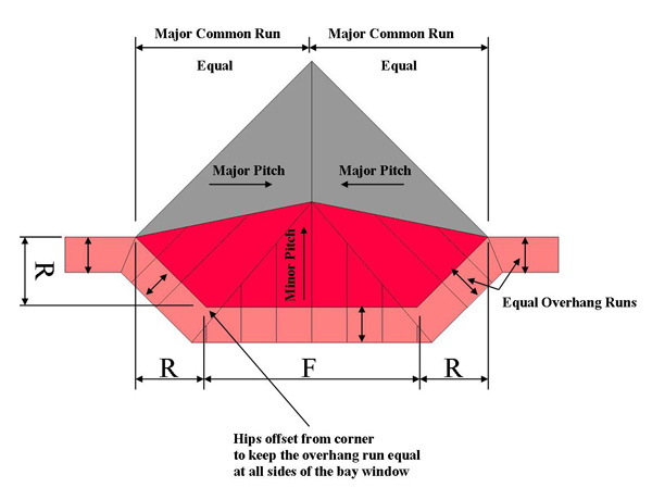

ebdesign Posted December 2, 2014 Share Posted December 2, 2014 Mr McCrump. Here's my lame attempt at a video explaining how to do those bay roofs. Link to comment Share on other sites More sharing options...
dshall Posted December 2, 2014 Share Posted December 2, 2014 I agree with Jim.... except...... and I am not sure what actually happens out in the field, and the difference is so small..... and Jim's method might be what they do in the field.... however I do it just a little differently...... first I build manually.... not a big deal..... but here is the difference..... Jim matched elevation heights of the fascias and I match heights at the plate line. Jim matched elevation heights of the fascias whilst maintaining the exact same overhang, however, technically, the plate heights on the angled walls are technically about 3/4" higher than the standard plate height...... not noticeable...... I maintain the same plate height at angled walls but because I do..... my eaves are actually an inch or two longer at angled walls. My hips meet exactly at the angle where the two walls meet, Jim's do not. I am splitting hairs, I only bring this up so you understand there are two approaches with two results that are almost imperceptible. I do not know what method they use in the field. I think both work...... I should ask a framer what he would do...... I bet they don't even realize the two approaches.... they probably use whatever they have been using since day one. Jim, you understand the difference, have you ever actually asked a framer what he does? Link to comment Share on other sites More sharing options...
mcrump Posted December 2, 2014 Author Share Posted December 2, 2014 Thanks Jim & Scott. I felt it easier to just come out with a 2' long wall that is 90 degrees to the rear wall before turning the angle instead of coming off the rear wall at 45 degrees.. That way I can maintain the same roof pitch and plate heights. I do appreciate seeing an alternate method to my madness. Link to comment Share on other sites More sharing options...

johnny Posted December 3, 2014 Share Posted December 3, 2014 Yes, there are different ways to physically design the roof over a bay - I really benefited from Jims video - but I am again left with the fact I am sure these sorts of methods exist for many things in CA....and realizing I dont know many. Here is the construction method for Jim's: Here is another way: Link to comment Share on other sites More sharing options...
dshall Posted December 3, 2014 Share Posted December 3, 2014 Well Johnny, you succeded in demonstrating 2 additional methods, neither one is my method nor Jim's method. Link to comment Share on other sites More sharing options...
