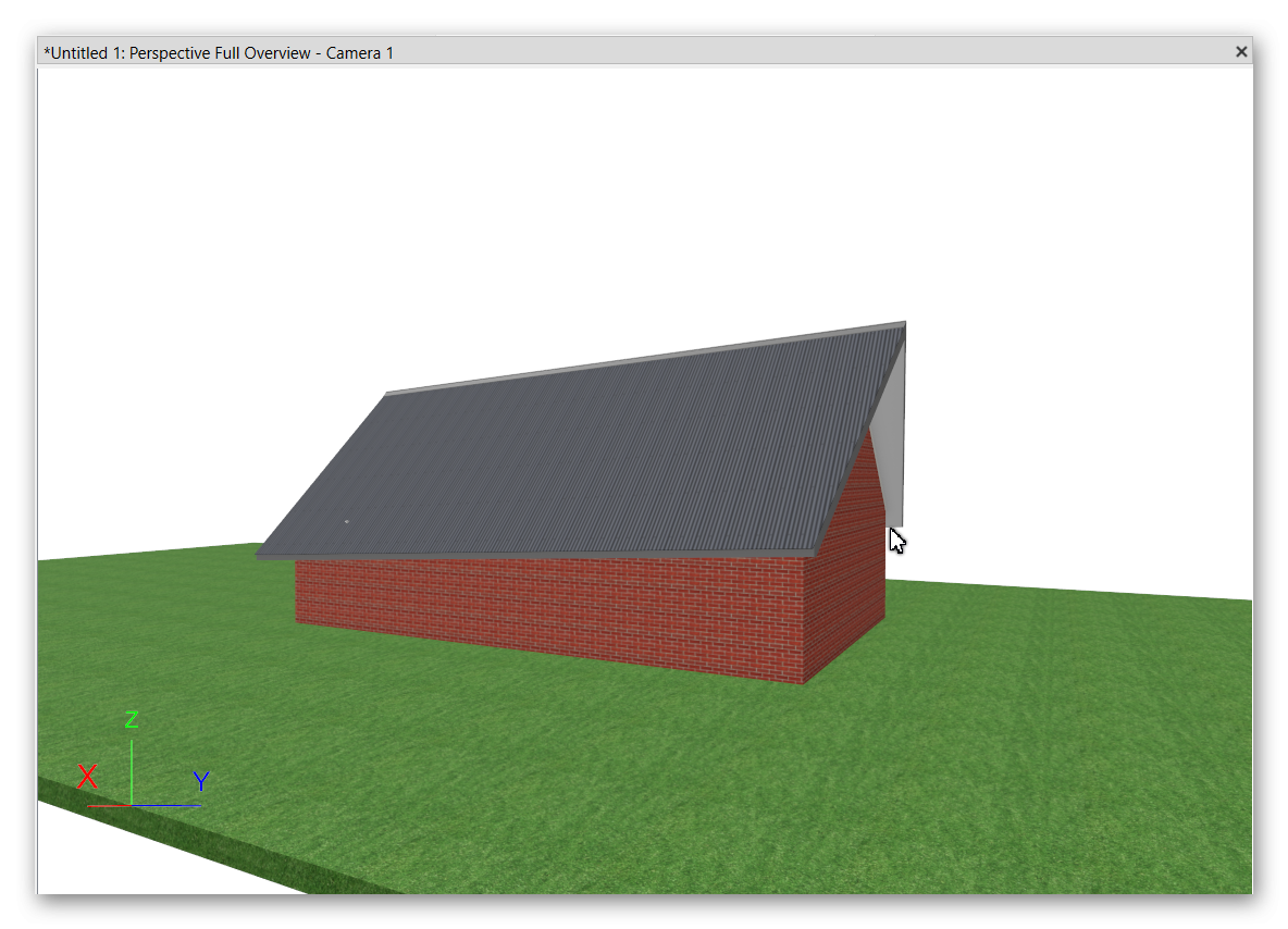

With the gable gaps your roof planes are not against the cladding
Adjust your ceiling height to match you roof planes, try 8' for your deck room rough ceiling.

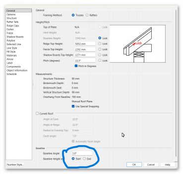

You have selected no ceiling over gym and the 2 living areas, as the wall surface are extended to under side of rafters and you probably need to adjust the heel height roof dialog its set to 8" maybe try 6 or what it should be to suit your local conditions

I would send this into support as you getting problems with this file one they might be able to spot the problem and it might just by tied to a bug in x18
If I delete the curve part of the roof the problems goes away, as a fix could the curved portion be done with a molding polyline you would be missing ridge capping so may not be suitable, hopefully others will have a better solution

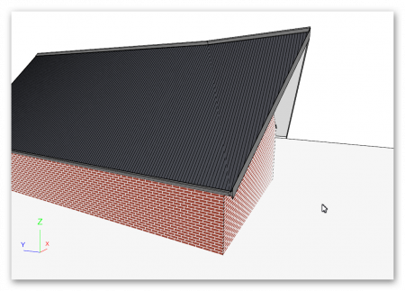

Roof cuts wall
in General Q & A
Posted
Share your plan
