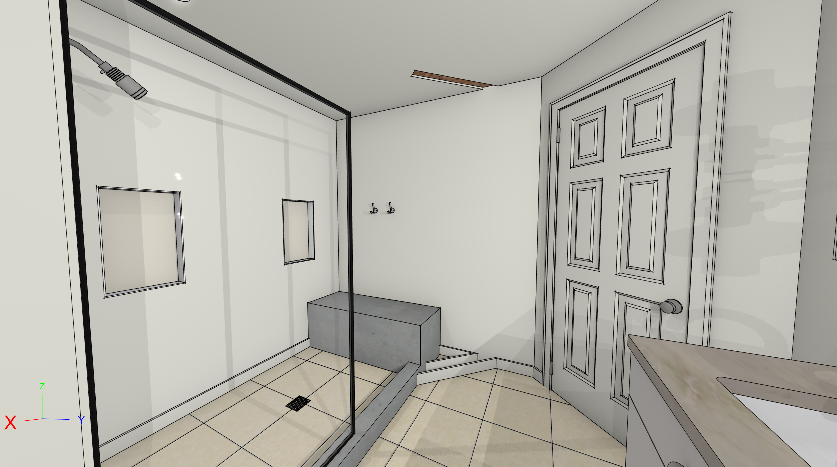

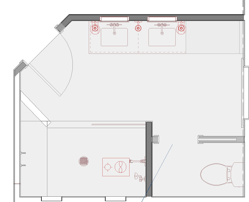

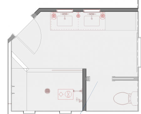

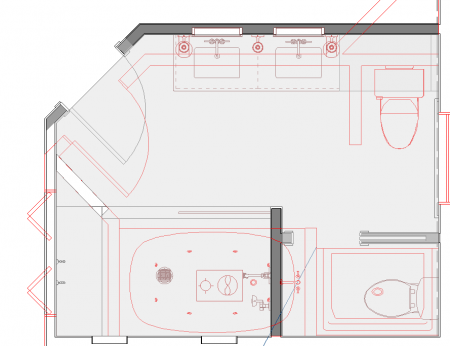

CopperSky Posted September 16 Share Posted September 16 Hi! I'm having an issue I've never had before -- I deleted a wall that was originally connected to a linen closet and it is still showing cut out of the plan. I have tried "rebuild walls, floors, and ceilings" and it did not work. I'm not sure how to fix it, please help! Again for reference, I am using Chief Architect x18 Angled wall shown (unselected) with room selected): As-built reference plan showing original footprint with linen closet: Orthographic view showing wall cut out in ceiling and floor: Thank you! Katherine Pierce Link to comment Share on other sites More sharing options...

Solution BenPalmer Posted September 16 Solution Share Posted September 16 The wall is still there on the 'Walls, Demo' layer. Turn that layer on and delete the wall. 1 Link to comment Share on other sites More sharing options...
CopperSky Posted September 16 Author Share Posted September 16 29 minutes ago, BenPalmer said: The wall is still there on the 'Walls, Demo' layer. Turn that layer on and delete the wall. THANK YOU!!!!! Link to comment Share on other sites More sharing options...
