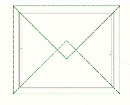

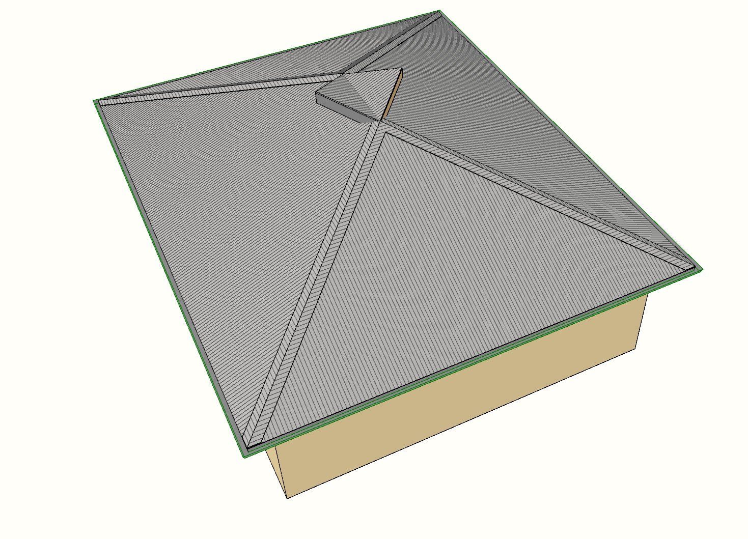

LessJosh Posted September 12 Share Posted September 12 Hi there, Long time chief user but Im using an older version X8. After years of being able to join roof planes in 2D, all of a sudden roof planes aren't joining with the 'Join roof planes' tool ?? Can anyone help ? I have attached a sample plan. ROOF PLANES WONT JOIN IN 2D.plan Link to comment Share on other sites More sharing options...

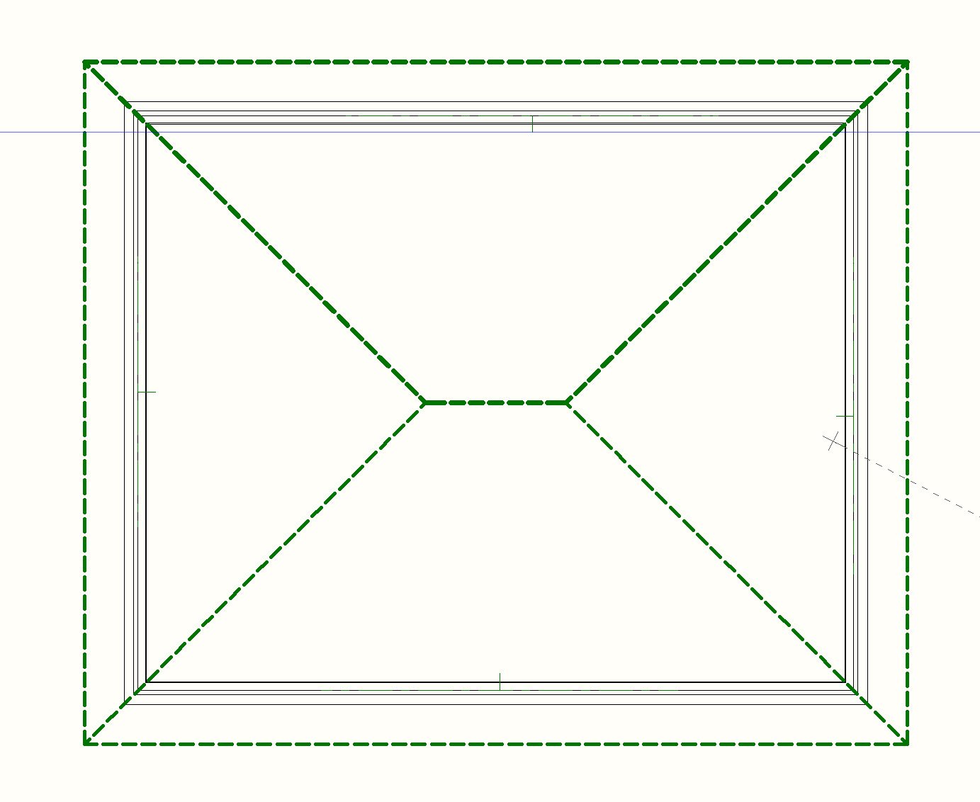

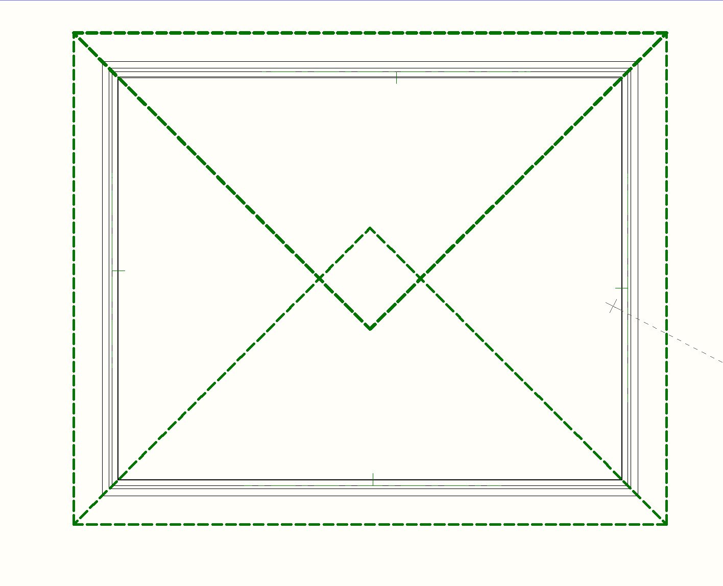

CharlesVolz Posted September 12 Share Posted September 12 Add a break so the two roof planes over the longer walls can make a ridge. Your plan before adding breaks: After I added breaks and joined opposite planes to make the ridge: Temp 5.mp4 I hope this helps. Best, Charles 1 Link to comment Share on other sites More sharing options...
