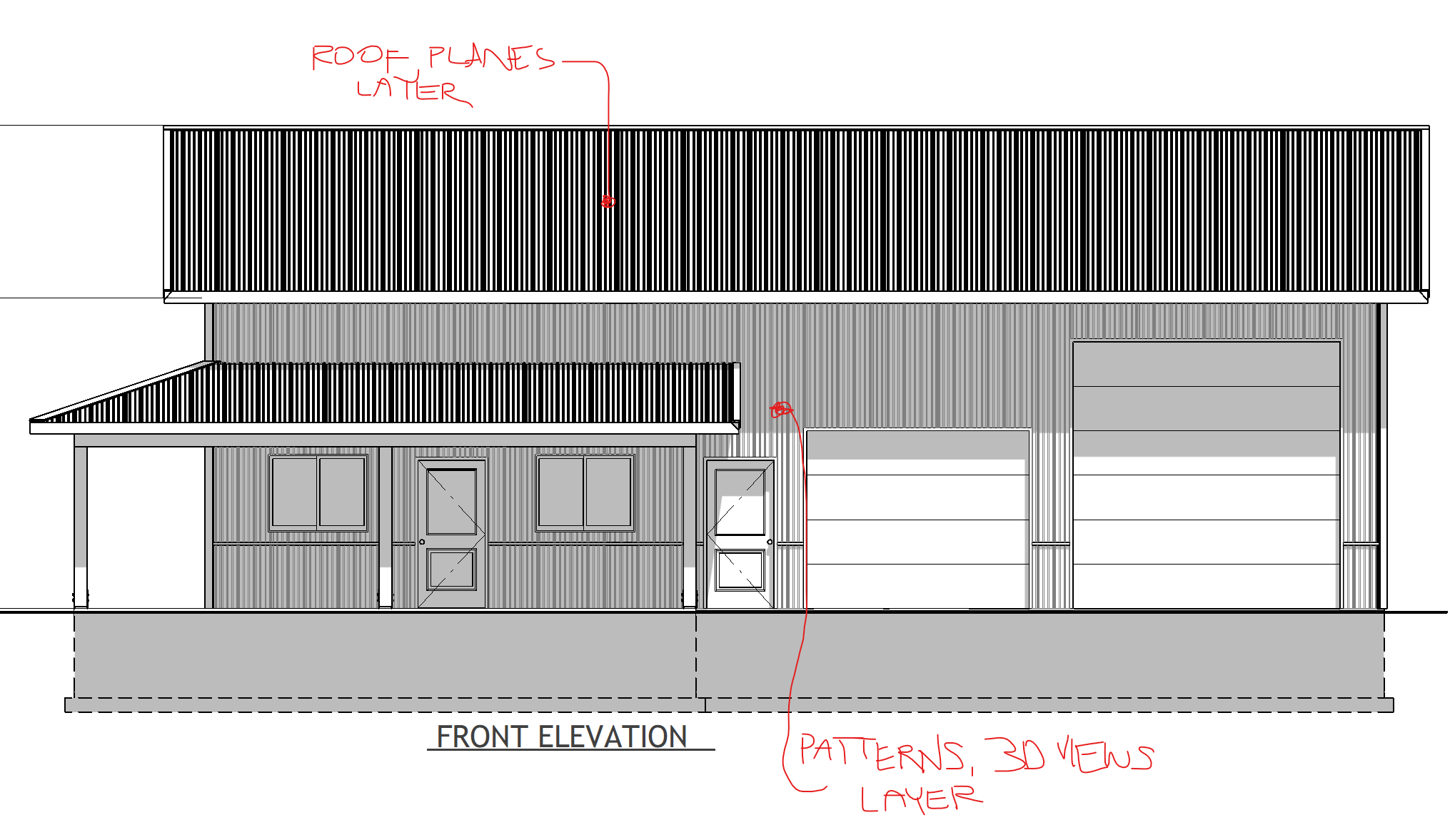

JonathanK Posted September 8 Share Posted September 8 Do I have a setting mixed up? When I send elevations to layout, and it's something with 3D cladding on it, the wall patterns are handled through the Patterns, 3D Views layer settings. The roof cladding, though, is handled through Roof Planes layer. Is there a way to change this? I want my patterns to be a lighter, thinner weight, and it appears that the walls are working correctly, but the roof is not. Has anyone worked around this? On a side note, I love the look of 3D cladding in 3D view, but the patterns are garbage. Way too busy...I wish there was a way to clean this up. Link to comment Share on other sites More sharing options...
robdyck Posted September 8 Share Posted September 8 For walls, you can place the cladding on its own layer so that you have the line control you want (wall specification dialog). This is NOT available for roof planes. Link to comment Share on other sites More sharing options...
JonathanK Posted September 8 Author Share Posted September 8 (edited) *sigh*...ohhh Chief Architect. Why do you continue to have good ideas, but such poor execution. Edited September 8 by JonathanK 1 Link to comment Share on other sites More sharing options...
