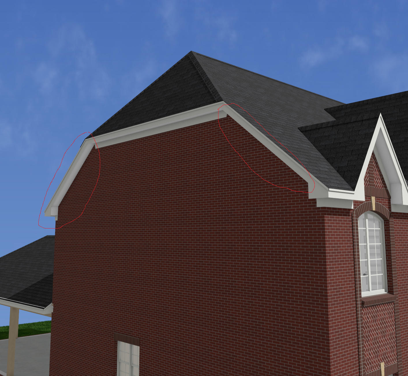

PitMan71 Posted 22 hours ago Share Posted 22 hours ago Anyone know why the frieze wont generate on this roof sections? Also, side question, is there a simple way to do a roof like this with auto generate roofs on? Thanks 260031-XX - Dog Ear Roof.zip Link to comment Share on other sites More sharing options...
ValleyGuy Posted 21 hours ago Share Posted 21 hours ago Are there little sections of attic walls under the slope? They might need to have the frieze board turned on. I normally build all my roofs manually, sorry no help on your side quest. 1 Link to comment Share on other sites More sharing options...

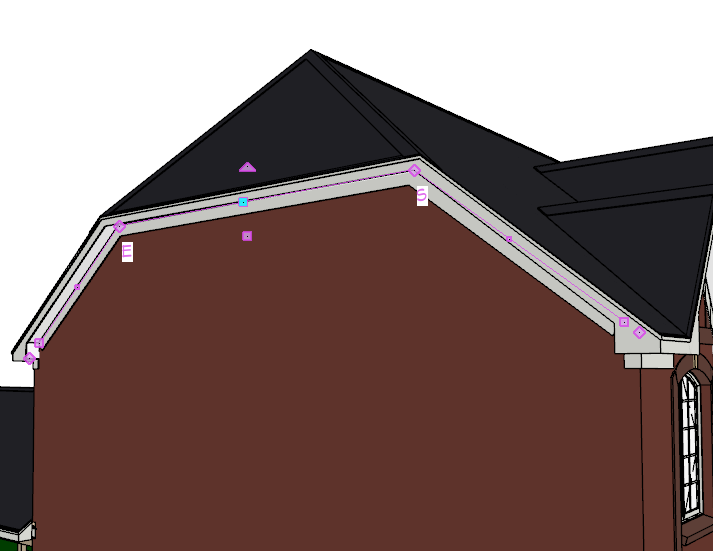

Chrisb222 Posted 6 hours ago Share Posted 6 hours ago 15 hours ago, PitMan71 said: Anyone know why the frieze wont generate on this roof sections? Hi Shane. Yeah I've seen that a lot on auto generated roof trim. Not sure why it happens, but something I do that often works is just selecting the errant trim, grabbing one of the end handles and moving it slightly then letting go. In your case, doing this forced both sides to generate. Selecting that trim edge is tricky sometimes but look for it on the Roofs, Trim layer. Might have to do that more than once as you work on the model. It's a Chief Thang!™ 1 Link to comment Share on other sites More sharing options...
