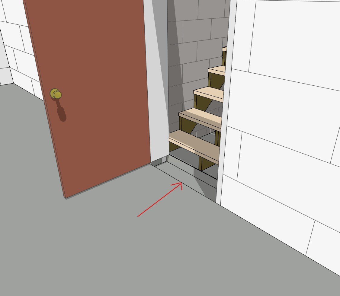

Larry_Sweeney Posted Monday at 05:52 PM Share Posted Monday at 05:52 PM I have two rooms in the basement with both labeled the same. The floor elevations and materials are the same, but where the door is going into the other room there is no floor material (attached picture). Ceiling elevations are different. the room where the steps are is the cellarway to the outside with a bulkhead at the top. Is there a simple "cure" to fixing this issue. I "think" I've checked everything I know that might cause this. Help is always appreciated. Link to comment Share on other sites More sharing options...
DBCooper Posted Monday at 07:31 PM Share Posted Monday at 07:31 PM I have seen that before with two rooms that were both marked as garages that had a wall with a door between them. I can't remember what the workaround I used was. Might want to try changing one room to a different type but if that doesn't work you could always just fill the hole with a poly solid. I can't make this happen in X18 so it looks like they might have fixed this. Link to comment Share on other sites More sharing options...
Larry_Sweeney Posted Tuesday at 03:06 PM Author Share Posted Tuesday at 03:06 PM DB...........................I had tried both of what you suggested earlier. Neither worked. I ended up just using a 3D solid just to "move-on", but I would still like to know what causes this to happen. I thought I could get the answer on CheifTalk (which I usually do), but I guess I'll send it into support to see what they say. If I get an answer, I'll post it. As for X18, I haven't downloaded it yet. I'm hesitant to start using it in a middle of a project, especially while it's still in BETA. Thanks for taking the time. Have a great day. Link to comment Share on other sites More sharing options...
