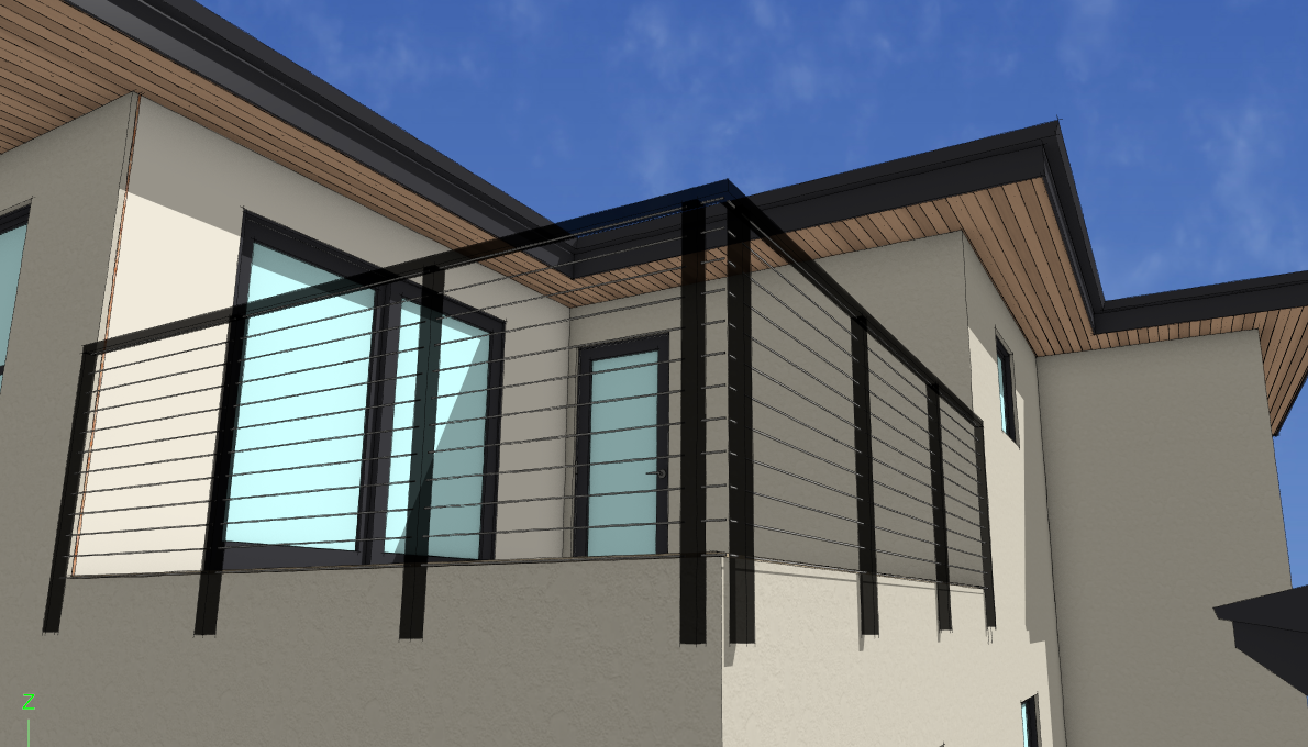

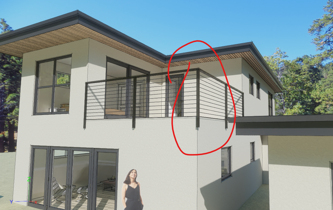

Gawdzira Posted July 25 Share Posted July 25 Is it possible to double up the newel at the corner of this balcony? This is done with the railing tool. Do I need to place the railing as an invisible wall and then make a symbol to get the proper end post configuration? Working in x18 https://www.dropbox.com/scl/fi/x4xukja18szwcme7sd5jn/Lugo-DD-V1c.plan?rlkey=z65uw96jnennoq7883swu0vnw&dl=0 Link to comment Share on other sites More sharing options...

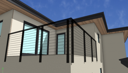

Gawdzira Posted July 26 Author Share Posted July 26 Thanks, it almost worked but I could not get the end baluster to move and leave a gap. I could move one side but once I moved the second side I ended up with 3 newels. I cheated in a section of invisible wall and then adjusted the end newels out. After that it required a molding for the top rail since the invisible wall corner stopped the top rail. Link to comment Share on other sites More sharing options...

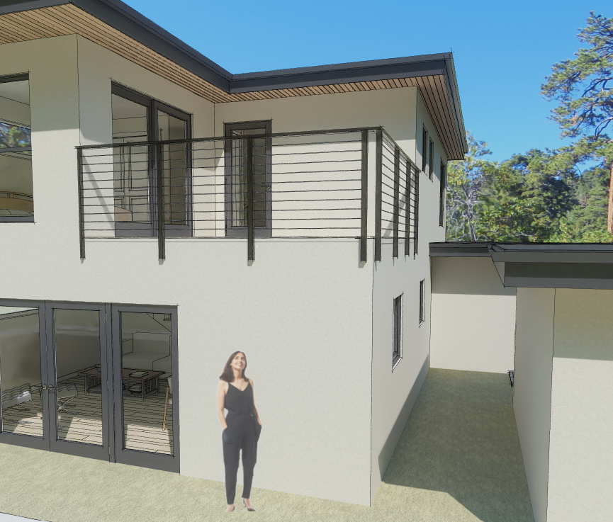

Gawdzira Posted July 26 Author Share Posted July 26 Second try, I got it to work with the delete newel tool. I like the invisible corner hack better better because it stops the cable from closing the corner Link to comment Share on other sites More sharing options...
