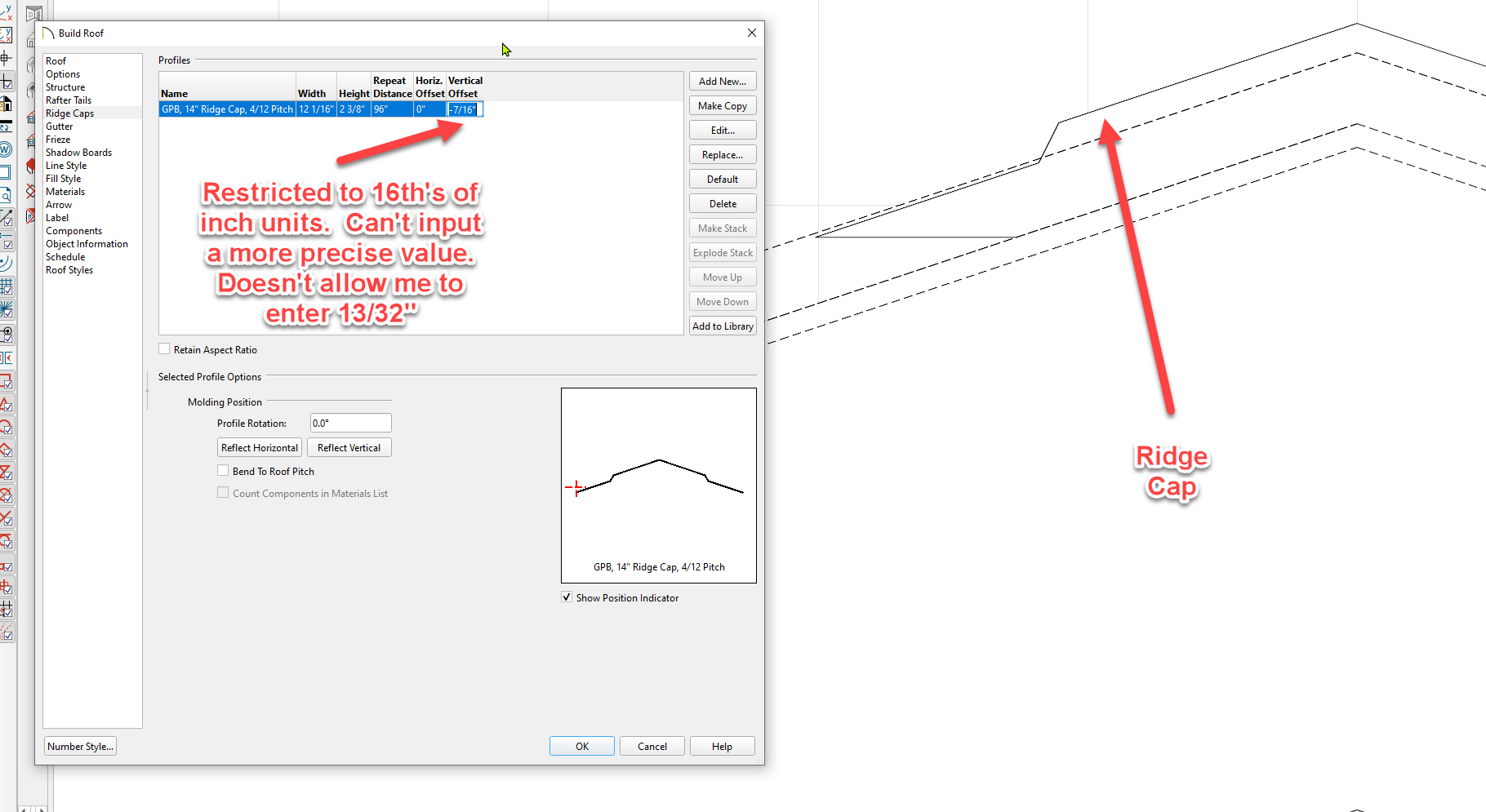

ComputerMaster86 Posted July 4 Share Posted July 4 I have added a custom ridge cap profile using a molding profile. I am noticing where one types in a vertical offset Chief keeps rounding the value to the nearest 16th of an inch. There is physically no way to type in a more precise value. Tried both X18 and X17 and get the same result. Link to comment Share on other sites More sharing options...
ComputerMaster86 Posted July 4 Author Share Posted July 4 This is a little frustrating. I can't be as precise as I want to be using the both the horizontal and vertical offsets. Chief is rounding values to the nearest 1/16th of an inch. Link to comment Share on other sites More sharing options...

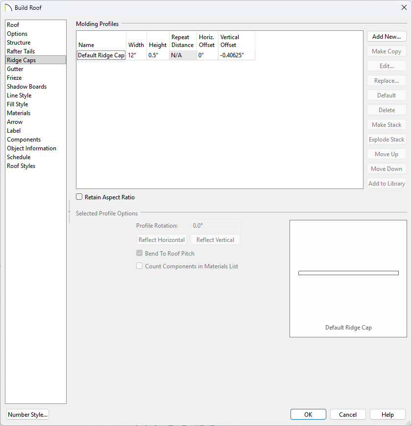

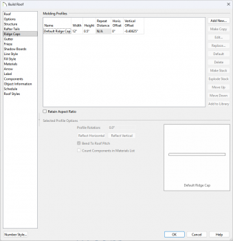

DBCooper Posted July 4 Share Posted July 4 I think it is only rounding the display in the dialog to the nearest 1/16". Use the number style button and change the display to decimal inches and you should see the actual values. Link to comment Share on other sites More sharing options...
ComputerMaster86 Posted July 4 Author Share Posted July 4 (edited) 1 hour ago, DBCooper said: I think it is only rounding the display in the dialog to the nearest 1/16". Use the number style button and change the display to decimal inches and you should see the actual values. Sorry to say but that doesn't seem to be true. It's indeed rounding the value I typed in. In other dialogue boxes Chief will round the display without rounding the value. For both the vertical and horizontal offset for molding profiles Chief seems to be rounding the actual value. I realized this after typing in values that used 32nd's and 64th's of an inch and my profile would move more than I wanted it to or wouldn't move at all, compared to the last value I typed in.. It was driving be batty. Then I realized it was only moving in increments of 1/16th's of an inch. Edited July 4 by ComputerMaster86 Link to comment Share on other sites More sharing options...

DBCooper Posted July 4 Share Posted July 4 Try changing the number style to decimal inches. Then if you type in -13/32, it should display -.40625 and that number should stick. Link to comment Share on other sites More sharing options...

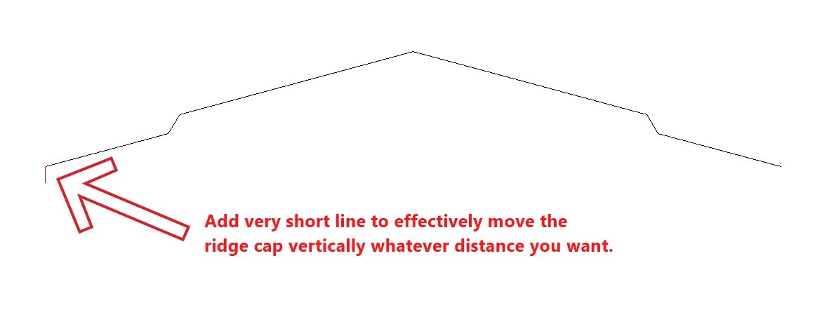

rlackore Posted Wednesday at 02:57 PM Share Posted Wednesday at 02:57 PM Lance, can you "cheat" by adding a very short vertical line to the bottom of the molding profile to force it "upward" by the very specific amount you need? Chief will allow very short lines, like 1/128". In section and 3D this short line will be virtually unnoticeable. Link to comment Share on other sites More sharing options...
