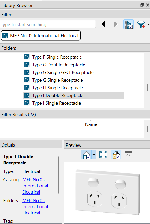

Mark3D Posted Saturday at 05:18 AM Share Posted Saturday at 05:18 AM Bonus librarys 1 Link to comment Share on other sites More sharing options...
Mark3D Posted Sunday at 12:38 AM Share Posted Sunday at 12:38 AM Something else i put together electrical symbols Electrical Au.calibz Link to comment Share on other sites More sharing options...
