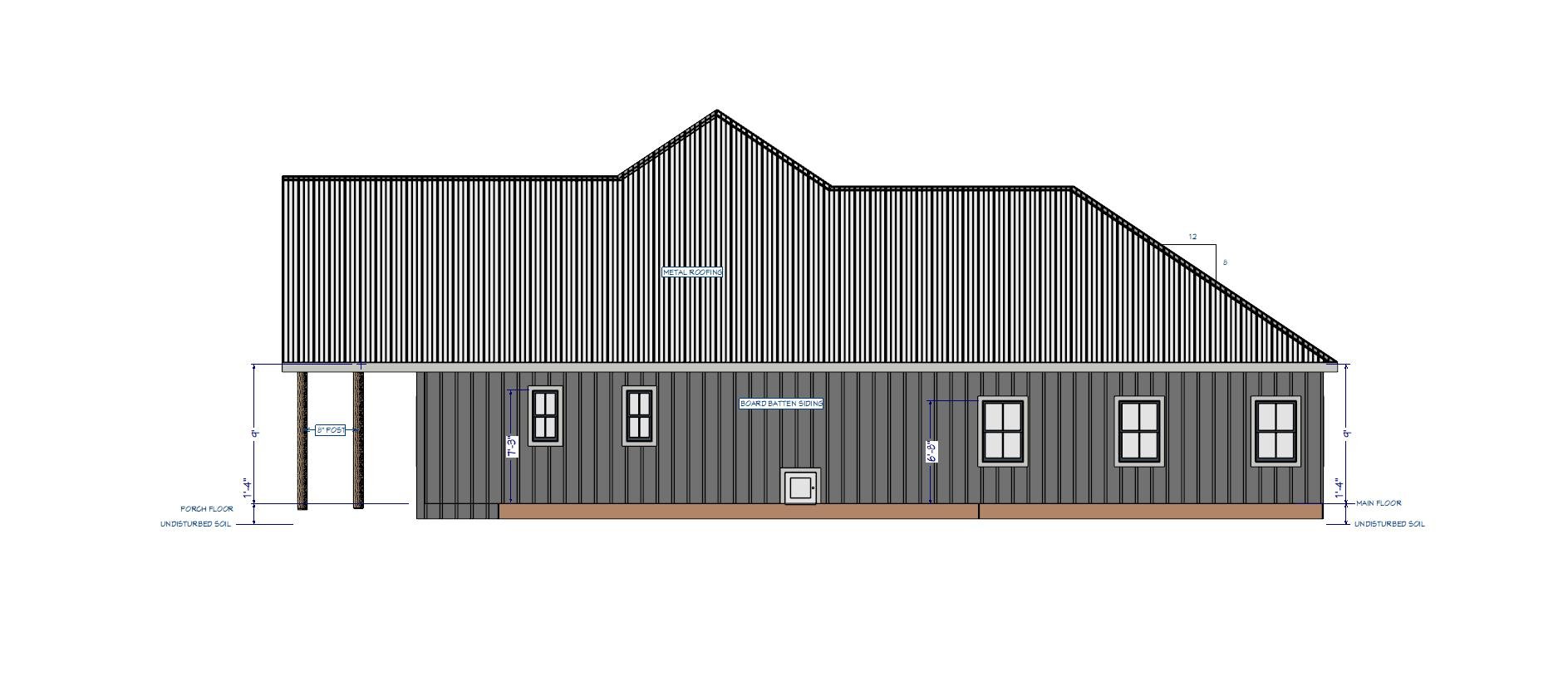

Migaloo Posted June 5 Share Posted June 5 Not sure what is causing this issue. I have the sidingt set to extend 12" but in a couple places it does not extend but the house wrap and OSB does. Any advice would be appreciated. Link to comment Share on other sites More sharing options...

PitMan71 Posted June 6 Share Posted June 6 The space on the right under the room designation structure panel doesn't have monolithic slab selected and the other side does. You could check that box, delete your foundation and rebuild and that fixes it. You could probably just rebuild foundation without deleting. I usually just leave the space/room settings as is and build the foundation how I want when I get to that point. in my case, its conventional (monolithic slab NOT selected in room settings) and when I build slab I choose block up or slab on grade and sometimes conventional. Link to comment Share on other sites More sharing options...

PitMan71 Posted June 6 Share Posted June 6 45 minutes ago, Migaloo said: How do I prevent all the work I've done on the foundation plan from being deleted when I build the foundation again? That's a great question. AND yes, we don't want to lose all of your work. looking at this again..... Open your foundation view, click on that far right foundation wall, Open Specification dbx, Structure Panel, Check the box at the top that says "Default Wall height".... looks like somehow the top of that one foundation wall object got changed. I should have checked that to begin with. Link to comment Share on other sites More sharing options...
