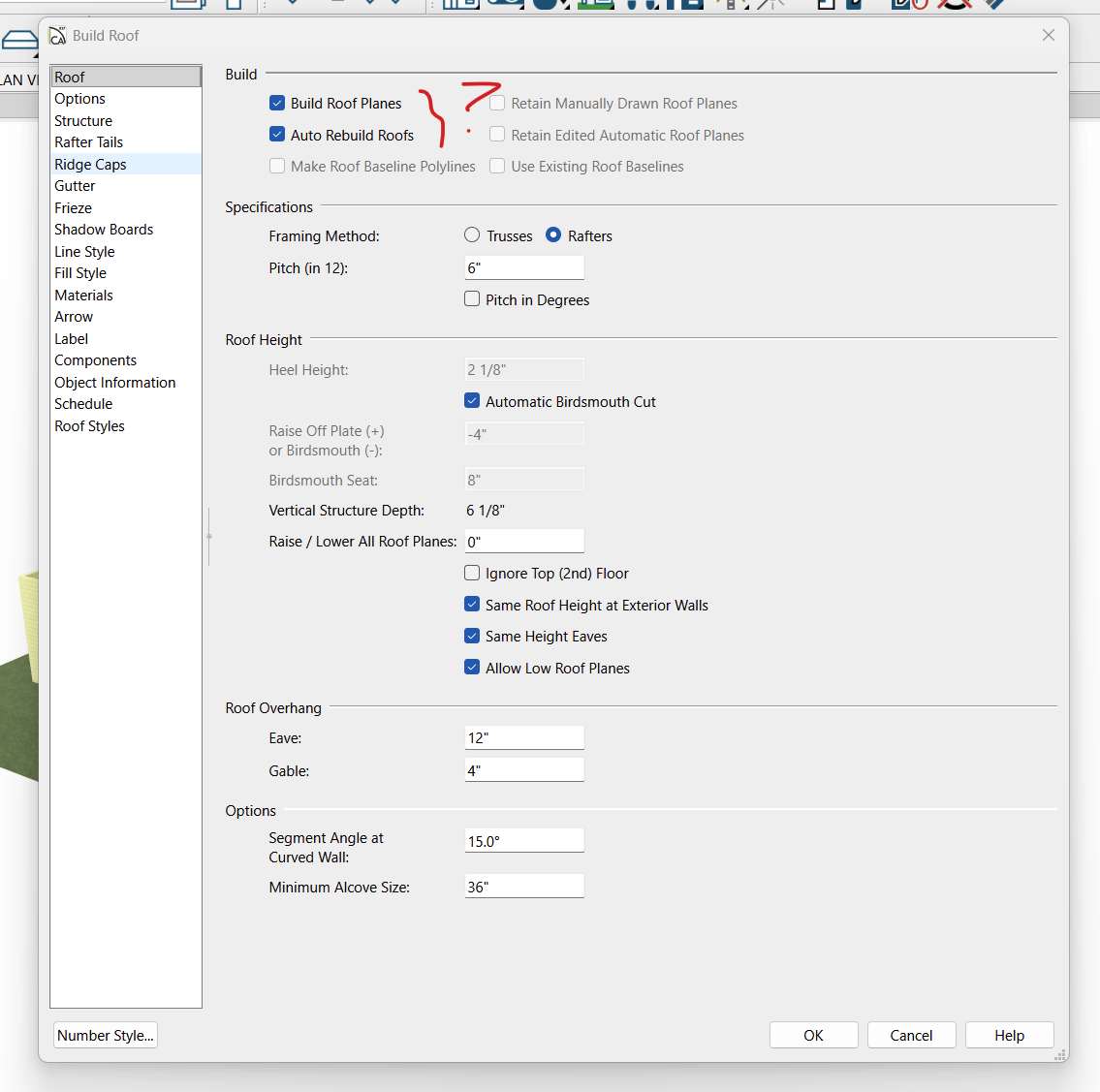

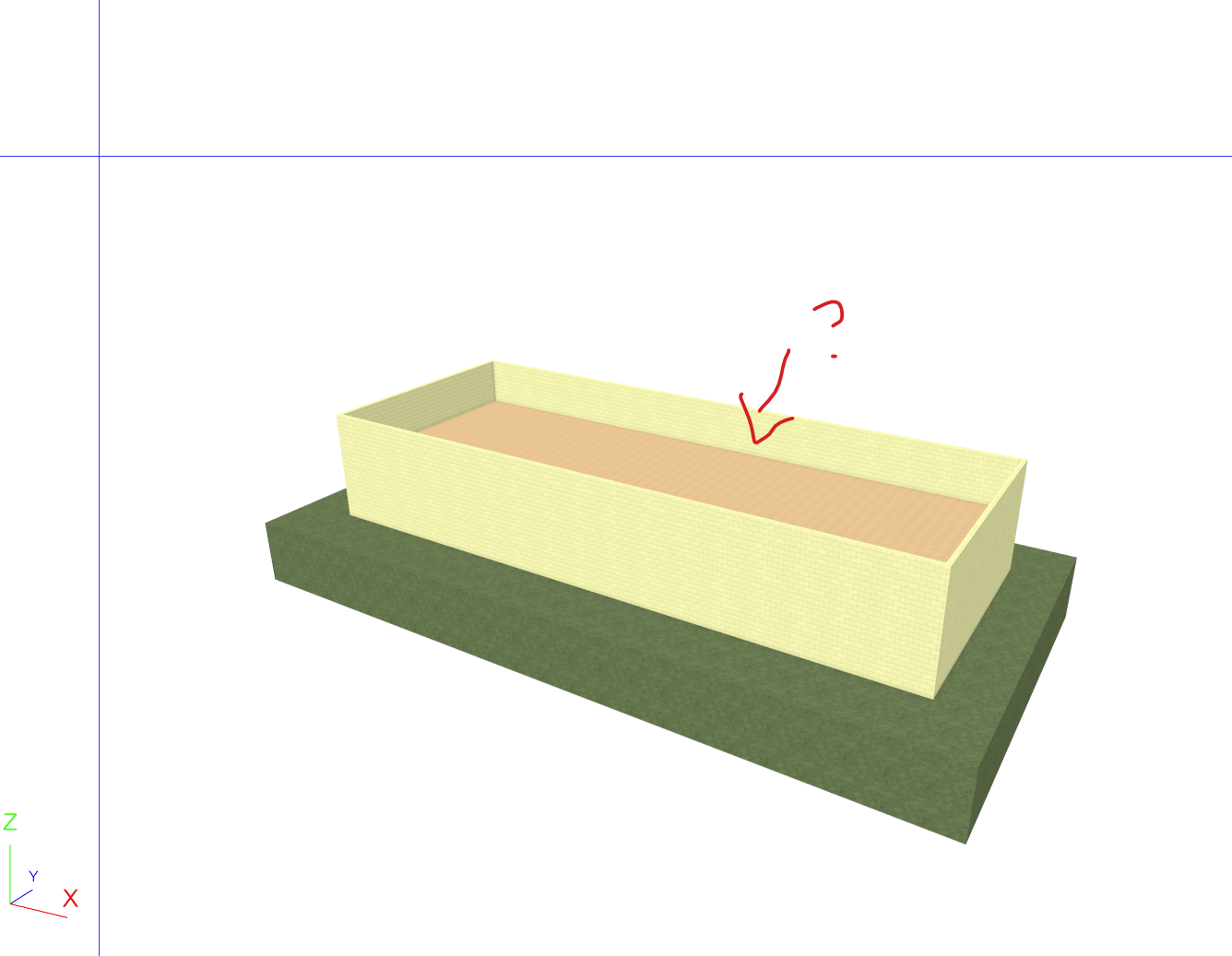

JKEdmo Posted Thursday at 10:53 PM Share Posted Thursday at 10:53 PM I was messing around with the settings and somehow my auto roof got deleted and now won't regenerate. Probably something simple, but can't figure it out. Plan attached. Any insight greatly appreciated. Thanks again, Jim GRADY - AS-BUILTS.plan Link to comment Share on other sites More sharing options...

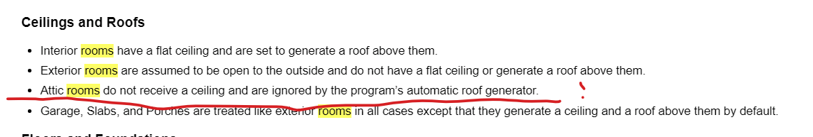

Solution ChiefTylerL Posted Thursday at 11:02 PM Solution Share Posted Thursday at 11:02 PM It looks like you have the 2nd floor room specified as an Attic room, which is a specialized roof type that doesn't allow roof generation. If you change your Room Type to Unspecified (or another basic Room Type), the roof will generate. I hope this helps! Link to comment Share on other sites More sharing options...

DBCooper Posted Thursday at 11:08 PM Share Posted Thursday at 11:08 PM I think it has to do with the fact that the room on the second floor is an attic and the one on the first floor is marked as not having a roof. You will get a roof if you change either one and it just depends on how you want the roof built. Link to comment Share on other sites More sharing options...
