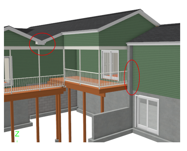

Ed_Orum Posted May 28 Share Posted May 28 Hello, I need a little help with two things. 1. How do I get the long vertical extension of the retaining wall to go only the top of the retaiing wall? (long vertical oval). 2. I need to fix the roof intersection at the small circle. The screenshot shows the problems, and the plan is attached. Thanks in advance! --Lane Apollino Remodel Plan 2026.zip Link to comment Share on other sites More sharing options...
robdyck Posted May 28 Share Posted May 28 36 minutes ago, Ed_Orum said: 1. How do I get the long vertical extension of the retaining wall to go only the top of the retaiing wall? (long vertical oval). 20260528-2049-32.6272496.mp4 1 Link to comment Share on other sites More sharing options...
robdyck Posted May 28 Share Posted May 28 For the roof, single-click on one plane's bottom edge, press '2', then single-click on the opposing plane's bottom edge. That will join them to form a level valley which you can take care of however you see fit. Link to comment Share on other sites More sharing options...
