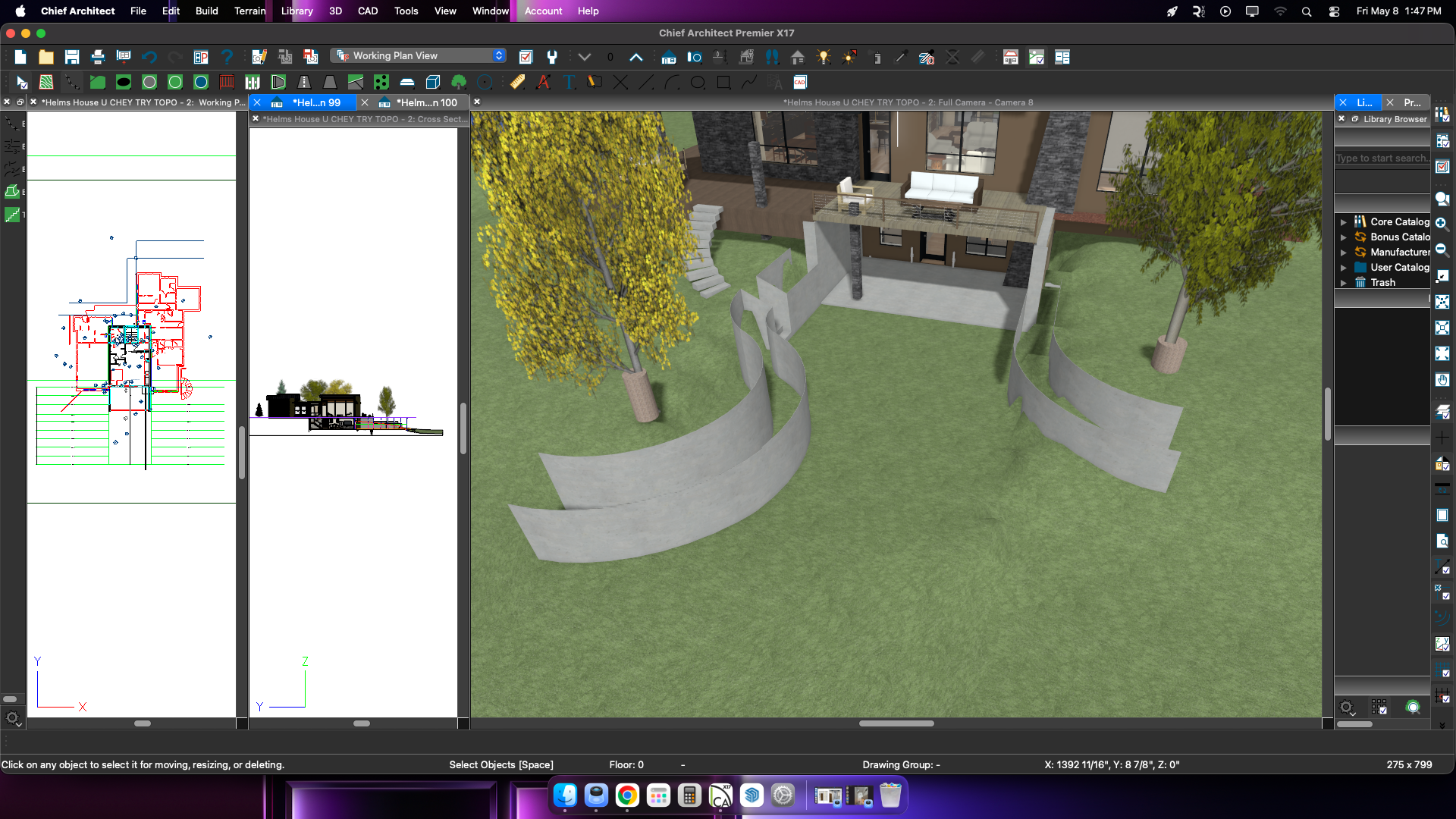

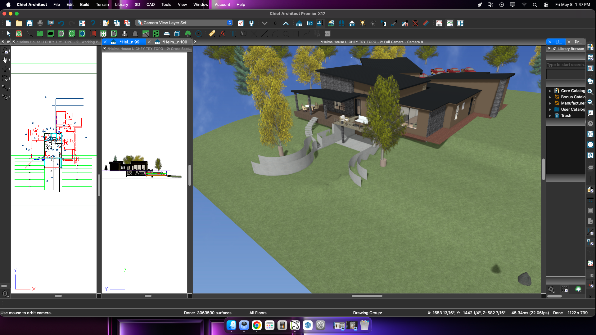

RobertHelms Posted May 8 Share Posted May 8 Hello All, I am going on about a year into learning Chief, within the last month I have started to self teach myself the terrain tool. I was wondering if I could get some tips on it. I have a personal project that I am working on. I was given hand drawn cross sections of physical elevation to work off of in order to create landscaping. I have managed to get as far as you can see in attachment I was wondering why I have a line of "waves" on either side of what I am trying to represent as retaining walls. Anything helps at this point. Thank you in advances Link to comment Share on other sites More sharing options...
DBCooper Posted May 9 Share Posted May 9 It's hard to tell because your plan views are so small but my guess is that you have drawn your retaining walls actually crossing over your elevation lines. Retaining walls seem to work better if you have elevations on one side and the other without them crossing. They can be close, but not crossing. If that doesn't help, you might need to post your plan. Link to comment Share on other sites More sharing options...
Mark3D Posted May 9 Share Posted May 9 This video show what happens with overlapping height data 1 Link to comment Share on other sites More sharing options...
