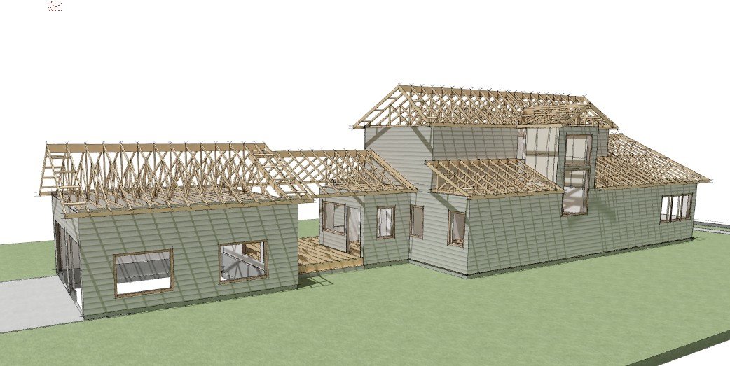

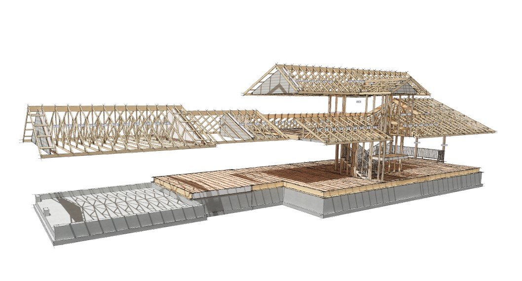

Randy5565 Posted May 4 Share Posted May 4 Hello. I am relatively new to Chief and am having issues with getting wall framing to show up. I have auto build for framing but the walls come in solid with layers. My goal is a view where all framing is visible in 3D. Both interior and exterior walls are not being framed. Would appreciate any insights. Randy Link to comment Share on other sites More sharing options...

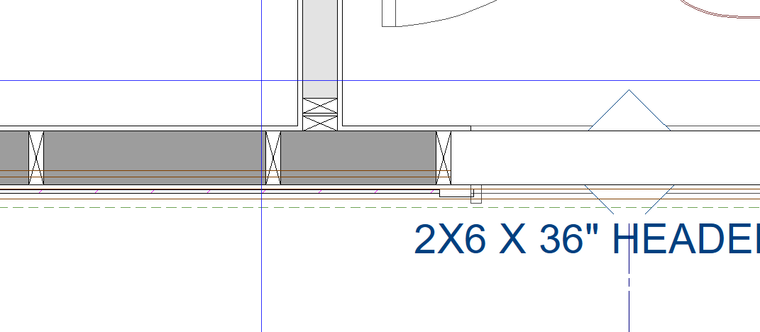

GeneDavis Posted May 4 Share Posted May 4 How do we know you framed the walls? I can see mine in my plan view if I turn on the wall framing layer. Link to comment Share on other sites More sharing options...
