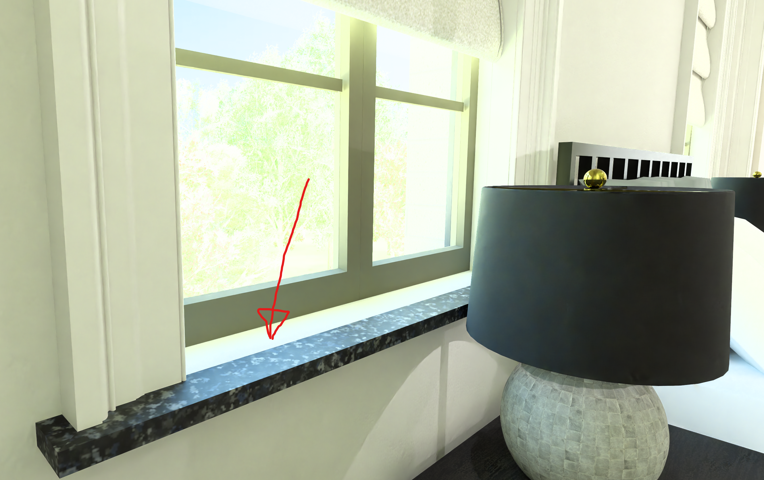

mtldesigns Posted yesterday at 05:18 PM Share Posted yesterday at 05:18 PM Trying to figure out how to make the interior (complete) sill a different material than the trim. It has to have a frame and trim works. Client request "All window sills - 2 cm black polished Granite/Quartz" Link to comment Share on other sites More sharing options...
robdyck Posted 23 hours ago Share Posted 23 hours ago (edited) All you need to do is select a molding profile for the interior sill from the library. That will provide a separate field for the Interior Sill Molding in the Materials Tab. Unfortunately, this profile needs to be the correct size in the library and even then, it will build to the bottom of the window frame. AFAIK, There is no setting to adjust the reveal of a window sill. Edited 23 hours ago by robdyck Link to comment Share on other sites More sharing options...
mtldesigns Posted 23 hours ago Author Share Posted 23 hours ago 8 minutes ago, robdyck said: profile needs to be the correct size in the library and even then I figured I'd need to create a new profile anyways (wanted to soften the edges some), but was seeing if this would even work with OOTB profile. What's 2 CM, about 7/4" of an inch? And I agree, this simple test shows that it does not project to the window frame. Link to comment Share on other sites More sharing options...
