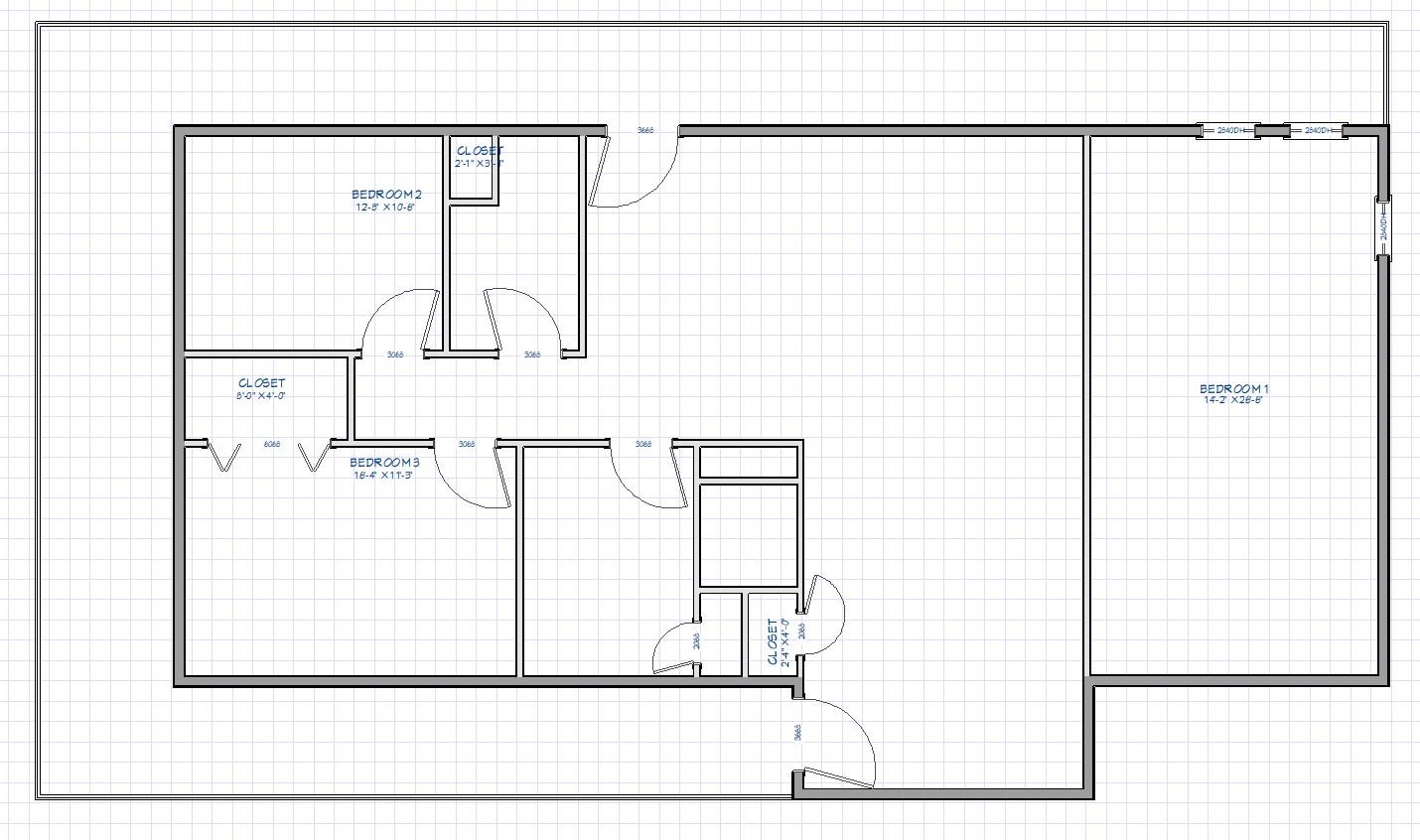

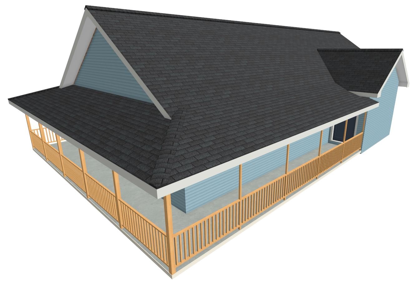

Mark3D Posted April 19 Share Posted April 19 Had a go its not perfect but maybe good enought with some manual editing 264014205_3roofandporch.plan Link to comment Share on other sites More sharing options...

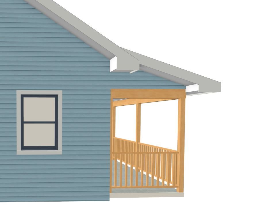

megclay Posted April 19 Author Share Posted April 19 (edited) I will look at it thanks Mark for all the help Question how do I change the gull wing roof height to match other roof level so the eaves match and how to remove extra eave. 264014205_3roofandporch-eaves.plan Edited April 20 by megclay Link to comment Share on other sites More sharing options...
Mark3D Posted April 20 Share Posted April 20 Try watching some videos there are heaps on you tube also chief website have more just not sure you can access them if you are using x15 may be SSA is not current. there is a note in the plan file attached plan file 264014205_3roofandporch.plan Link to comment Share on other sites More sharing options...
