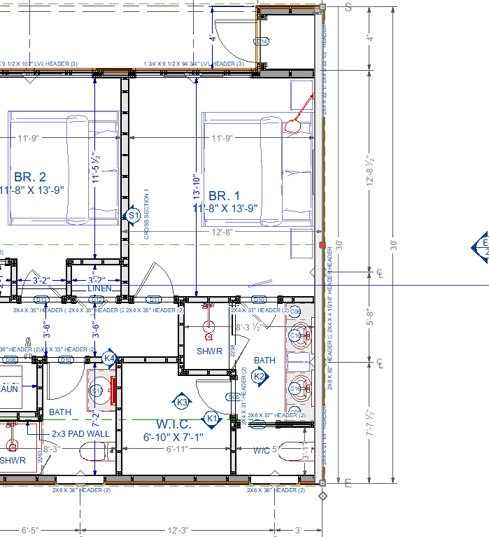

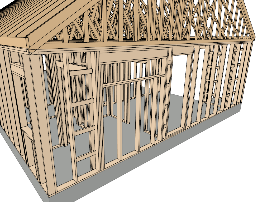

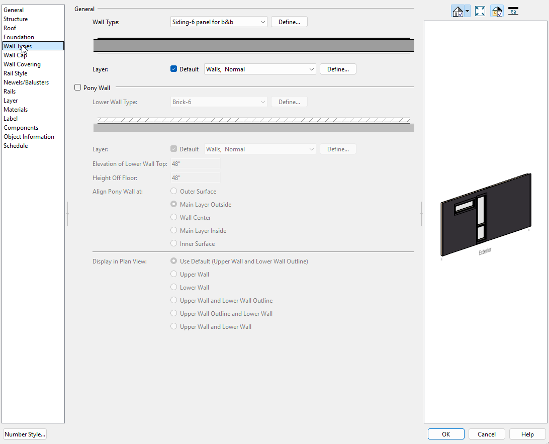

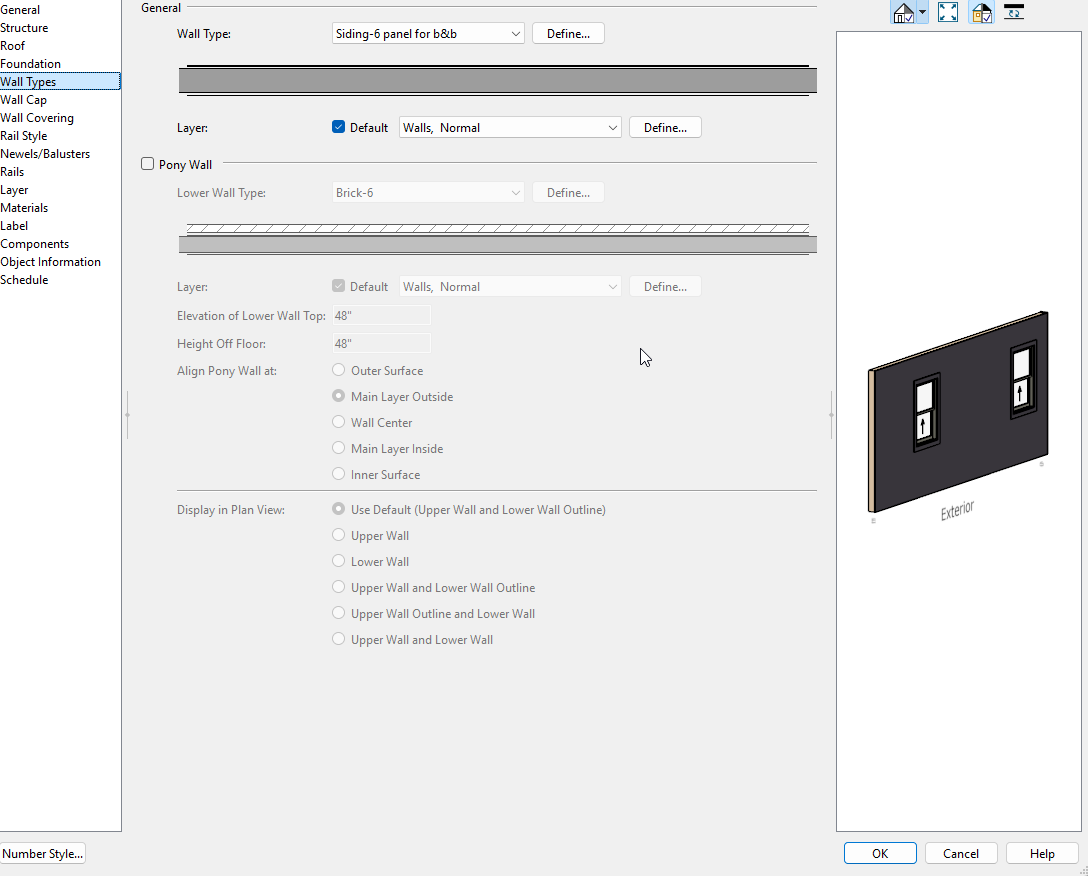

GeneDavis Posted April 4 Share Posted April 4 I've an exterior wall that won't display with same fill spec and with framing, while every other wall in the plan shows the way I want. Here is a pic of part of the plan of this one floor house on slab. And here is the 3D framing view showing that the wall is 100 percent framed, as are all others. Here is the wall dbx for the exterior wall adjacent, at plan bottom. And for the problem wall. Link to comment Share on other sites More sharing options...
GaryOhmer Posted April 4 Share Posted April 4 I see some of your roof framing projects into the upper wall - pull them back and see what happens Link to comment Share on other sites More sharing options...
GeneDavis Posted April 4 Author Share Posted April 4 Thanks, @GaryOhmer! I edited the gable end truss so the top chord tails are snipped (as it will be built), and the truss has no elements that go into wall envelope below. No fix. The wall still displays as shown in my pic. I can select the wall and do second select and get the topmost plate, and where there are studs, I can do select tab and get the stud nearby, but the display is my problem. Link to comment Share on other sites More sharing options...
