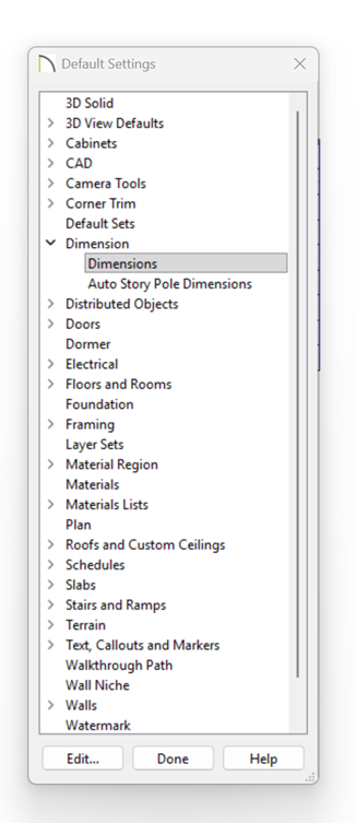

KarenLF Posted 4 hours ago Share Posted 4 hours ago Temporary Dimensions is missing from the Settings menu. How can I adjust my preference to them? Link to comment Share on other sites More sharing options...
Chrisb222 Posted 4 hours ago Share Posted 4 hours ago 5 minutes ago, KarenLF said: Temporary Dimensions is missing from the Settings menu. Each dimension default now has settings for Temporary Dimensions. That way you can have multiple settings for temporary dimensions, not just one. Open one of your dimension defaults and you'll see the temporary panel. Link to comment Share on other sites More sharing options...
Joe_Carrick Posted 4 hours ago Share Posted 4 hours ago (edited) Just open that "Dimensions" item and you'll get to select any of the dimension type defaults and then "Setup Temporary" Edited 4 hours ago by Joe_Carrick Link to comment Share on other sites More sharing options...
