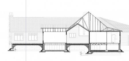

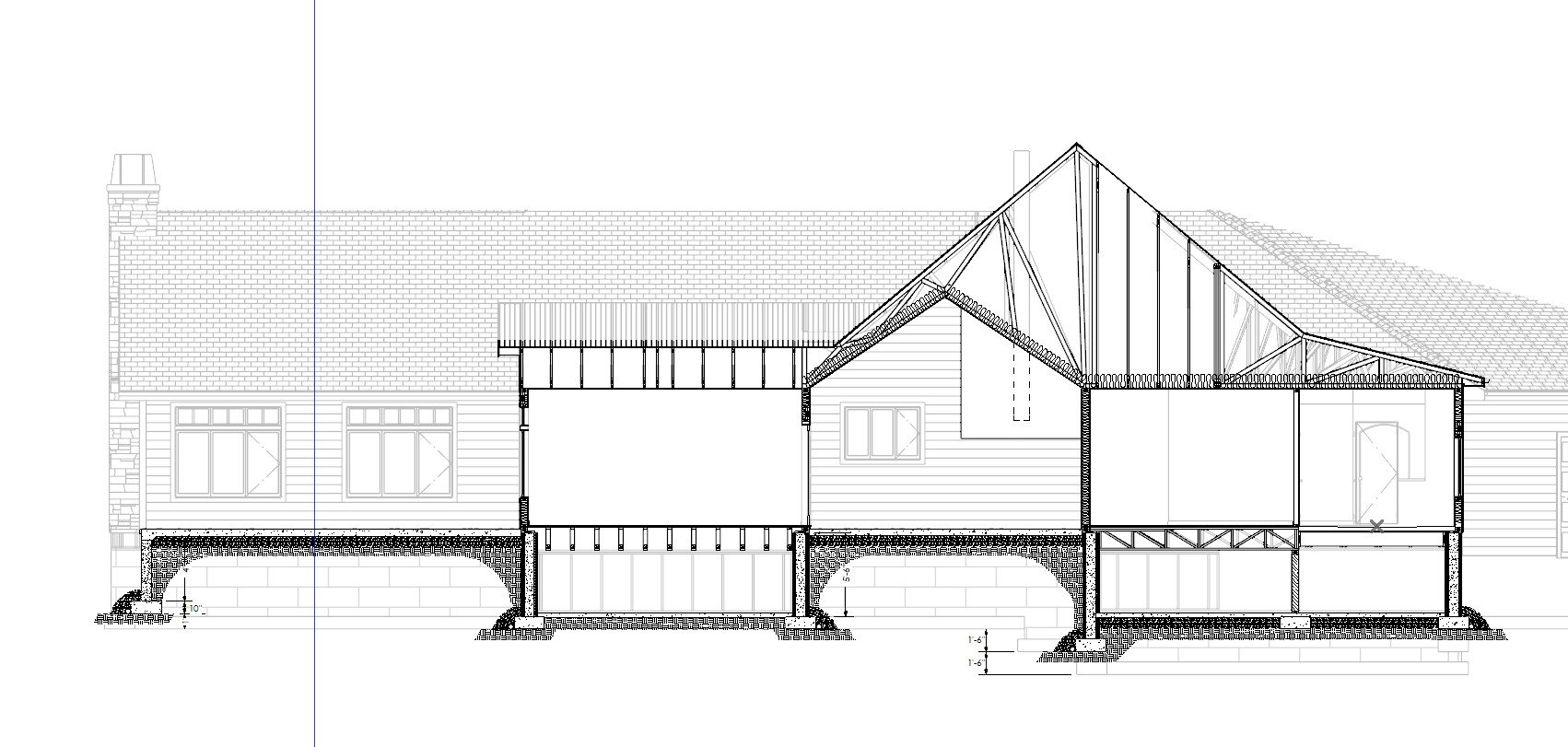

QualicoreHomes Posted March 25 Share Posted March 25 Is it possible to have the spaces in between the truss webbing filled rather than that they are see through? It would make cross sections so much cleaner when you don't see 20+ truss webs that don't align or are different shapes because of the roof outline. Any suggestions on how to make a non back clipped cross section still look clean and not cluttered? Thanks in advance for any pointers. Link to comment Share on other sites More sharing options...
NRST8TRKR Posted March 25 Share Posted March 25 Gerald, What I do is pick a truss that is right in front of the cross section camera and name it cross section truss and turn of the truss layer. That way I only have the one truss showing. Have a great day,Ken 1 1 Link to comment Share on other sites More sharing options...
DRAWZILLA Posted March 25 Share Posted March 25 You can also just use the backclipped tool in each camera's dbx. set it to 20" or so and it will pick up 1 truss. there is also a framing backclipped tool to do it. 1 1 Link to comment Share on other sites More sharing options...
QualicoreHomes Posted March 26 Author Share Posted March 26 21 hours ago, NRST8TRKR said: What I do is pick a truss that is right in front of the cross section camera and name it cross section truss and turn of the truss layer. That way I only have the one truss showing. Hello Ken, I had started doing that but with the plan I am working on has several cross sections and the trusses do not all go into the same direction so I was hoping that there would be a faster way. Thanks for your help! 21 hours ago, DRAWZILLA said: You can also just use the backclipped tool in each camera's dbx. set it to 20" or so and it will pick up 1 truss. there is also a framing backclipped tool to do it. That is what I was used to but I wanted to try to show more of the rest of the house with the current plan and thought to give it a try but maybe I need to go back to the old ways again. Thanks! Link to comment Share on other sites More sharing options...
DRAWZILLA Posted March 26 Share Posted March 26 In that case just use the framing backclipped tool and not use the regular backclipped tool. 1 Link to comment Share on other sites More sharing options...
QualicoreHomes Posted March 26 Author Share Posted March 26 7 hours ago, DRAWZILLA said: In that case just use the framing backclipped tool and not use the regular backclipped tool. Sorry I don't know what you mean. Do you have X18 already? I'm probably looking right at it but I don't know what tool you are talking about. Link to comment Share on other sites More sharing options...
DRAWZILLA Posted March 28 Share Posted March 28 On 3/26/2026 at 4:05 PM, QualicoreHomes said: Sorry I don't know what you mean. Do you have X18 already? I'm probably looking right at it but I don't know what tool you are talking about. On 3/26/2026 at 4:05 PM, QualicoreHomes said: Sorry I don't know what you mean. Do you have X18 already? I'm probably looking right at it but I don't know what tool you are talking about. open up the camera dbx and you see the backclipped adjustment and the framing backclipped adjustment checkboxes and amount needed area. 1 Link to comment Share on other sites More sharing options...
QualicoreHomes Posted March 28 Author Share Posted March 28 Looked right past it for many times. Thanks!! Gerard Link to comment Share on other sites More sharing options...
