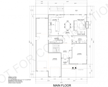

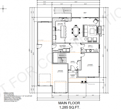

Britt2026 Posted March 20 Share Posted March 20 When I print to PDF the plan walls / dimensions etc. appear faded. I'm not sure what to adjust in the settings to get the PDF to look as saturated as the actual file. Example below. DPI is set to 600 Link to comment Share on other sites More sharing options...
