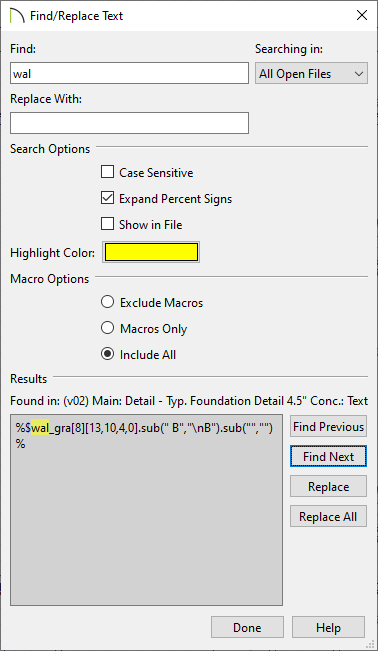

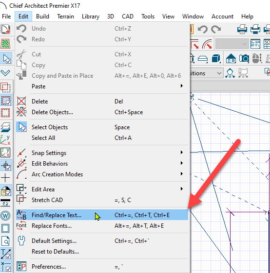

DBCooper Posted March 5 Share Posted March 5 (edited) Yes. If you use the toolbar search, it pops right up when you type "find". Edited March 5 by DBCooper Link to comment Share on other sites More sharing options...
ComputerMaster86 Posted March 5 Share Posted March 5 (edited) Just a small FYI about Chief's "Find and Replace" tool. If the word "Batt" is the output (computed result) of a text macro, "Find and Replace" will be of no help in locating and finding the word. It works as advertised on actual text, or pieces of text that are part of macro code. Edited March 5 by ComputerMaster86 1 Link to comment Share on other sites More sharing options...
