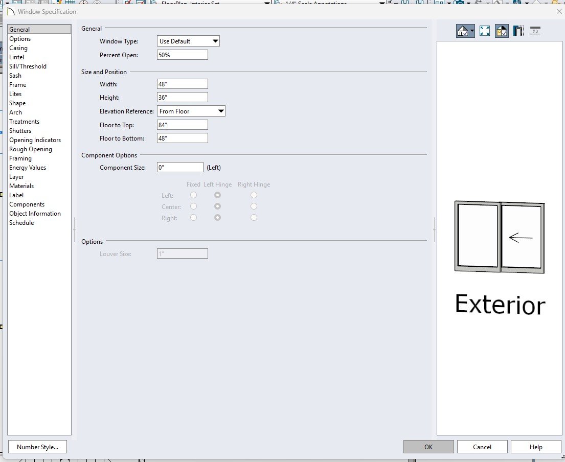

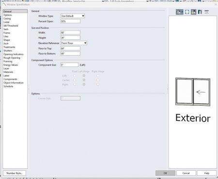

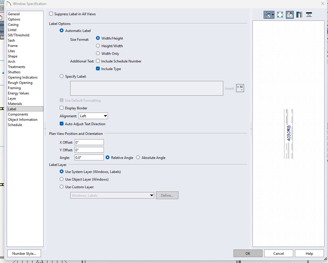

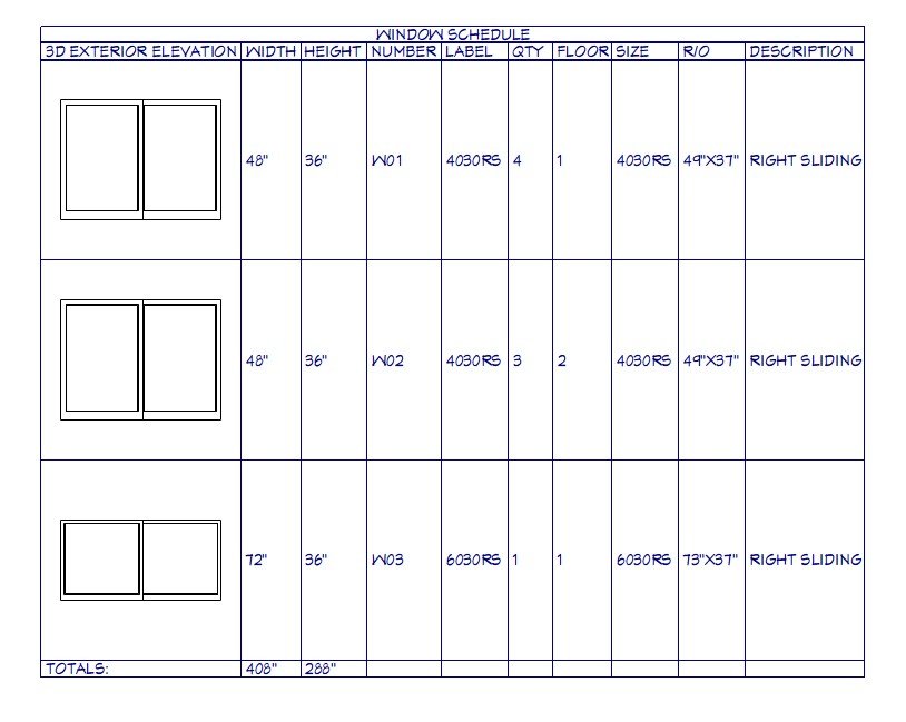

Fotis1960 Posted February 10 Share Posted February 10 Why are the size and labels in window and door schedules off? The plan also uses these for the labels so they are off on the plans as well. Is there a different setting that I need to change? Thanks in advance Link to comment Share on other sites More sharing options...
Solution Chrisb222 Posted February 10 Solution Share Posted February 10 9 minutes ago, Fotis1960 said: Why are the size and labels in window and door schedules off? Do you mean why is a 48"x36" window using a "4030" label? If that's your question, it's not "off." 4030 represents the size in feet and inches - 4'0" x 3'0" - and is standard nomenclature in the industry for ordering windows. Your schedule is correct... that is, if you want a rough opening that is 1" total larger than the window size. Link to comment Share on other sites More sharing options...
Renerabbitt Posted February 10 Share Posted February 10 As Chris said, this is a standard convention in the AAMA and NFRC for labeling fenestration. It will be in most architectural textbook you can find as well Link to comment Share on other sites More sharing options...
Fotis1960 Posted February 10 Author Share Posted February 10 Thanks guys. As you can tell I'm not a pro, but I should have looked at the numbers a little closer and figured it out. 1 Link to comment Share on other sites More sharing options...
para-CAD Posted February 11 Share Posted February 11 Most called windows are actually ½" smaller both ways than called (48" x 36" is 47 ½" x 35 ½") and the R/O actually is 4-0/3-0 Anderson has some custom sizes....always refer people to the vender literature.... Link to comment Share on other sites More sharing options...
