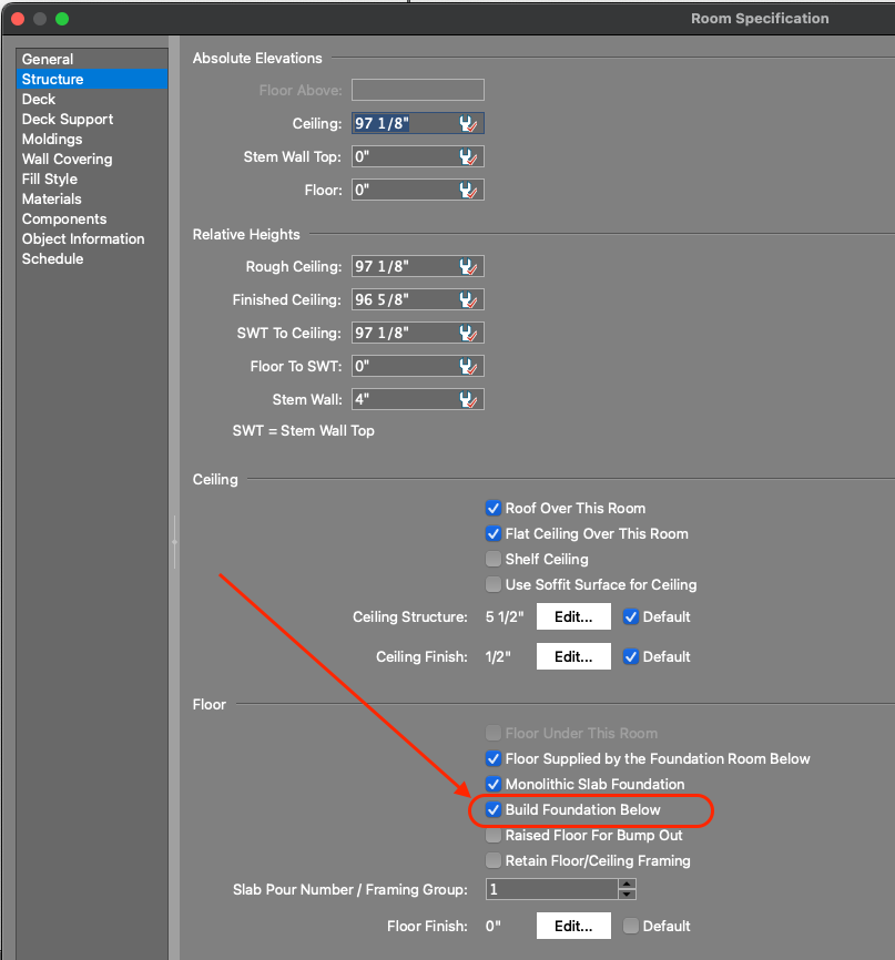

Solution Chrisb222 Posted February 2 Solution Share Posted February 2 12 minutes ago, Ed_Orum said: Here is the plan: Open the Room specification and check Build Foundation Below: Link to comment Share on other sites More sharing options...
Ed_Orum Posted February 2 Author Share Posted February 2 Thanks, I must have turned it off trying to make it a slab on grade foundation. It works now! 1 Link to comment Share on other sites More sharing options...
