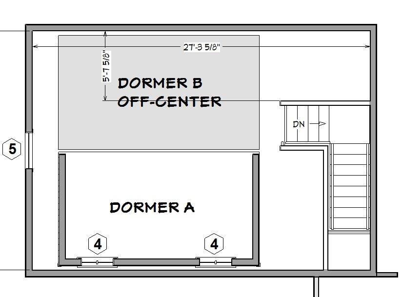

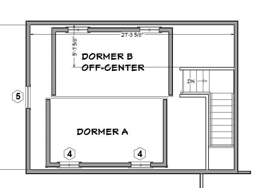

twnctyguy Posted January 25 Share Posted January 25 Why can't I replicate the original dormer "A" (to the new matching "B" dormer) and have it be centered without it disappearing? See drawings...thanks. (Would love to attach the plan, but Chief Architect says it's too big...really helpful...not!) Link to comment Share on other sites More sharing options...

Chief16Designer Posted January 26 Share Posted January 26 Lower the hight of the roof Link to comment Share on other sites More sharing options...
twnctyguy Posted January 26 Author Share Posted January 26 Roofs are both the same height Link to comment Share on other sites More sharing options...
Chief16Designer Posted January 26 Share Posted January 26 lower the hight by 6 or 12 inches Link to comment Share on other sites More sharing options...
Doug_N Posted January 26 Share Posted January 26 Put the plan file in a dropbox, or on Onedrive, and post a link to the file. Link to comment Share on other sites More sharing options...
ComputerMaster86 Posted January 28 Share Posted January 28 Have you tried exploding the original dormer, selecting the individual components of the original dormer and the n use copy reflect about? Link to comment Share on other sites More sharing options...
