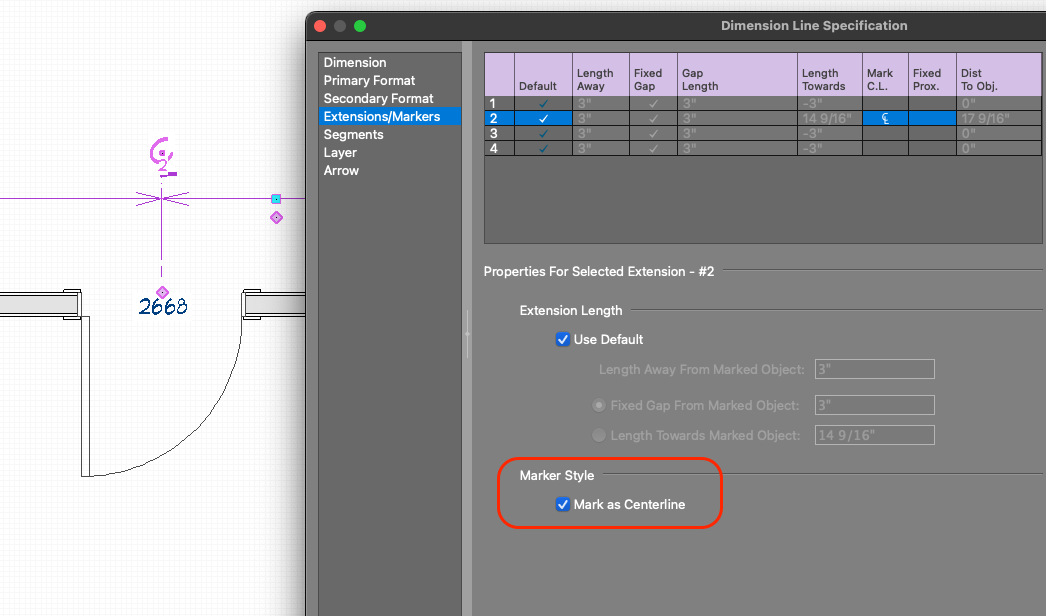

Solution Chrisb222 Posted January 20 Solution Share Posted January 20 4 hours ago, PitMan71 said: Is there a way to suppress the "CL" for the centerline dimensions and keep the centerline extension? Yes, uncheck Mark as Centerline: 4 hours ago, PitMan71 said: OR Control just the size of the CL mark? The size is controlled by the text size of the dimension text. So yes it can be changed but all other dimension text will also change. Link to comment Share on other sites More sharing options...
PitMan71 Posted January 20 Author Share Posted January 20 Thanks for the reply. I am aware of that setting BUT I want to keep the centerline extension. When I turn off "Mark as centerline" the extensions change to continuous lines. May be a limitation. I might look at changing my overall dim text height. Link to comment Share on other sites More sharing options...

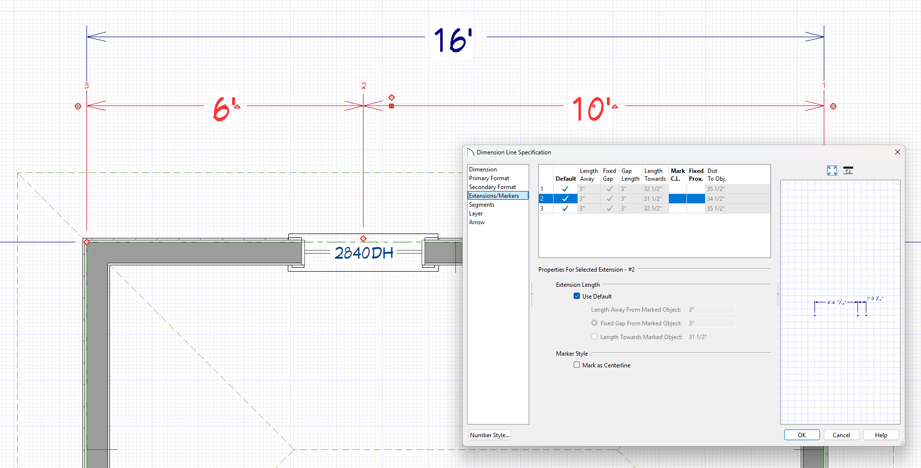

DBCooper Posted January 20 Share Posted January 20 Unchecking "mark as centerline" should keep the extension and just remove the CL text: Link to comment Share on other sites More sharing options...

PitMan71 Posted January 21 Author Share Posted January 21 15 hours ago, DBCooper said: Unchecking "mark as centerline" should keep the extension and just remove the CL text: yeah. Thanks. I was hoping to keep the centerline line type as well. For me the centerline line type is enough to indicate center of the object being dimensioned to without the mark. Link to comment Share on other sites More sharing options...
