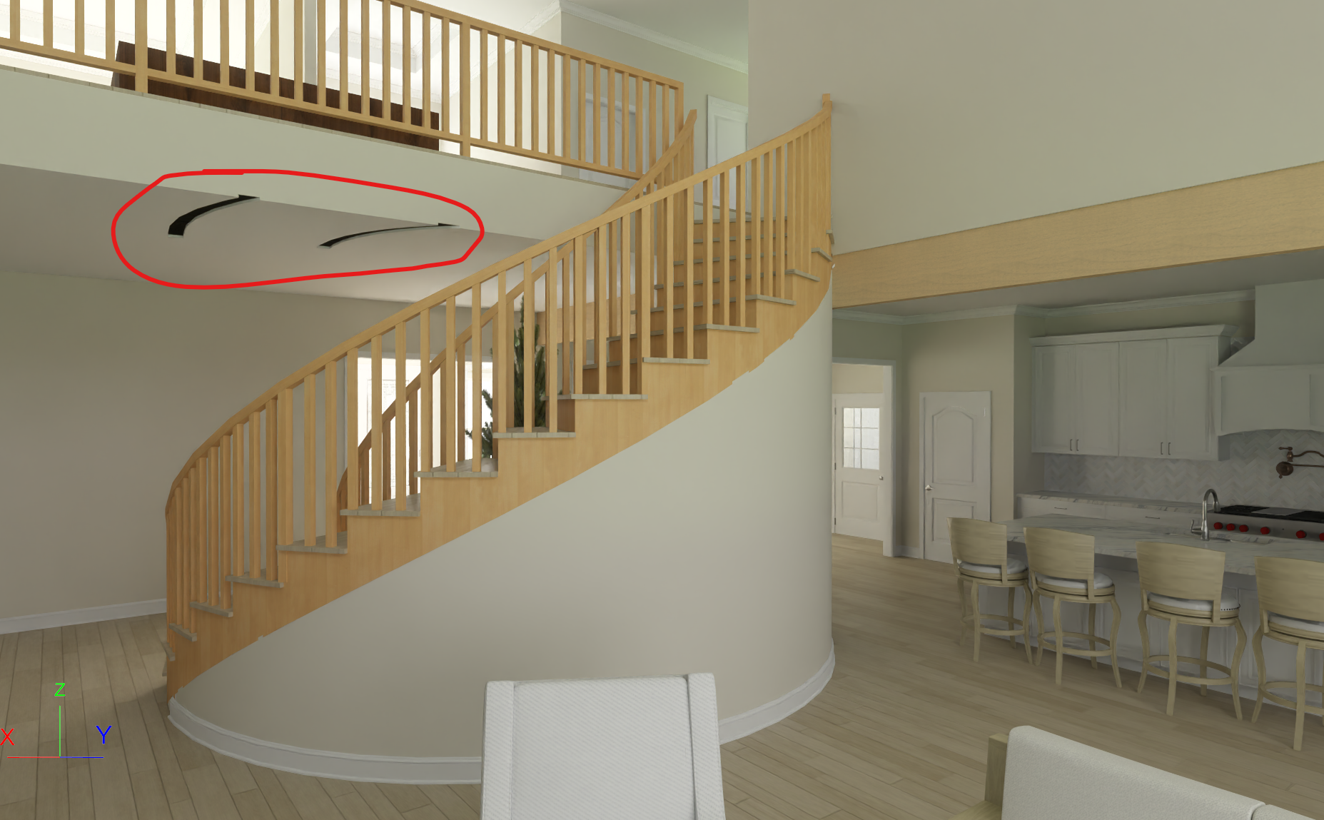

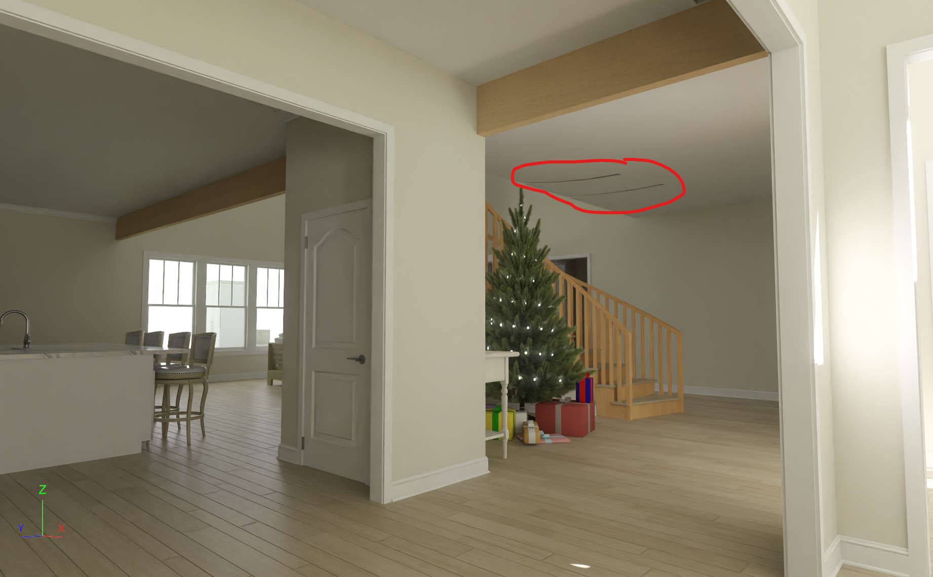

winterdd Posted January 20 Share Posted January 20 (edited) Hey Guys, is there a way to get rid of this on the ceiling when doing walls below stairs. Should I be using pony walls? Edited January 20 by winterdd Link to comment Share on other sites More sharing options...
Mark3D Posted January 20 Share Posted January 20 Stairs cut walls like roof so my guess is the that the stairs need to be pull to inside of wall. 1 Link to comment Share on other sites More sharing options...
robdyck Posted January 20 Share Posted January 20 Try opening the room dialog and uncheck the default for the room Ceiling Finish. 1 Link to comment Share on other sites More sharing options...
winterdd Posted January 20 Author Share Posted January 20 1 hour ago, robdyck said: Try opening the room dialog and uncheck the default for the room Ceiling Finish. Thanks Rob! 1 Link to comment Share on other sites More sharing options...
