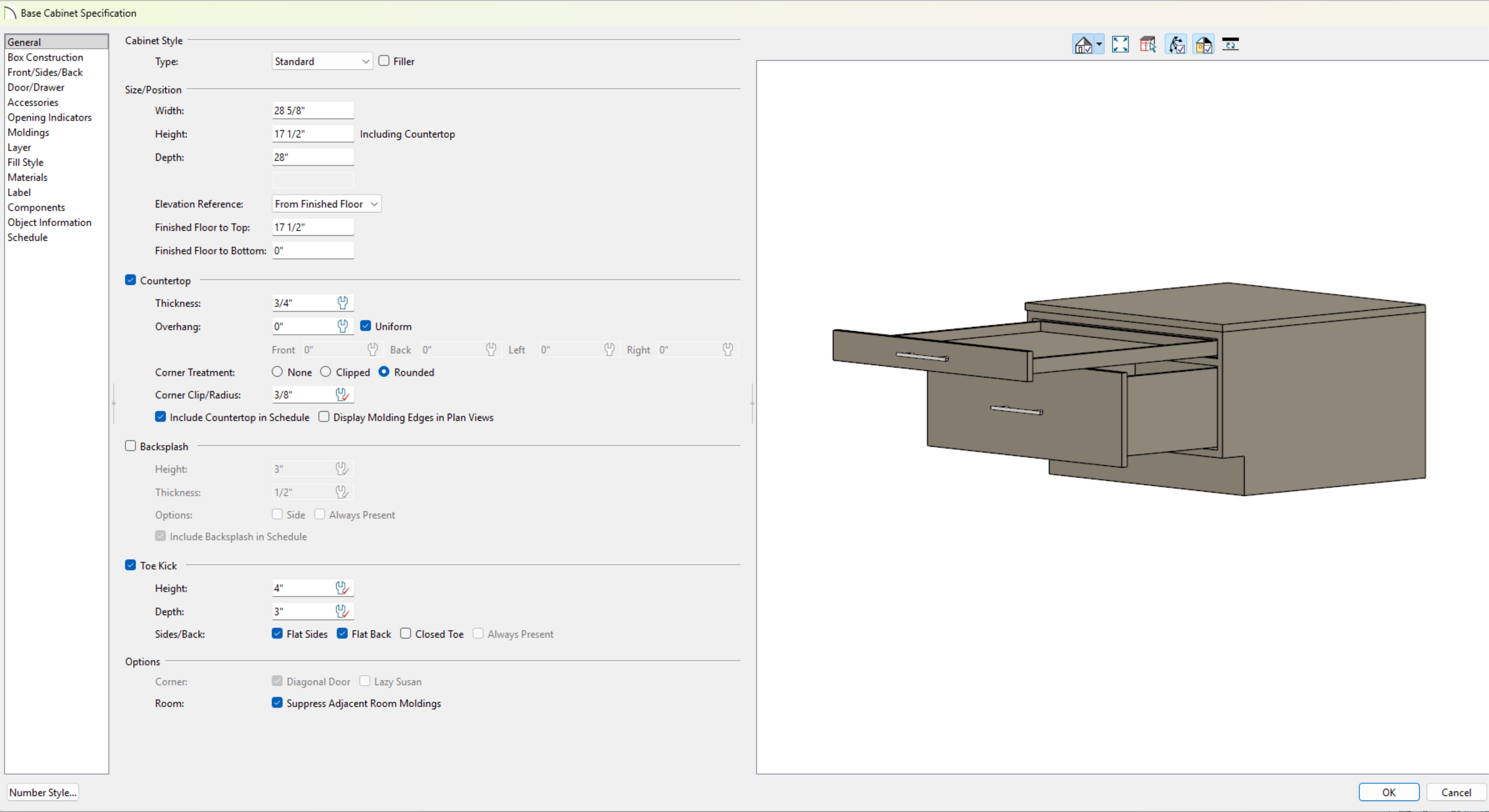

Drew-PRH Posted January 19 Share Posted January 19 Good day all, I've been looking through the Base Cabinet Specifications dialog and can not figure out how to take this 2" High Drawer and raise the Drawer Bottom up to create a Pull Out Shelf Any suggestions would be helpful, and also which would include it still being able to be viewed as 'Pulled Out'. Thanks - Drew Link to comment Share on other sites More sharing options...

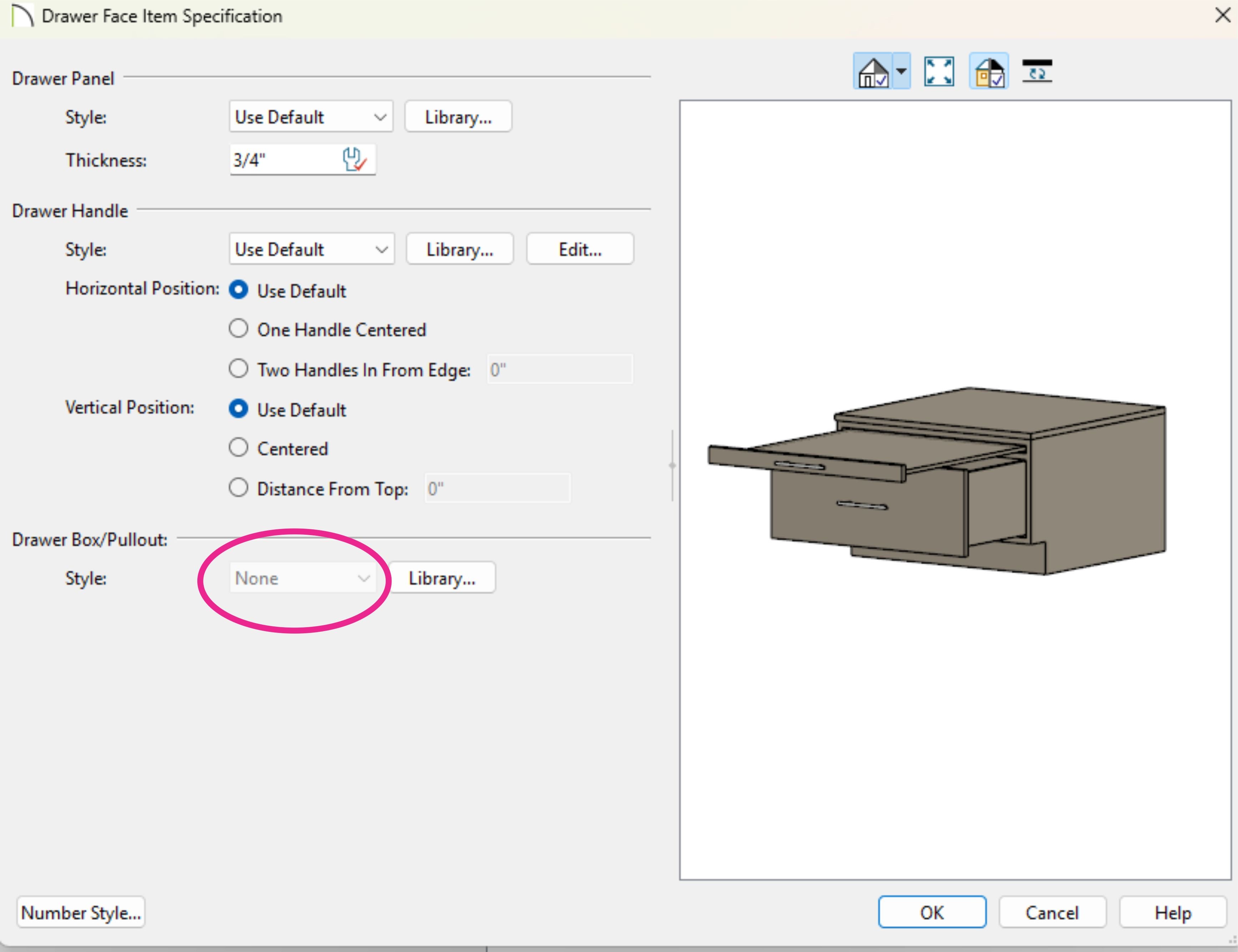

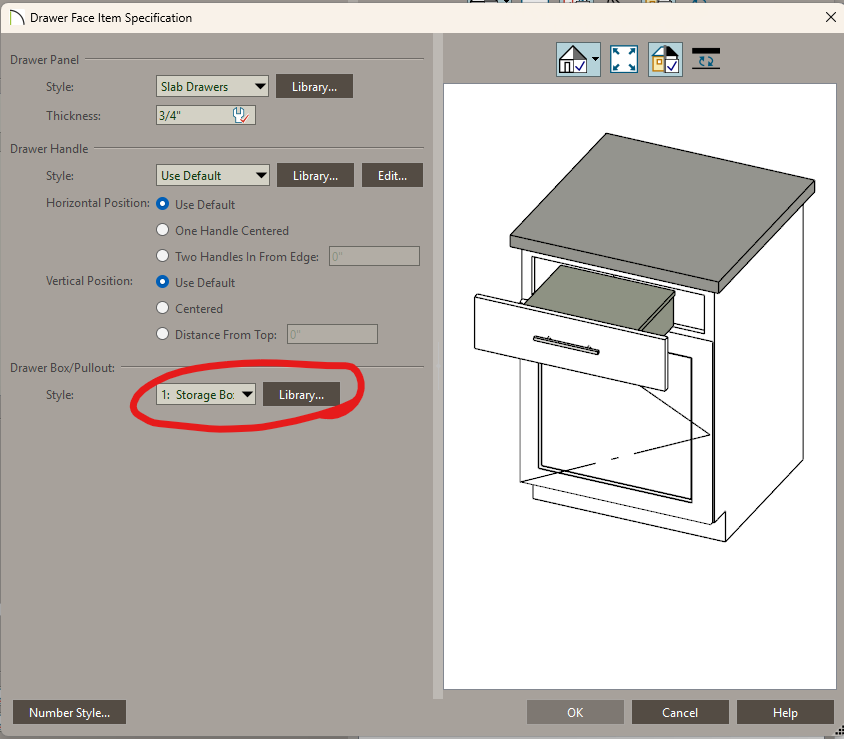

Drew-PRH Posted January 21 Author Share Posted January 21 8 hours ago, Renerabbitt said: Yes you can Any mesh can be converted into a millwork/fixture/furniture/hardware symbol category, and any of those symbol categories can be used as a drawer box: Rene, Wow - that sounds pretty easy However, I just tried that and I am using x16 on this one, and the Style Dropdown is not available from the Base Cabinet Specification: Appliance/Door/Drawer - Specify, then opens Drawer Face Item Specifications. Might you be using X17? Thanks - Drew Link to comment Share on other sites More sharing options...
DBCooper Posted January 21 Share Posted January 21 Try clicking on the "library" button. Link to comment Share on other sites More sharing options...
Drew-PRH Posted January 21 Author Share Posted January 21 15 minutes ago, DBCooper said: Try clicking on the "library" button. Got it - Thank you. I did try that before and looking for storage box but had no results come up. Closed and opened back up, and found it. How odd. Thank you!! Link to comment Share on other sites More sharing options...

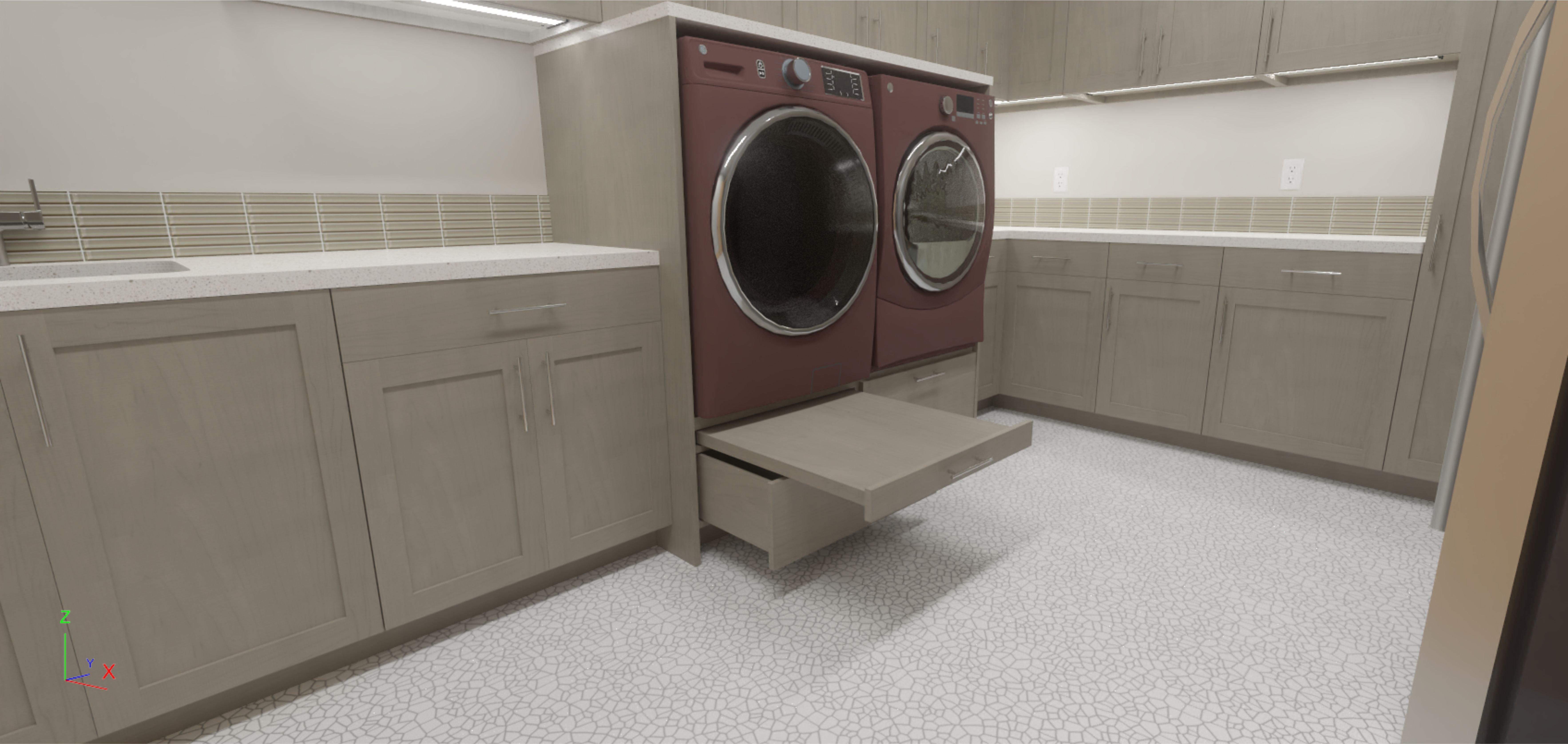

Drew-PRH Posted January 21 Author Share Posted January 21 9 hours ago, Renerabbitt said: Yes you can Any mesh can be converted into a millwork/fixture/furniture/hardware symbol category, and any of those symbol categories can be used as a drawer box: Success - Thanks Rene. After I located the 'Storage Box' (CA was not finding it the first time I tried - closed, open, found it) I saved the 'Storage Box' to User Catalog', Changed some dimensions and materials - Voilà 1 Link to comment Share on other sites More sharing options...
