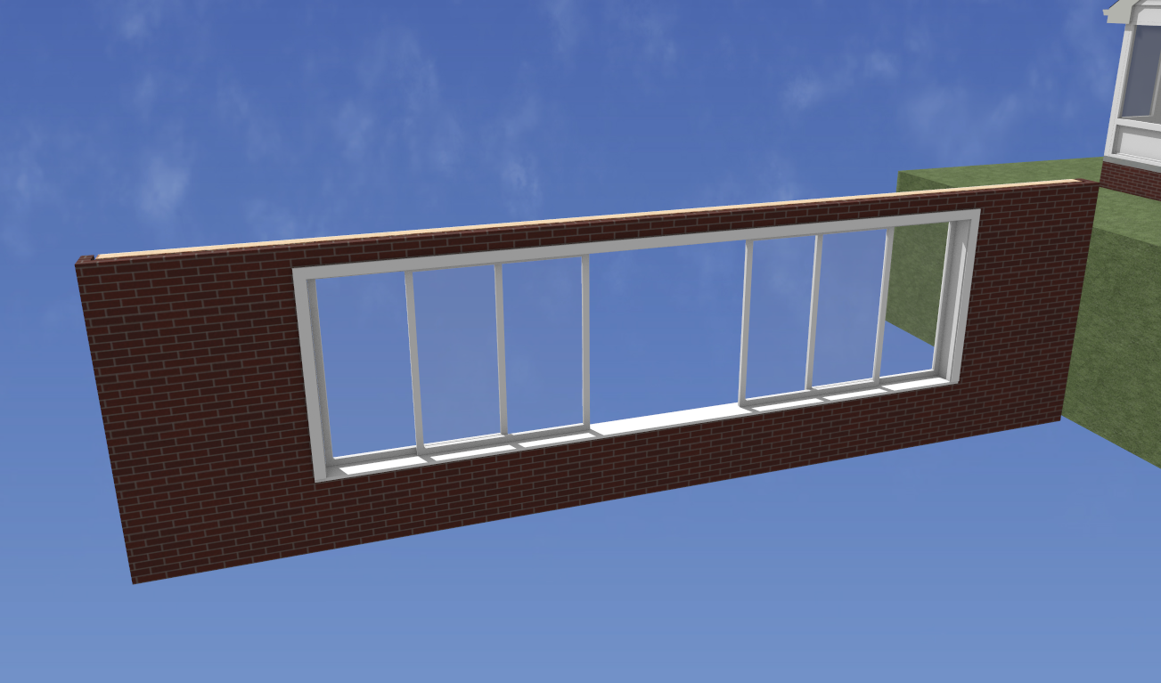

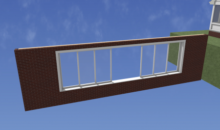

capitaldesigns Posted January 9 Share Posted January 9 I am working on a house that the client wants a 18'-0"x5'-0" quadruple sliding window OXXO. She wants the two inside panels to slide outwards over two fixed panel. I see that Chief has a triple sliding window XOX but no quadruple windows under it window types. Does anyone no how to make a quadruple window? Thanks, Mike Link to comment Share on other sites More sharing options...
JKEdmo Posted January 9 Share Posted January 9 3 minutes ago, capitaldesigns said: I am working on a house that the client wants a 18'-0"x5'-0" quadruple sliding window OXXO. She wants the two inside panels to slide outwards over two fixed panel. I see that Chief has a triple sliding window XOX but no quadruple windows under it window types. Does anyone no how to make a quadruple window? Thanks, Mike Could you do it as a 4-panel sliding door and schedule it out as a window? 1 Link to comment Share on other sites More sharing options...
capitaldesigns Posted January 10 Author Share Posted January 10 That works. I tried rescheduling a door as a window. Thanks, Mike Link to comment Share on other sites More sharing options...
