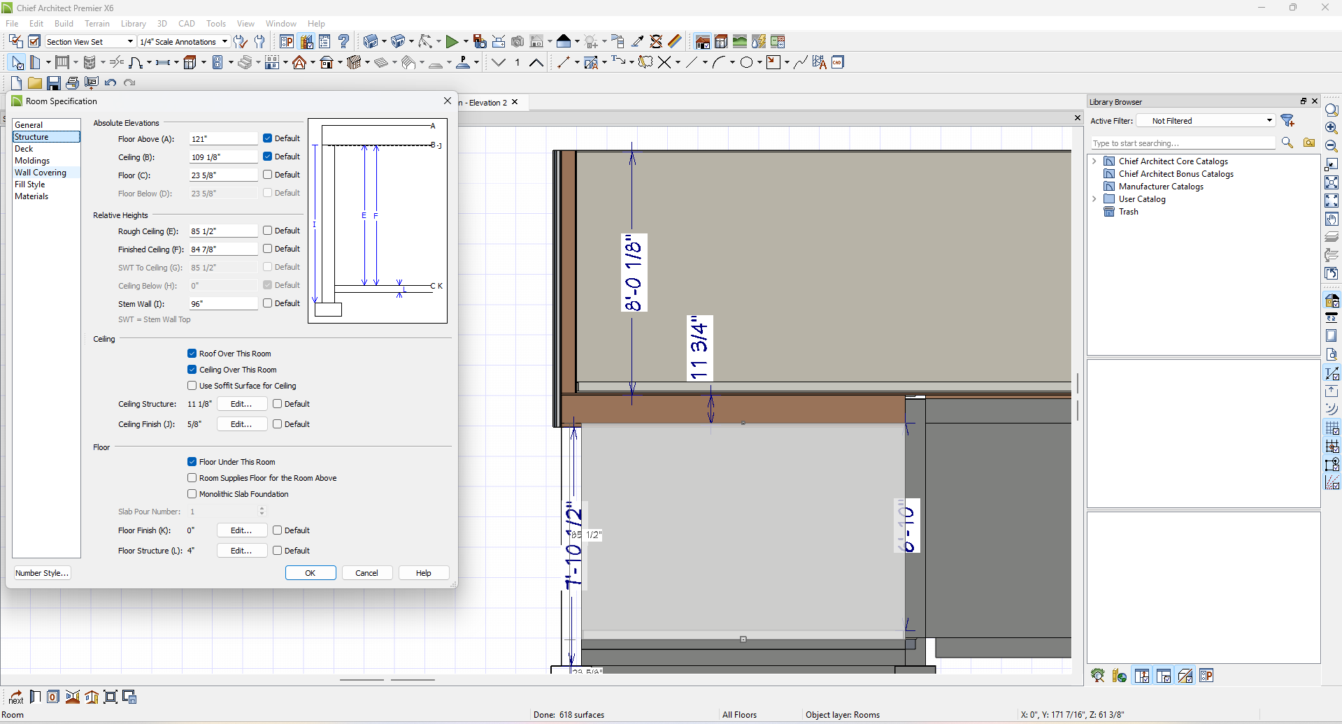

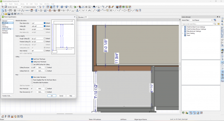

Stem wall needs to be 96 from footing to top on left side.
Ledger on the right.  11 1/8" TGI
FF In basement needs to be 84 from ceiling.
Every time I input the numbers it auto changes something else...?
Suggestions please.
Thank you, Jake

Possible Issue 1:
I find that if your entire basement is not at the same elevation and ceiling heights, then any rooms that you try and make different, must have a corresponding room on the main floor with the main floor walls over top of the basement walls
Issue 2: Set the absolute elevations, then set the stem wall.
or post a video of the issue, and/or the plan
