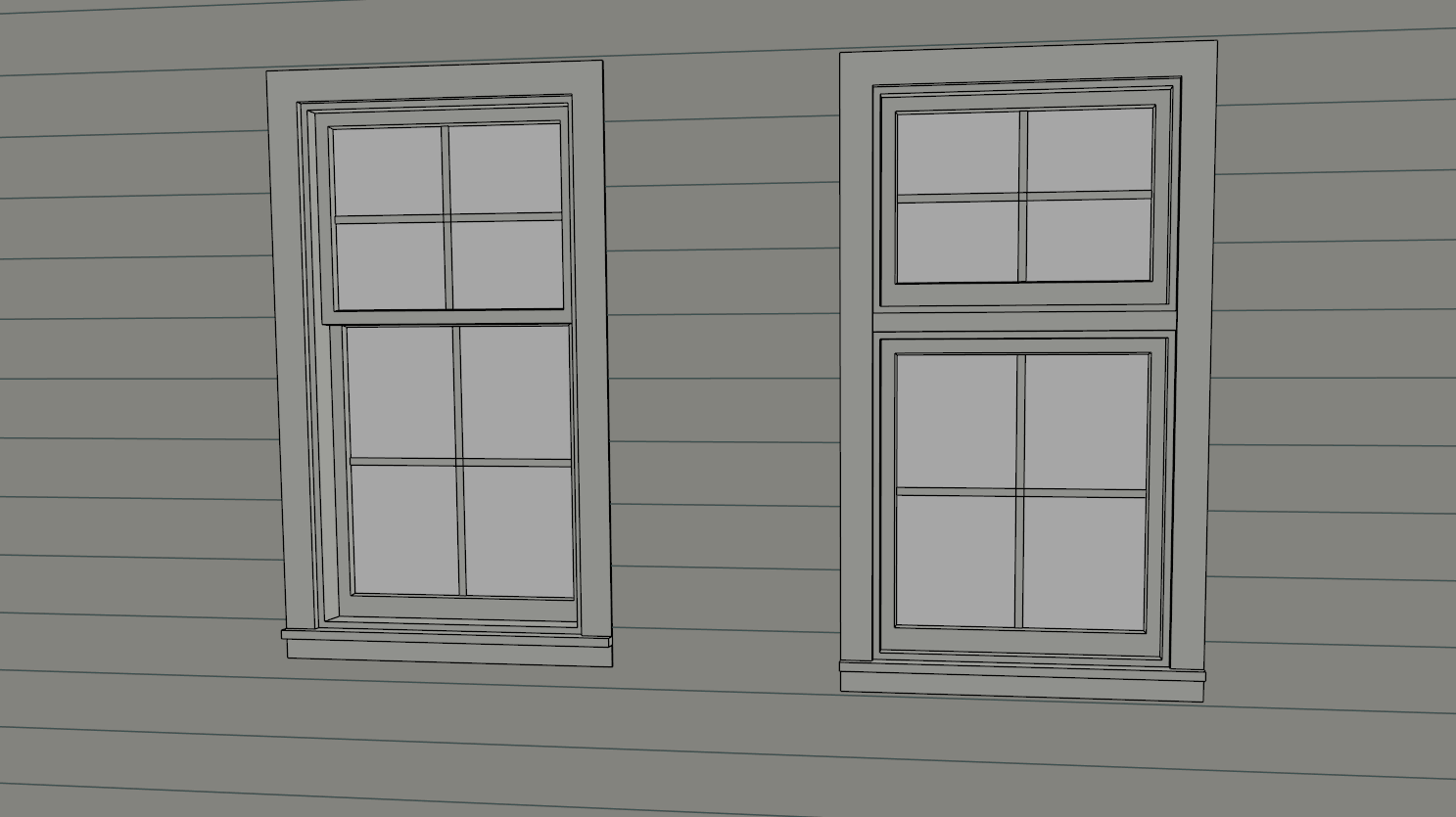

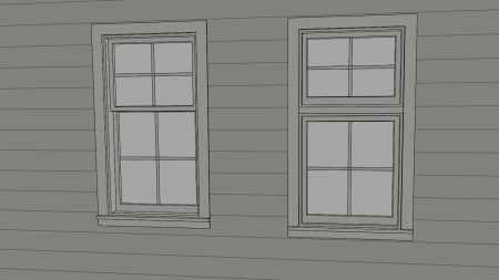

DBCooper Posted November 14, 2025 Share Posted November 14, 2025 First, it's better to put pictures directly into your posts instead of making people download a pdf. Second, your picture is too small to be able to see many details. There are at least two ways to model a window like that. One way is to make a double hung window and then set the "component size" so that the lower portion is bigger than the upper portion. The other way is to model two separate windows stacked on top of each other and then block them into a mulled unit. In the picture below, the window on left is using the component size and the window on the right is a mulled unit. I would use the technique that matches the real world one the closest. 1 Link to comment Share on other sites More sharing options...
