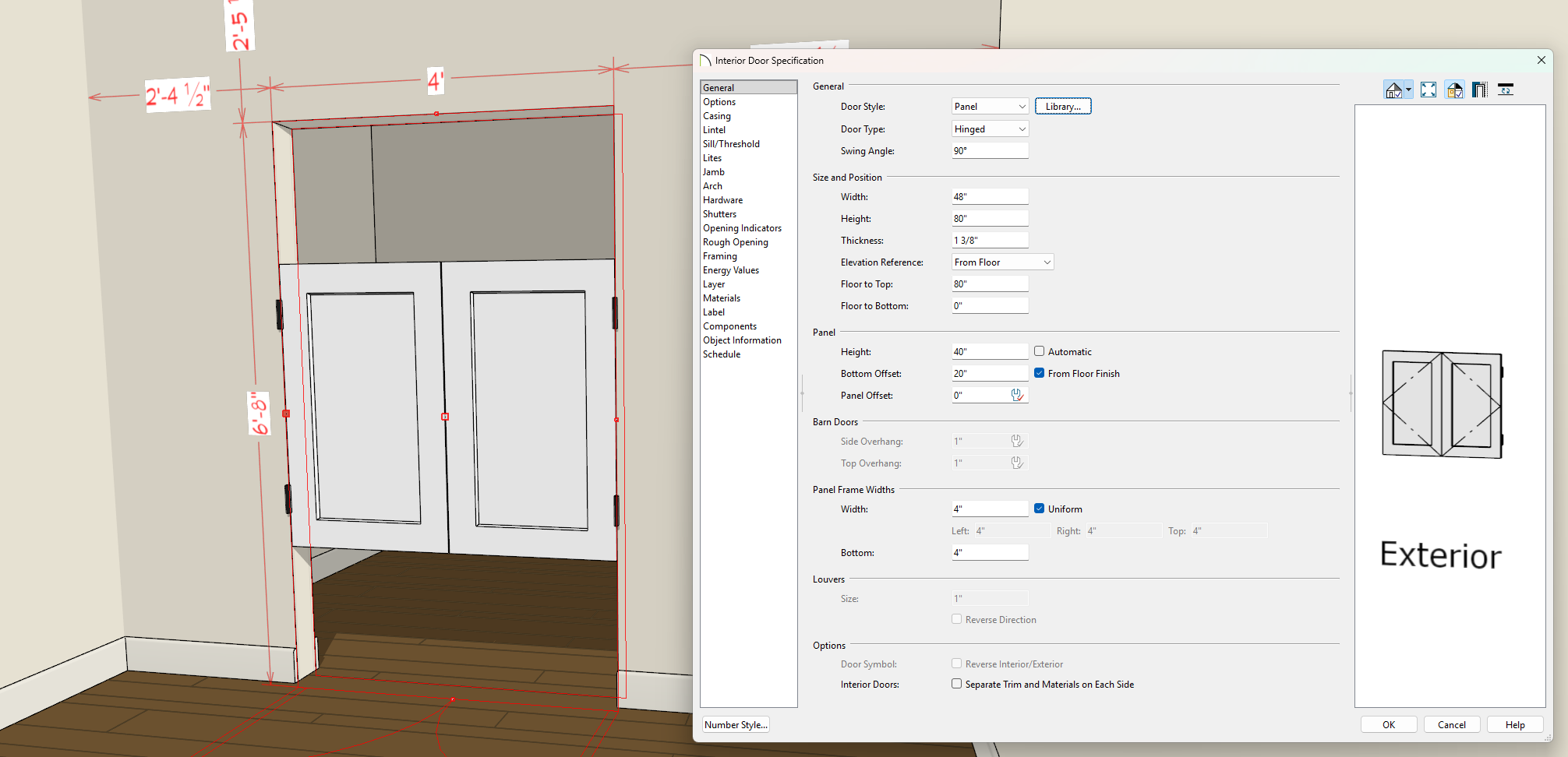

Here''s a symbol I found on 3D Warehouse...  https://3dwarehouse.sketchup.com/model/af5ddf24f638a55de1eaadd907cc5148/Cafe-Doors
The important thing to remember is if you classify it as a fixture when you import it into Chief, you can easily control the position of the doors when you place it in a doorway. If you classify it as a door then you will need to delete the casing and jamb so that you are left with just the door to position in a previously placed doorway.
Link to comment
Share on other sites
You can use any door panel symbol you want and then just raise the bottom (by setting the bottom offset) and lower the top (by setting the panel height) so that the panel is smaller than the opening.  I couldn't find a door panel that looked like your picture but it should be pretty easy to make one using poly solids or whatever.
