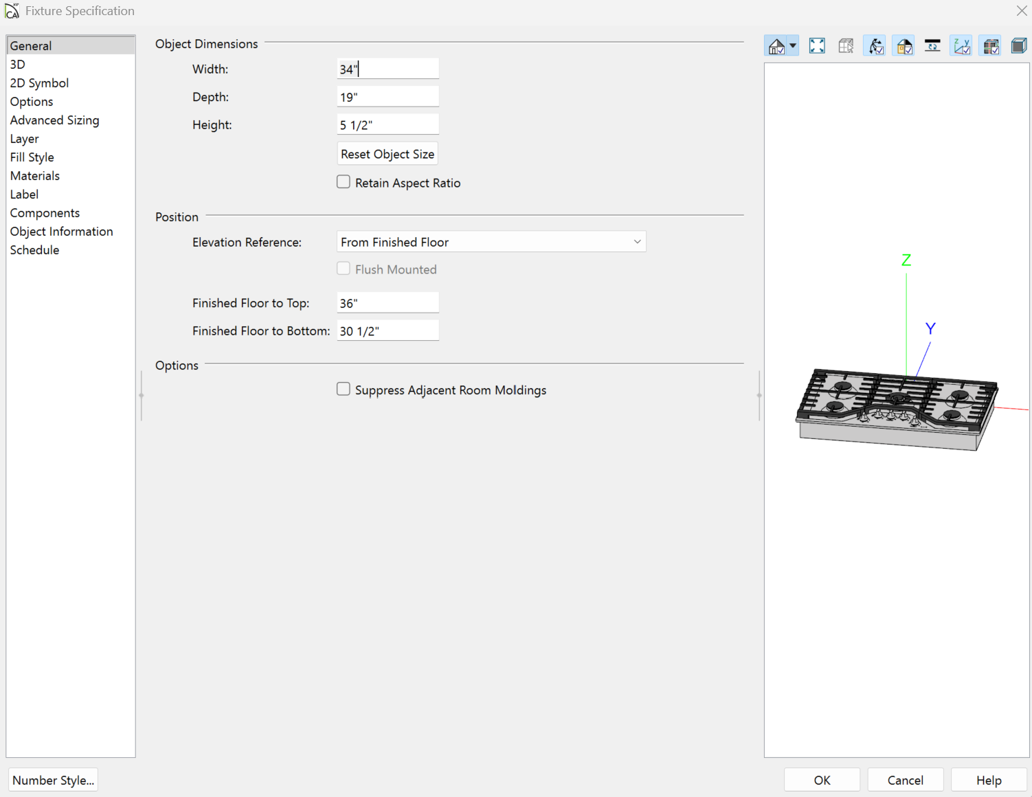

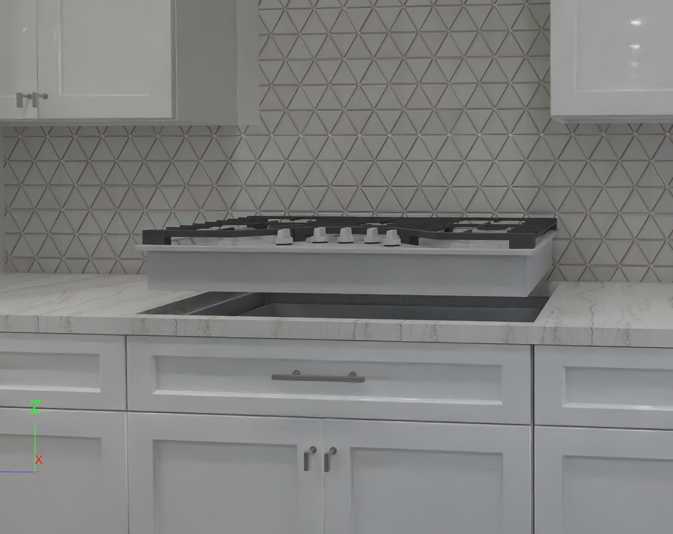

Breeze_Design Posted October 26, 2025 Share Posted October 26, 2025 (edited) I've imported a cad symbol for a 36" gas cooktop - it looks good but I can't figure out why its sitting above the counter. What setting do I need to change to get it drop drop into the countertop? Edited October 26, 2025 by Breeze_Design typo as usual !! Link to comment Share on other sites More sharing options...

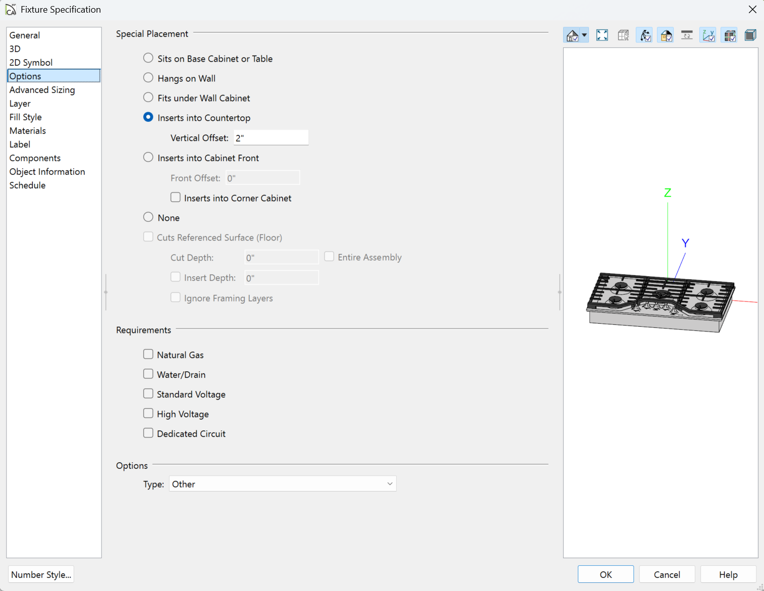

DBCooper Posted October 26, 2025 Share Posted October 26, 2025 Gene's solution is how you had to do it in older versions. You don't need to mess with the 3D data anymore. Under "options", you already have "inserts into countertop", now all you need to do is set the "vertical offset" to something more appropriate, like -3". You have it set to float 2" above the countertop currently. Link to comment Share on other sites More sharing options...
