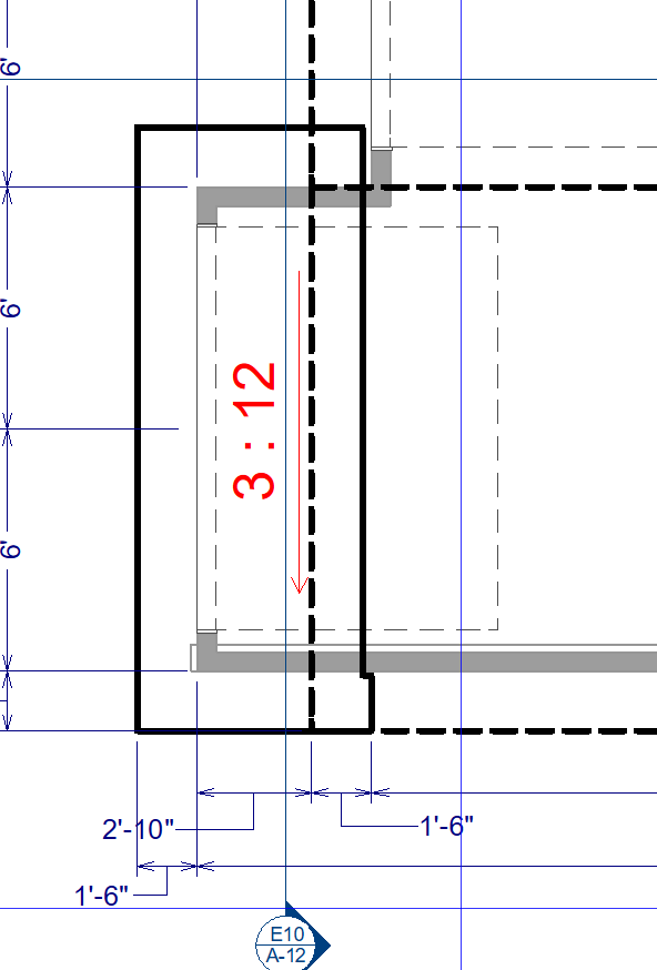

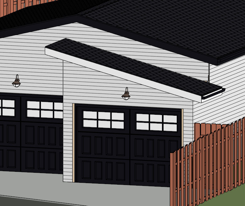

SHCanada2 Posted October 23, 2025 Share Posted October 23, 2025 (edited) The roof plane edge will not follow the dimension I give it, it goes back to either what looks like the exterior of the cladding (the walls have 1" exterior foam) or it allow me to move the roof plane into the attcic. The problem is I have to specify to the stud for the truss guys. So I created a little jog on the eave. IS there a trick here? Even if I could move the roof plane to the stud, then the exterior render shows the framing as the roof then cuts the siding and 1" insulation off the elevation view. Even if I use the cntrl key it will not place the edge at 18". maybe because there is an attic wall there? 23.10.2025_00.04.13_REC.mp4 Edited October 23, 2025 by SHCanada2 Link to comment Share on other sites More sharing options...

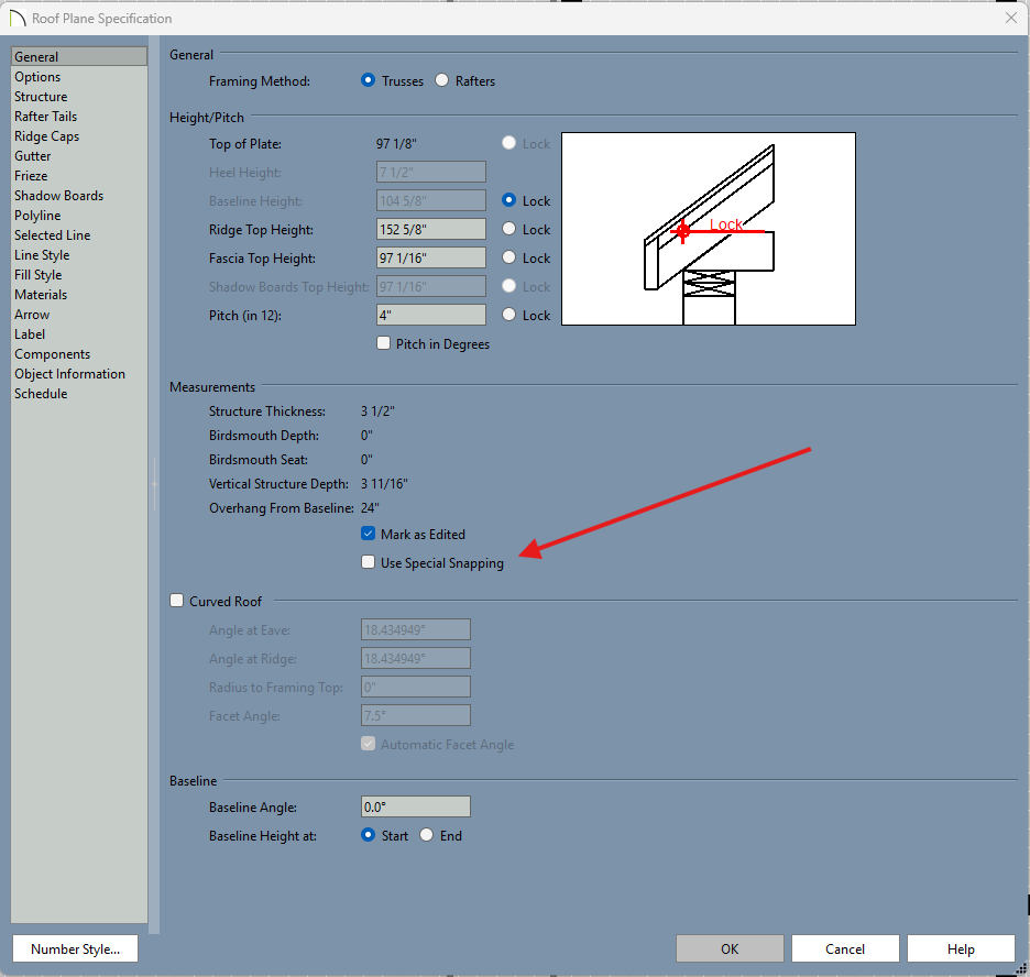

Solution robdyck Posted October 23, 2025 Solution Share Posted October 23, 2025 Link to comment Share on other sites More sharing options...
PitMan71 Posted October 23, 2025 Share Posted October 23, 2025 What Robert said. Gotta uncheck that box. 1 Link to comment Share on other sites More sharing options...
SHCanada2 Posted October 24, 2025 Author Share Posted October 24, 2025 yes that worked, thanks Robert 1 Link to comment Share on other sites More sharing options...
