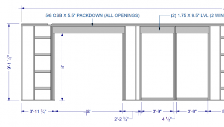

GeneDavis Posted October 13 Share Posted October 13 I am going through a job wall by wall after generating framing, to edit and annotate, so the job can be sent out to the panelizer plant. When opening some of the walls, I see points all around, that somehow got generated, by the program, not me. See the screencap. Look around and you'll see four points down below the bottom dimnsion line. When these occur, they are in locations that have nothing to do with any dimensioning or anno work I've done. Sometimes in window or door openings, sometimes up above top plates. What's causing this? Link to comment Share on other sites More sharing options...
robdyck Posted October 13 Share Posted October 13 (edited) Presumably the wall framing is being rebuilt. Chief's rebuilding deletes it all and replaces it all. The dimension extensions that located something that got deleted then get replaced with point markers. Why not all of them and only some? I bet no one can answer that. Edited October 13 by robdyck Link to comment Share on other sites More sharing options...
