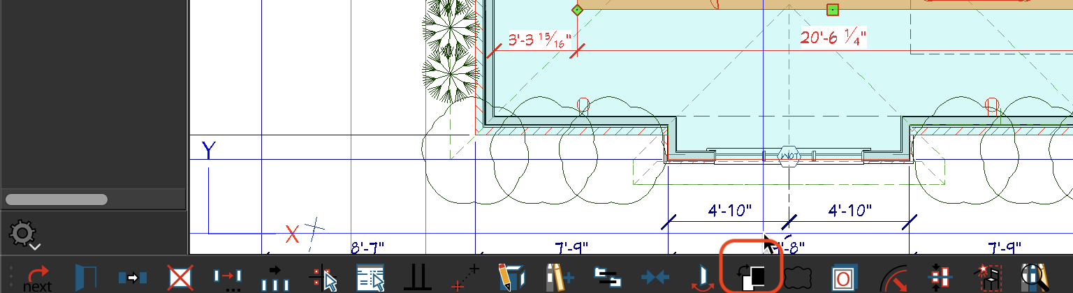

ElainesDesign Posted October 9, 2025 Author Share Posted October 9, 2025 I want to show it on the working plan view as under the table - how do I do that there is a way on chief to bring to front or back? Link to comment Share on other sites More sharing options...
PitMan71 Posted October 9, 2025 Share Posted October 9, 2025 Yes. Click on object, You will find the tool at the bottom. It give you the option to bring to front or back. Have a go. Link to comment Share on other sites More sharing options...
