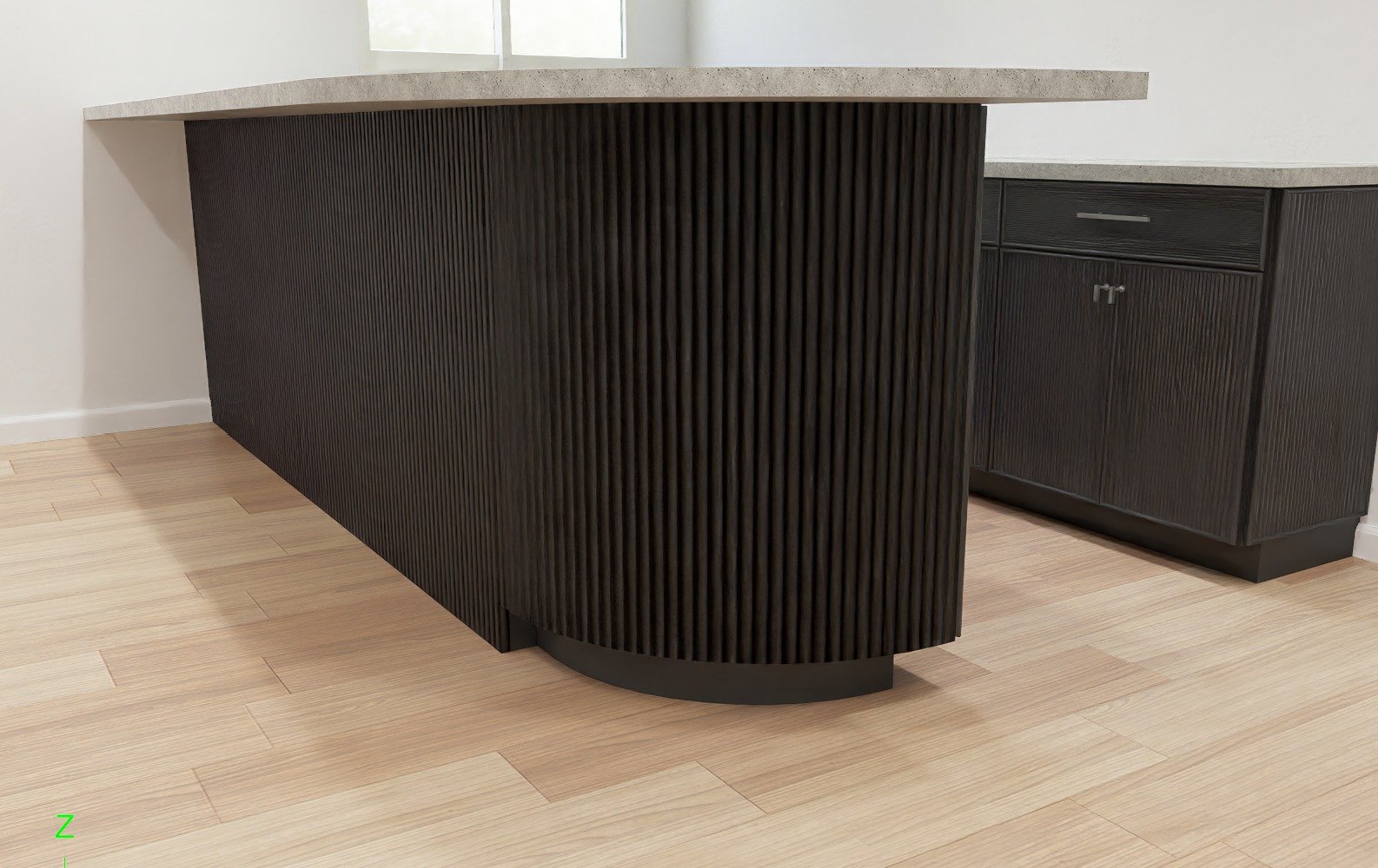

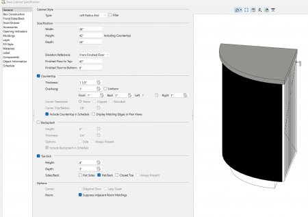

Breeze_Design Posted October 7, 2025 Share Posted October 7, 2025 Is there a way to remove the toe kick on the curved side of this cabinet? Ticking flat sides achieves nothing Link to comment Share on other sites More sharing options...
DBCooper Posted October 7, 2025 Share Posted October 7, 2025 Maybe set the toe kick depth to 0? Link to comment Share on other sites More sharing options...
Breeze_Design Posted October 8, 2025 Author Share Posted October 8, 2025 4 hours ago, DBCooper said: Maybe set the toe kick depth to 0? Thanks for the suggestion, but unfortunately that would remove it from the front as well - there is a door along that side that matches the other cabinets Link to comment Share on other sites More sharing options...
Joe_Carrick Posted October 8, 2025 Share Posted October 8, 2025 (edited) Create a "Slab" or "Solid" of the desired base size and place the Cabinet (without a base) on top of that. Edited October 8, 2025 by Joe_Carrick Link to comment Share on other sites More sharing options...
