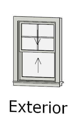

basketballman Posted Tuesday at 02:28 PM Share Posted Tuesday at 02:28 PM Is there a way to lose the arrows ? Link to comment Share on other sites More sharing options...
Rpadge Posted Tuesday at 02:46 PM Share Posted Tuesday at 02:46 PM (edited) In the Window Spec DBX theres a setting for Opening Indicators (between shutters and rough opening), you can also turn them off in ALDO Edited Tuesday at 02:47 PM by Rpadge Link to comment Share on other sites More sharing options...
basketballman Posted Tuesday at 03:28 PM Author Share Posted Tuesday at 03:28 PM thank you very much i should have looked closer, Link to comment Share on other sites More sharing options...
DBCooper Posted Tuesday at 04:05 PM Share Posted Tuesday at 04:05 PM (edited) Just to add to what Robert said... If you don't want to see them for one particular window/door, then you can open the dialog and turn them off on the "opening indicators" page. If you don't want to see them for one particular type of window/door, then you can turn them off in your window/door defaults. There are also separate settings for hinged versus sliding windows. If you don't want to see them for one particular view, then you can turn them off in your layer display options. This will also affect cabinets though. Edited Tuesday at 04:27 PM by DBCooper Link to comment Share on other sites More sharing options...
