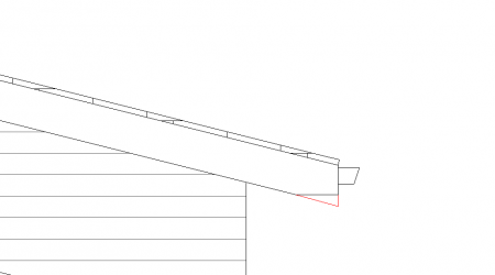

SHCanada2 Posted September 21, 2025 Share Posted September 21, 2025 would like it to look like the red below. I tried all the combinations under roof plane->options->eave but could not find something that does per below: Link to comment Share on other sites More sharing options...
Solution robdyck Posted September 21, 2025 Solution Share Posted September 21, 2025 Use a shadow board...gables only. Link to comment Share on other sites More sharing options...
SHCanada2 Posted September 21, 2025 Author Share Posted September 21, 2025 (edited) thanks, that worked Edited September 21, 2025 by SHCanada2 Link to comment Share on other sites More sharing options...

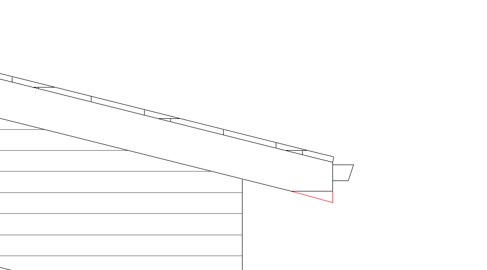

CAmichael240114 Posted September 21, 2025 Share Posted September 21, 2025 The "eaves" fascia or sub fascia is smaller than the gable fascia Link to comment Share on other sites More sharing options...
SHCanada2 Posted September 21, 2025 Author Share Posted September 21, 2025 46 minutes ago, CAmichael240114 said: The "eaves" fascia or sub fascia is smaller than the gable fascia ah, are you saying that is what controls that? i.e. if I made the subfascia the same height as the fascia, then the facia board would not get cut horizontally like I show? interesting Link to comment Share on other sites More sharing options...
