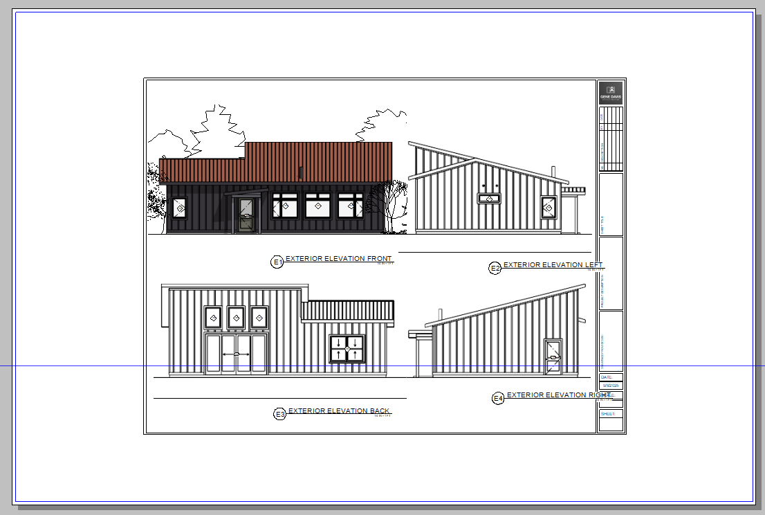

GeneDavis Posted September 8, 2025 Share Posted September 8, 2025 I realized too late that I had selected an ARCH B but now need the ARCH C template. Show me the way, please. The pic is showing the layout set on ARCH C paper. I need the ARCH C borders, title boxes, etc. Link to comment Share on other sites More sharing options...
Rookie65 Posted September 8, 2025 Share Posted September 8, 2025 Just drag the border lines closer to the edge of the paper. Then marquee around the title block and slide it to the right. Very simple Link to comment Share on other sites More sharing options...
DBCooper Posted September 8, 2025 Share Posted September 8, 2025 You can't change the template for plans or layouts once they have been started. You can start a new layout using the right template and then copy everything over. You can also just resize the drawing sheet and then just remove the borders and title block and copy them over from the right template. Either way is a bit of work but not too much. Link to comment Share on other sites More sharing options...
