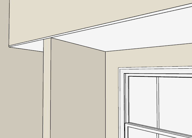

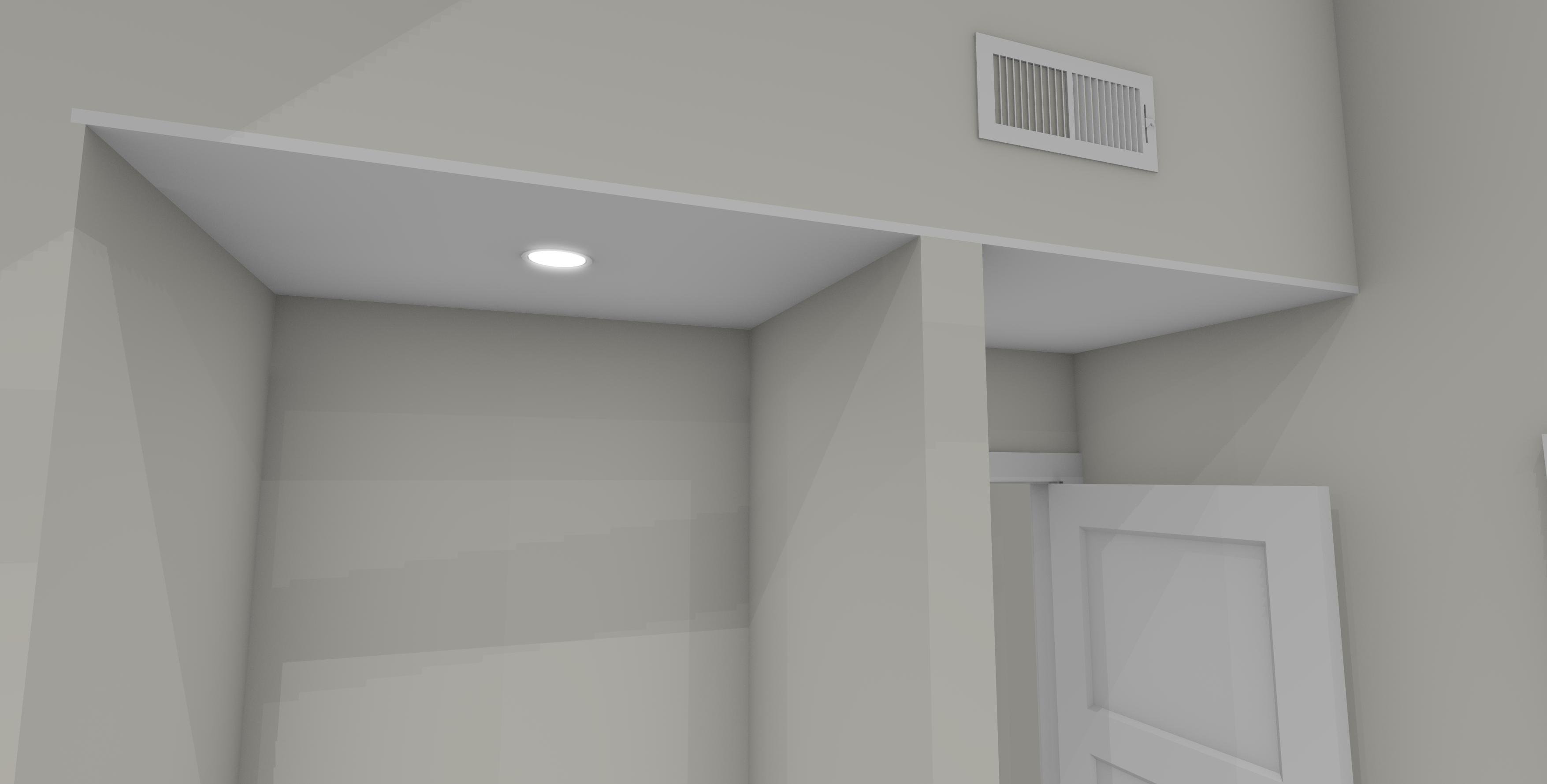

33DegreesNorth Posted September 6, 2025 Share Posted September 6, 2025 Does anyone have any idea how I might close up or complete that small section of wall so it doesn't show the drywall ceiling gap? Thank you! Link to comment Share on other sites More sharing options...
PitMan71 Posted September 6, 2025 Share Posted September 6, 2025 There might be a better way, BUT I just had a go at it and if you change the wall to a Furred Wall on the Structure Panel it will go away. The downside is so will you base moulding which can be easily added back with a moulding poly line. If there is another way to fix this I don't know of one. Might be worth elevating this to support and let them have a look and see how they would solve. Link to comment Share on other sites More sharing options...

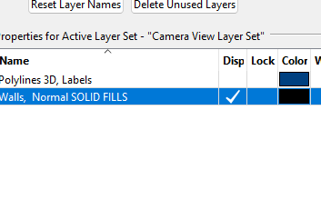

mtldesigns Posted September 6, 2025 Share Posted September 6, 2025 1 hour ago, 33DegreesNorth said: so it doesn't show the drywall ceiling gap In my temp-plate I have a layer called "Walls, Normal SOLID FILLED".. and in case like this, its a a simple solid, drywall material, placed via a section view. This has no value to the actual floor plan set, so this layer is turned off on the con docs. Its is more for a visual, and awesome camera views. I have spent time trying to figure this out, and if it's not a obvious fix, and it doesn't affect the plan.. I move on. 1 Link to comment Share on other sites More sharing options...

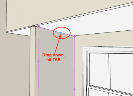

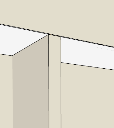

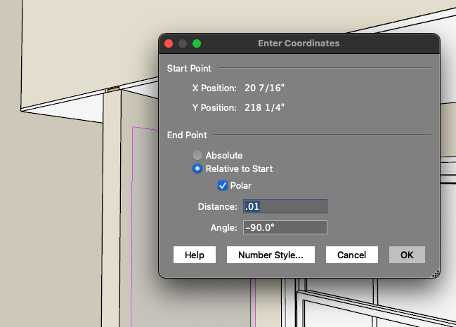

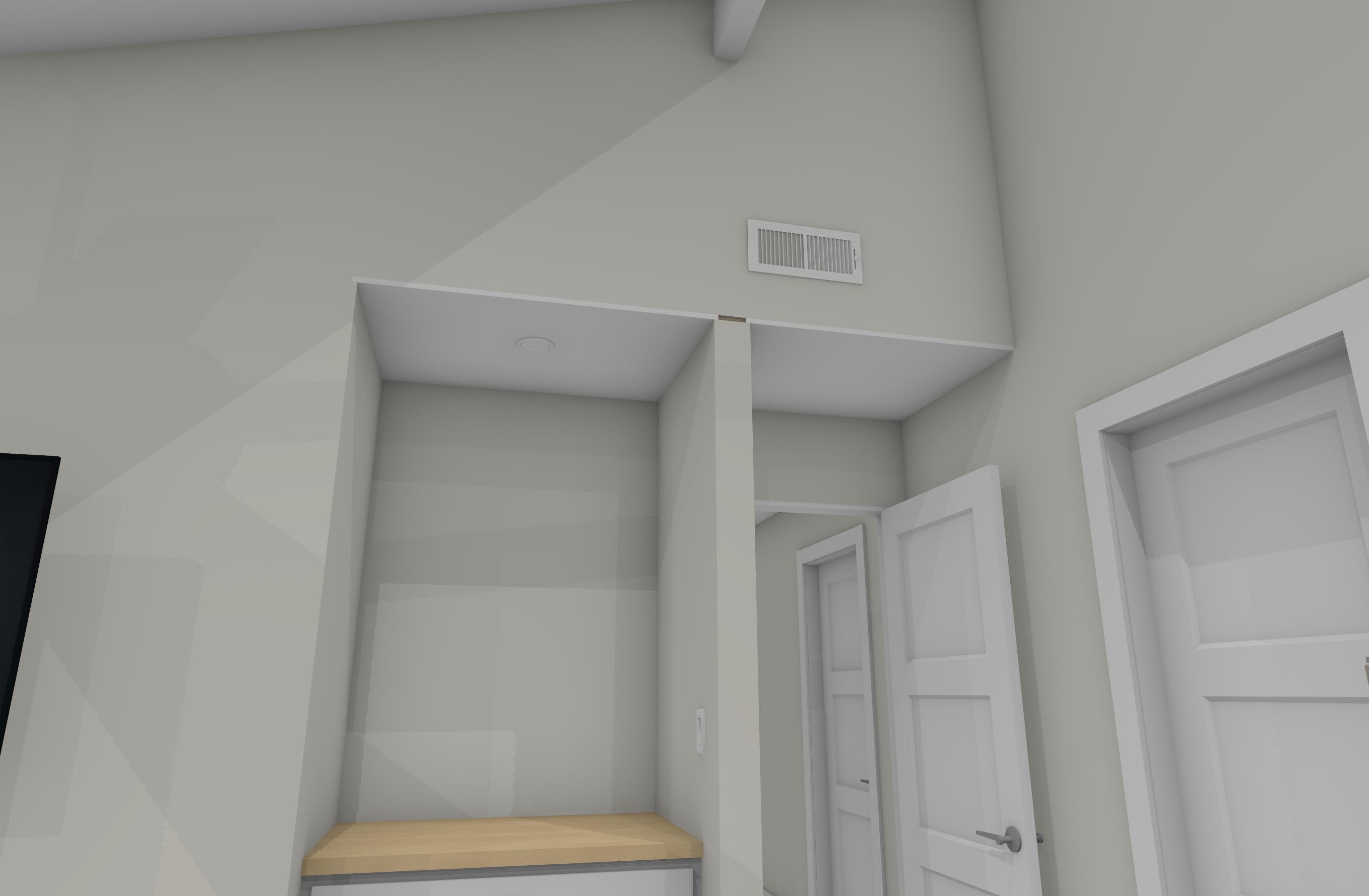

Solution Chrisb222 Posted September 6, 2025 Solution Share Posted September 6, 2025 1 hour ago, 33DegreesNorth said: Does anyone have any idea how I might close up or complete that small section of wall so it doesn't show the drywall ceiling gap? I'd just select the wall, grab the top resize handle, and pull the top down and hit TAB to bring up the move distance dialog, enter .01" and presto: 1 Link to comment Share on other sites More sharing options...
33DegreesNorth Posted September 6, 2025 Author Share Posted September 6, 2025 37 minutes ago, Chrisb222 said: I'd just select the wall, grab the top resize handle, and pull the top down and hit TAB to bring up the move distance dialog, enter .01" and presto: Thank you, that was great and easy! Any idea how to only paint the edge of that drywall? I'm a newbie, just trying to clean up minor items and learn the things I couldn't figure out! Link to comment Share on other sites More sharing options...

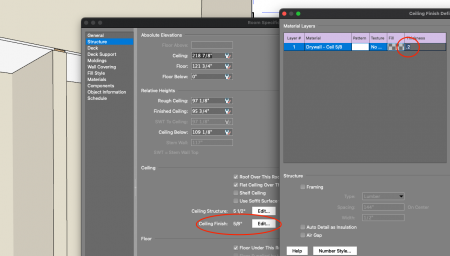

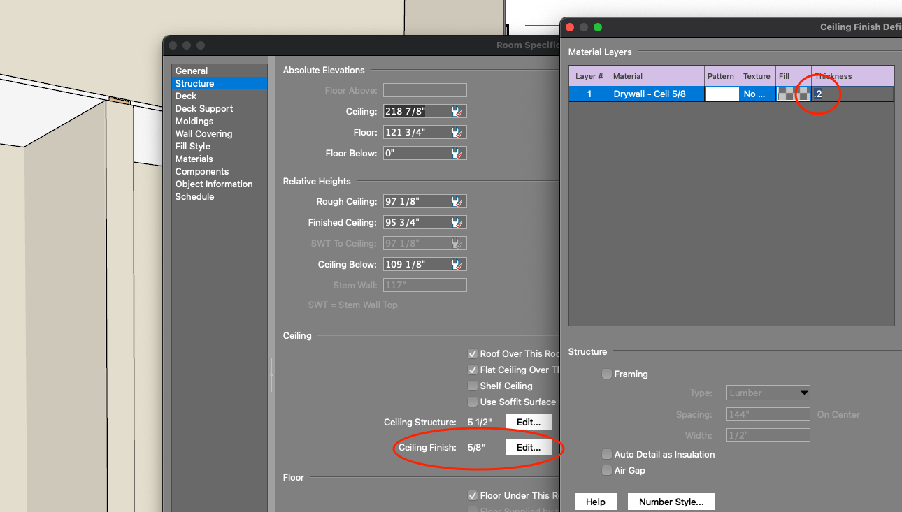

Chrisb222 Posted September 6, 2025 Share Posted September 6, 2025 6 minutes ago, 33DegreesNorth said: Any idea how to only paint the edge of that drywall? You could make the Ceiling Finish layer thinner, like .2" which interestingly will also take care of the top of wall issue: Be aware some of these solutions will alter your model and possibly cause issues / mistakes in things like framing and material list, etc. Link to comment Share on other sites More sharing options...
