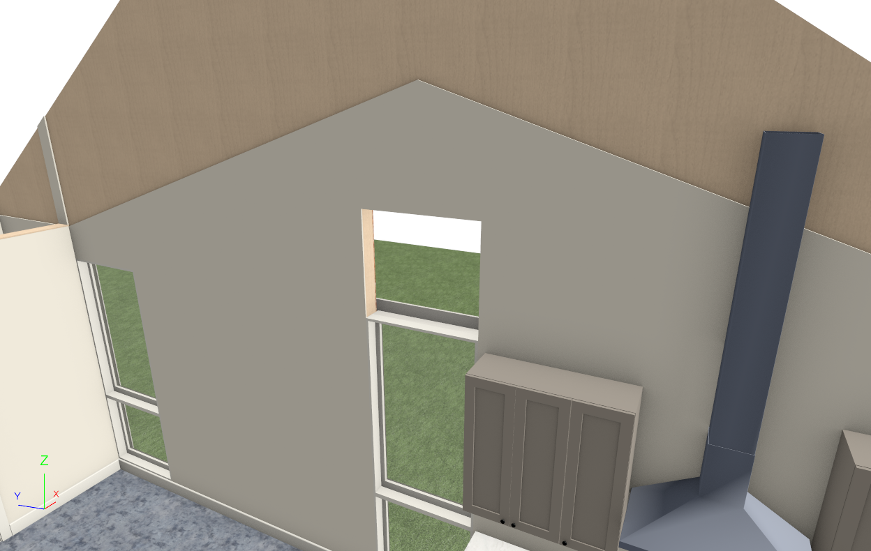

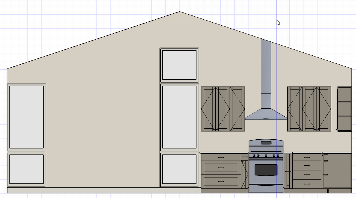

GeneDavis Posted September 5, 2025 Share Posted September 5, 2025 See the pic. The window stack at left, two windows mulled, has its top height at 8 feet in a room specified as 9/0 ceiling, no flat ceiling above. I drew ceiling planes to vault the space. The window stack at center is desired to be a three-high stack, mulled, and I cannot get the top unit to mull to the mulled stack below. I select the stack below, and shift select the top window, and I do not get the blocking option. I want the ceiling height at 9/0 to control wall heights and wall framing. Link to comment Share on other sites More sharing options...
PitMan71 Posted September 5, 2025 Share Posted September 5, 2025 Try unmulling the bottom two and see if the top two will mull. That may tell you if they may be something with that top window that's keeping it from mulling.... such as the ceiling height. I can't remember if I have ever had a three mull stack like this. I have had 2 over 2 I know. I do remember having to mull those in a particular way. Link to comment Share on other sites More sharing options...

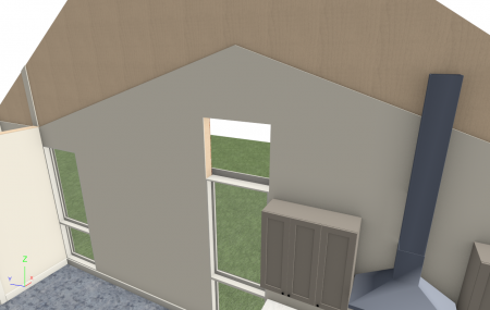

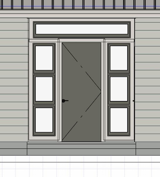

GeneDavis Posted September 5, 2025 Author Share Posted September 5, 2025 I balloon-framed the endwall and that did not do it. I unblocked the lower two, tried blocking the upper two, and that's not working. Attached is a pic of the entry door with sidelites, those done as a three-stack, and they block fine. Block two, then block the block to the other. As I said in the opener, I can get this to work by raising the room hight so the window is in the same room as the blocked unit below, but doing that raises the plate heights of the 9/0 sidewalls, something I don't want to do. I can edit the framing, I guess, but would rather this work. I can see when doing 3D floor overviews that the upper window is modeled in the attic, and not modeled on floor 1. The opening is there, but not the window. Link to comment Share on other sites More sharing options...
