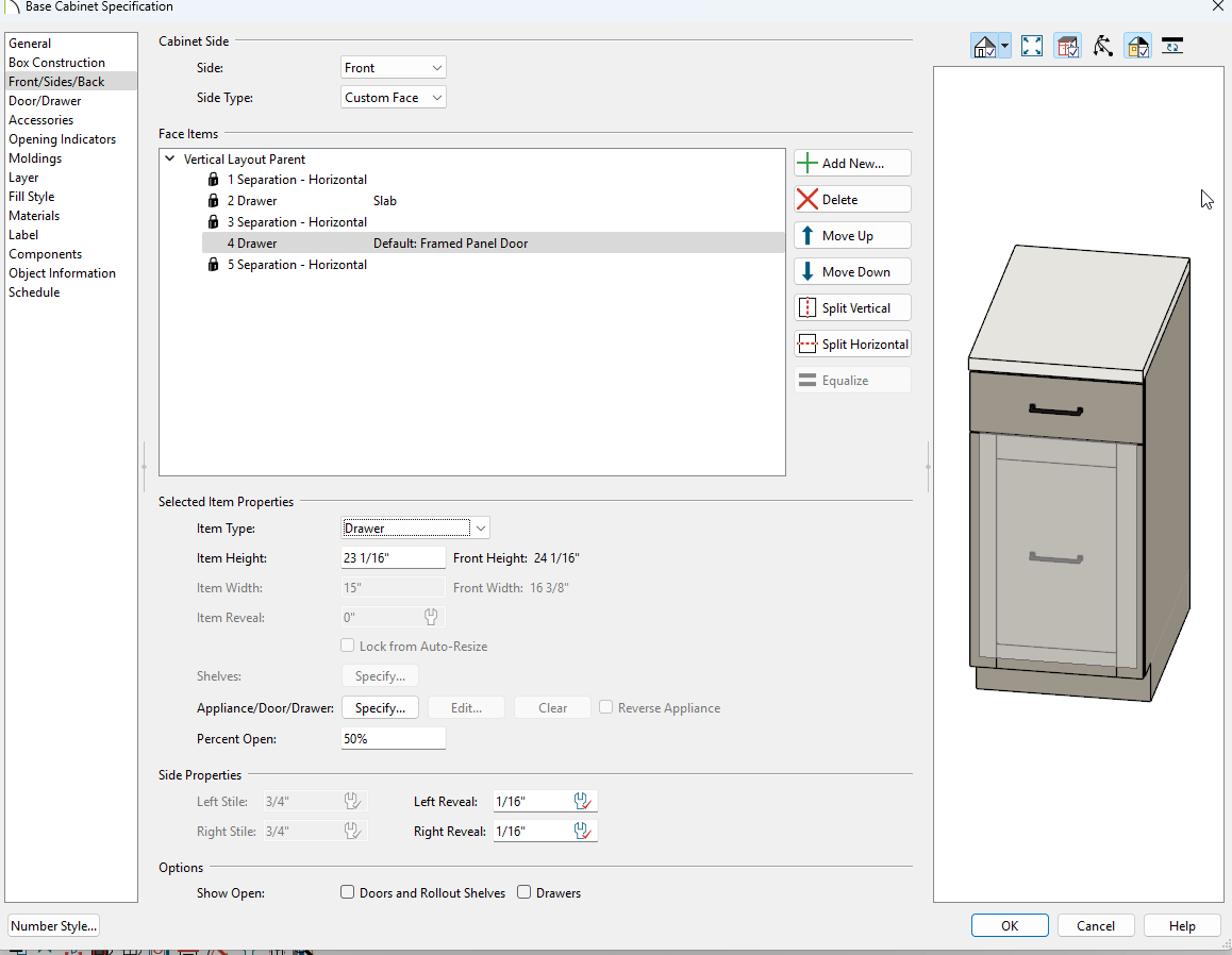

GeneDavis Posted August 16 Share Posted August 16 I know I have done this successfully before but cannot remember the method for spec. I do a trashbin pullout (Rev-a-shelf hardware) drawer in most kitchens I model. See the pic here. How do I get the handle up and onto the top rail of the paneled drawerfront, instead of the center? I cannot get a handle on it if I spec it as a door panel or drawer panel. As shown in pic, when I spec it as a drawer (which it is), I cannot move the handle where wanted without affecting the drawer above. If I spec it as a bottom hinged drawer, I get the handle where I want, but I don't want the opening indicator. Link to comment Share on other sites More sharing options...

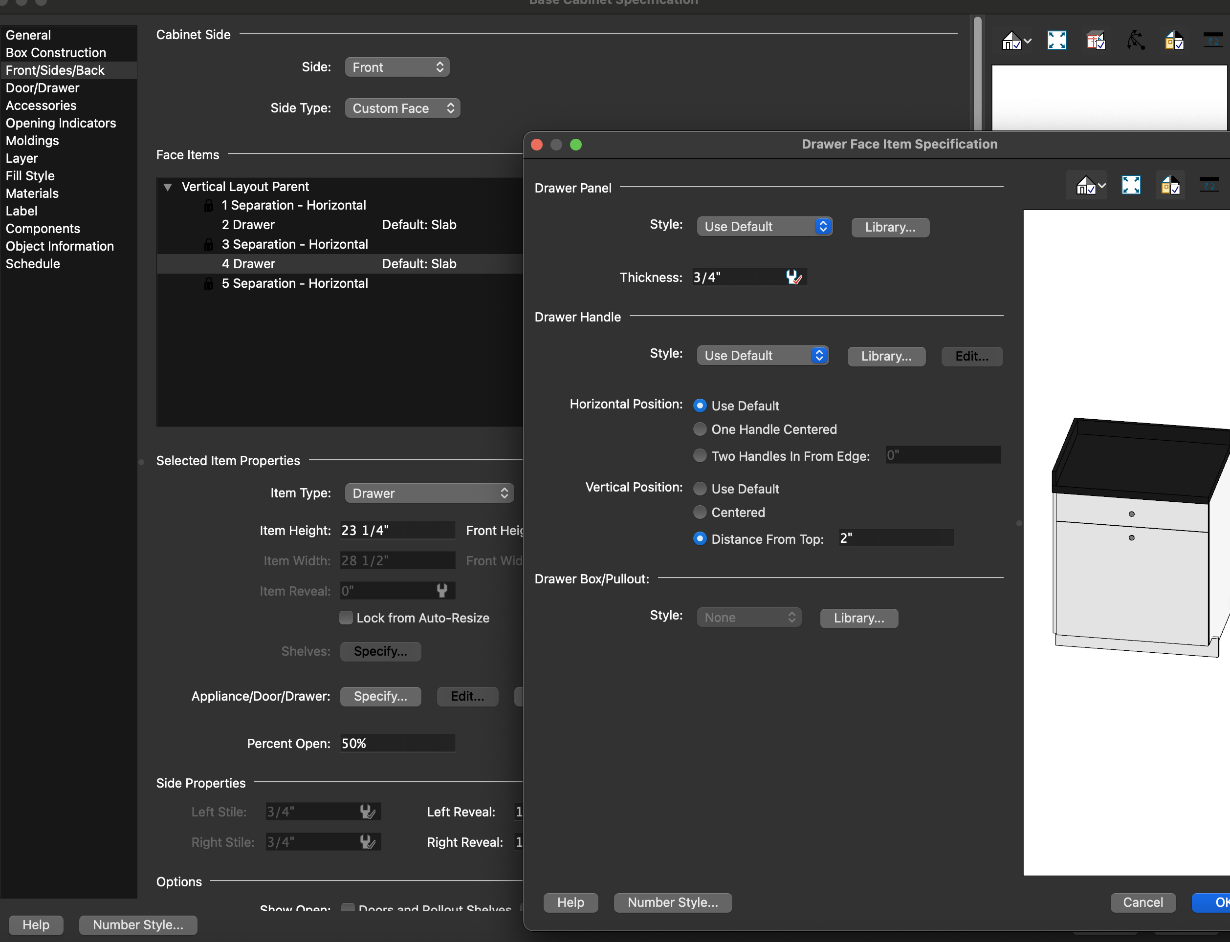

DBCooper Posted August 17 Share Posted August 17 Instead a a "drawer panel", try making it a "false drawer" and then you should be able to set the handle and position. Link to comment Share on other sites More sharing options...
Solution PitMan71 Posted August 17 Solution Share Posted August 17 2 hours ago, GeneDavis said: But I'd like to do it without the appliance. I do other appliances that aren't in libraries. When I do that I don't have to add an appliance. I simply change the bottom door to a single drawer, then click on "Specify" in the Appliance/Door/Drawer section and under Drawer Handle / Vertical position set the pull/handle 2" from the top. 1 Link to comment Share on other sites More sharing options...
