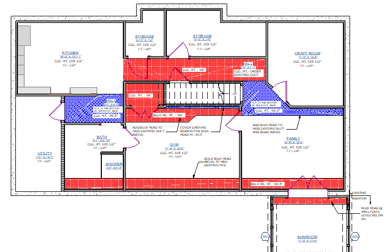

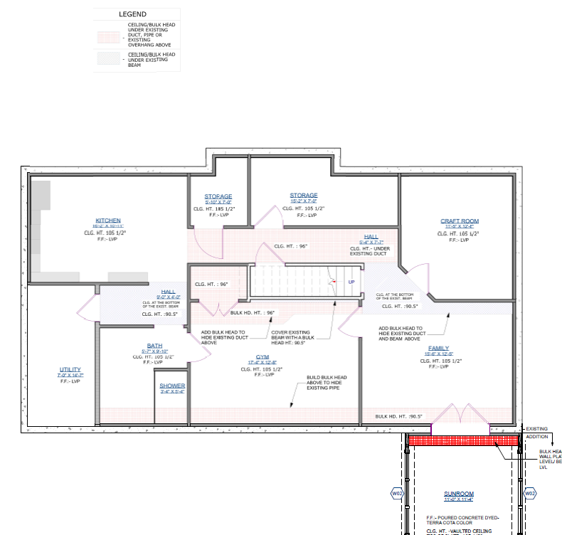

ChiefUserDennisR Posted July 30, 2025 Author Share Posted July 30, 2025 15 hours ago, VHampton said: It's probably a layer setting. Are both plan views being displayed with the same layer set options? First check and see if you've got 2 different layer designations. If so... Look for "Rooms" and see what the numerical value is. The screen grab on left is the plan view and screen grab on right is the PDF. Everything is on same Layer. Link to comment Share on other sites More sharing options...
