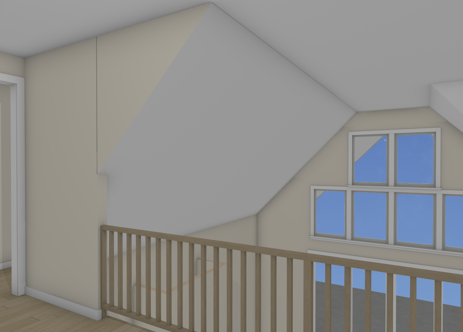

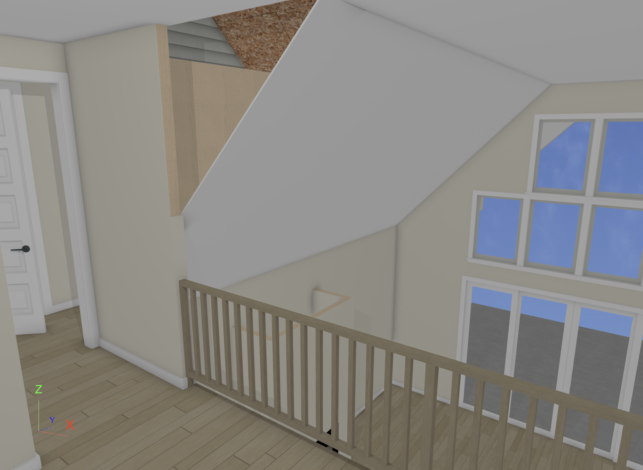

PitMan71 Posted July 21, 2025 Share Posted July 21, 2025 Hey guys How do I fill in this gap open to the attic where my ceiling plane is? I know I have solved this issue before I just can't remember what I did. This is at the top of the stairs looking toward the rear of the home. Thanks in advance for the assistance. Lake Home (Hampschire).plan.zip Link to comment Share on other sites More sharing options...
robdyck Posted July 21, 2025 Share Posted July 21, 2025 A 3d solid is the simplest. It's possible to do it with a wall but it won't necessarily be stable and it will take a very long time to get it exact. You may need to use 2 3d solids. 1 for the wallboard and 1 for the ceiling board. 1 Link to comment Share on other sites More sharing options...
tundra_dweller Posted July 21, 2025 Share Posted July 21, 2025 Yeah I was able to kind of fix it by drawing a wall off to the side the length from the end of the railing to the peak of the ceiling plane. Then changed the new little wall section to "Roof Cuts Wall at Bottom", then center on the 2x4 wall. But as Rob said it's extremely unstable with the ceiling plane wanting to snap to places you don't want it to, etc.,.Plus I still ended up with missing drywall at the railing-wall intersection. I've learned it's usually way quicker to build a solid and move on in these situations. I wish I had all the time back I've spent chasing wall-ceiling-roof intersections around and fixing gaps in materials in Chief. 1 Link to comment Share on other sites More sharing options...

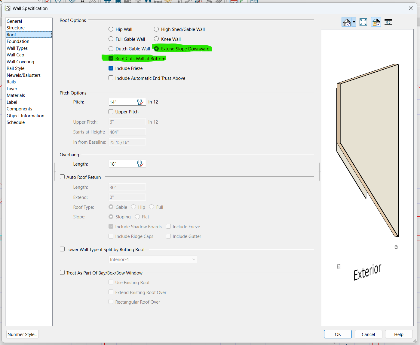

JonathanK Posted July 21, 2025 Share Posted July 21, 2025 It will need some tweaking, but I just drew a wall on the attic floor, opened it up, went to roof tab and selected "Extend Roof Downwards" and "Roof Cuts Wall at Bottom". See attached. 1 Link to comment Share on other sites More sharing options...
