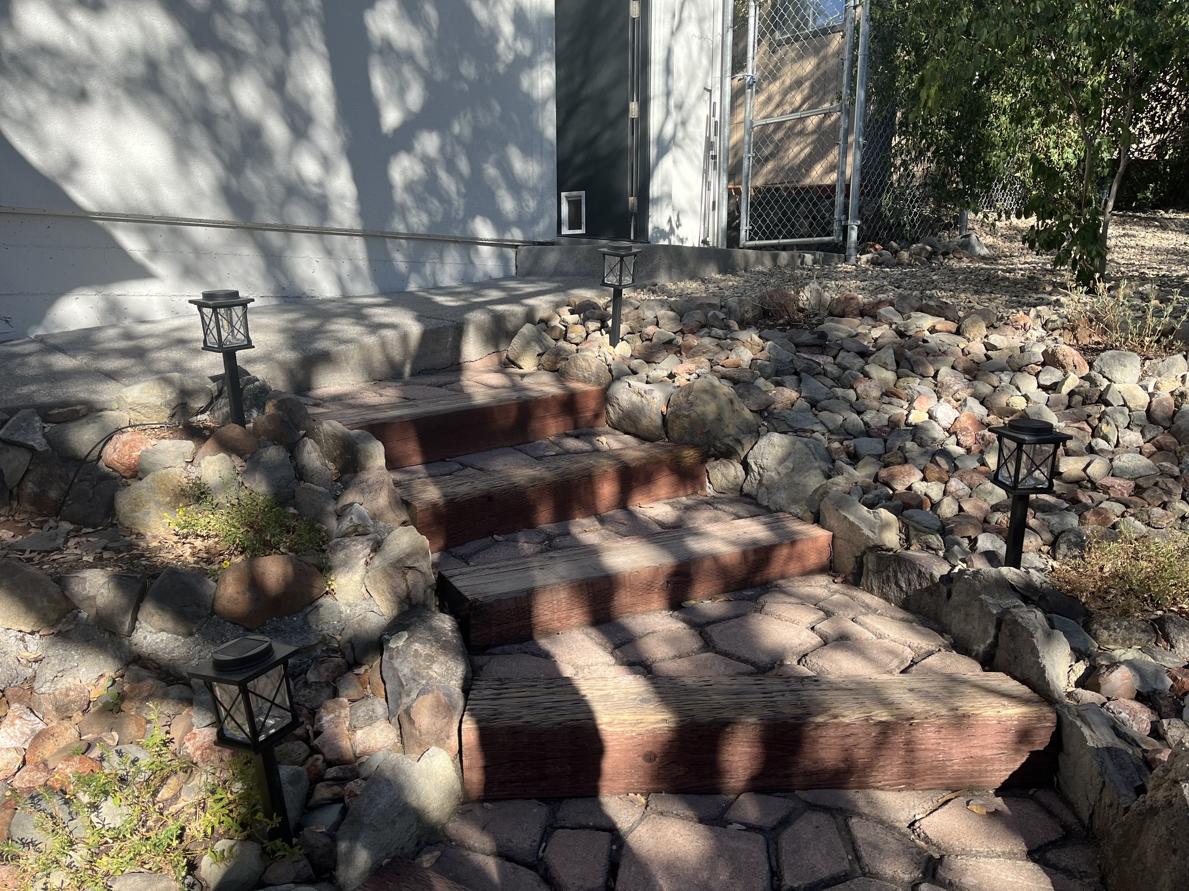

JKEdmo Posted Friday at 06:36 PM Share Posted Friday at 06:36 PM Does Chief have a site stair tool, where the stair follows/ conforms to the terrain? I need to do a railroad tie stair... How do you usually do site stairs? Do you just use the regular stair tool and finesse it? Jim Link to comment Share on other sites More sharing options...

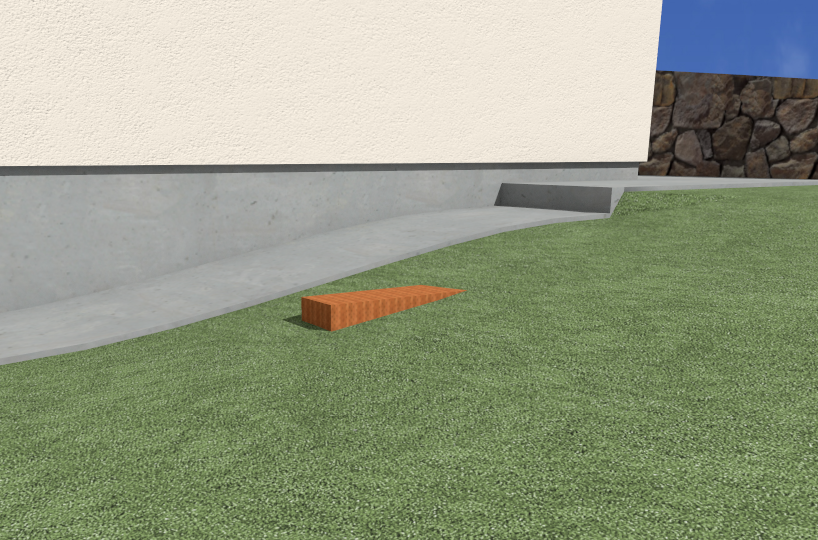

DBCooper Posted Friday at 07:31 PM Share Posted Friday at 07:31 PM The short answer is no, the regular stair won't conform to your terrain. You could probably manually adjust the heights to get what you want. Another thing you could try using is a distribution path with the railroad tie as the object. If it is set to follow terrain, it should look pretty close. I made my railroad ties below just using a soffit. 1 2 Link to comment Share on other sites More sharing options...
JKEdmo Posted Friday at 07:50 PM Author Share Posted Friday at 07:50 PM 18 minutes ago, DBCooper said: Another thing you could try using is a distribution path with the railroad tie as the object. Thanks. I did not know about that tool. I'll give it a try! Jim Link to comment Share on other sites More sharing options...
