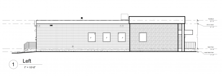

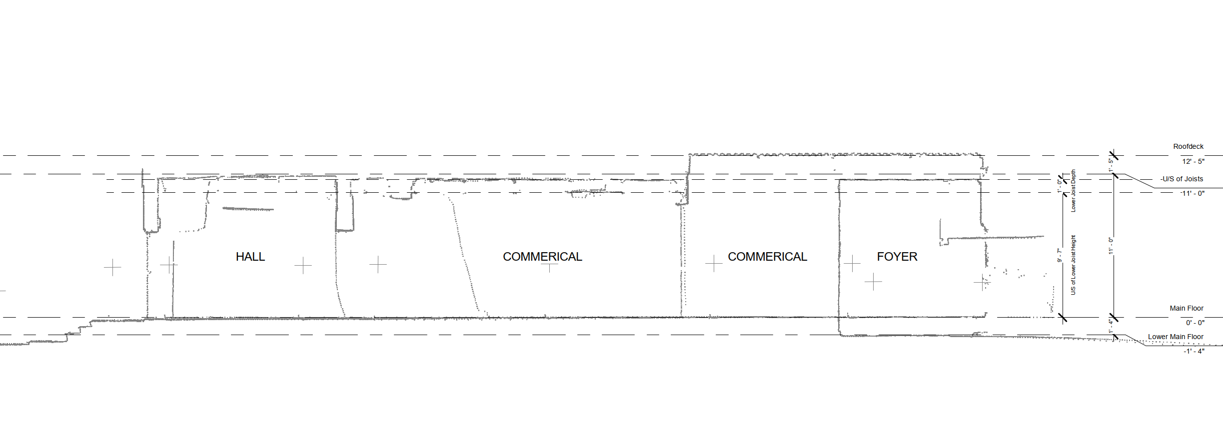

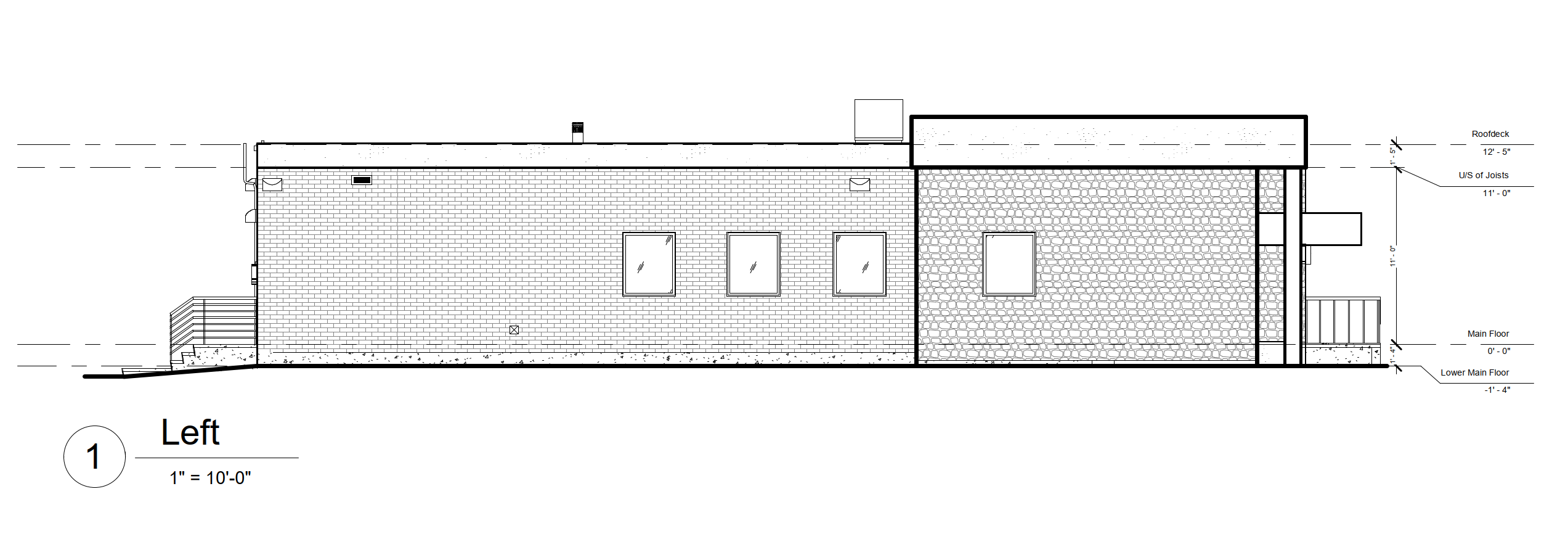

SHCanada2 Posted November 18 Share Posted November 18 (edited) After doing a very time consuming property mostly due to the many rooflines, I went looking again for scanning apps that could help. iGuide now does elevations. I had a session today with one of their people. iGuide has their own camera similar to matteport. the iGuide one is currently on sale for $1800 USD. https://store.goiguide.com/. It also works outside. The interesting thing is the price and time it takes to scan. It is 8 sec per scan. A 2000 sq ft house could then be done in under 30 min plus the exterior. The price for a 2000sq ft house, floor plans and elevations in DWG is $225 CAD (~150USD). No subscription. You also get the visual tour included, so then one does not have to take their own video https://goiguide.com/pricing Seems pretty good. I think one would still have to take laser measurements for crucial areas Has anyone tried iGuide? I'm curious to know how good their elevations are in real life where there is only 8ft between houses with bushes and sheds. They did tell me they have humans doing the elevations and floor plans, and they show both the point cloud(below) and the elevation in the pdf package they give you. It also gives you a (inaccurate) listing of windows and doors. i.e. doors were listed at 6'7, 6'8, 6'9. I don't think i really care except for the door widths as I typically dont specify height for doors. Window guys always come and measure the windows themselves so that does not have to be accurate. Edited November 18 by SHCanada2 Link to comment Share on other sites More sharing options...
