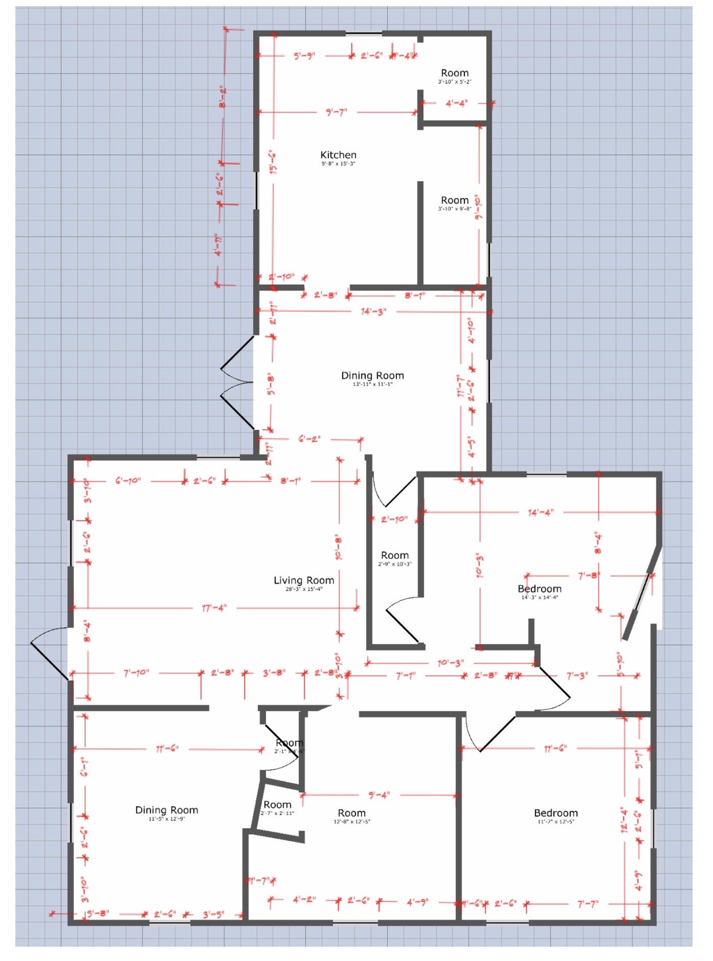

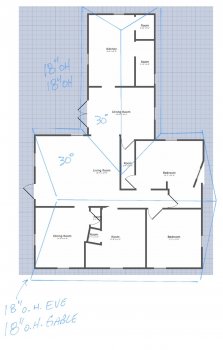

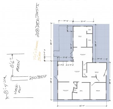

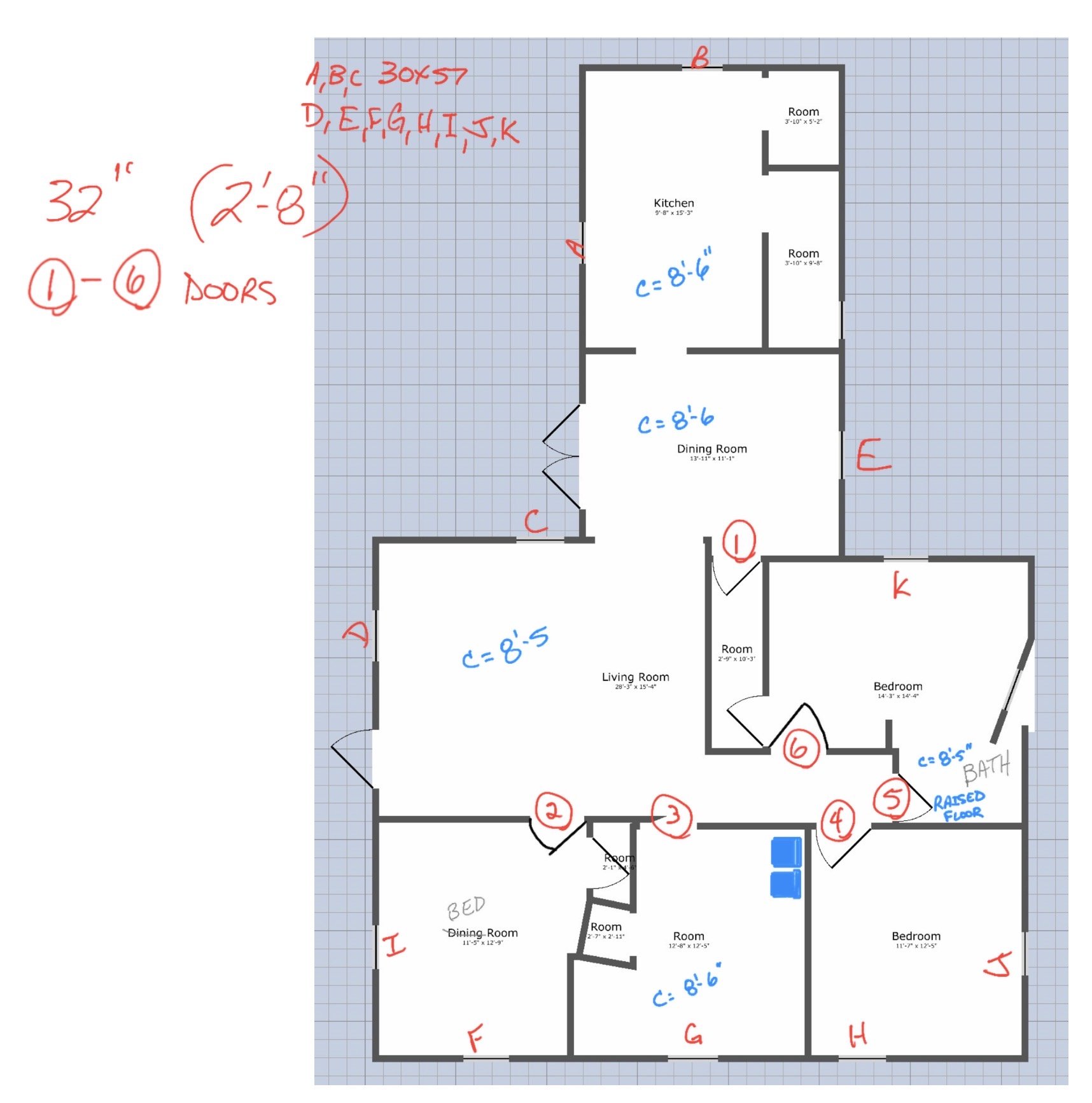

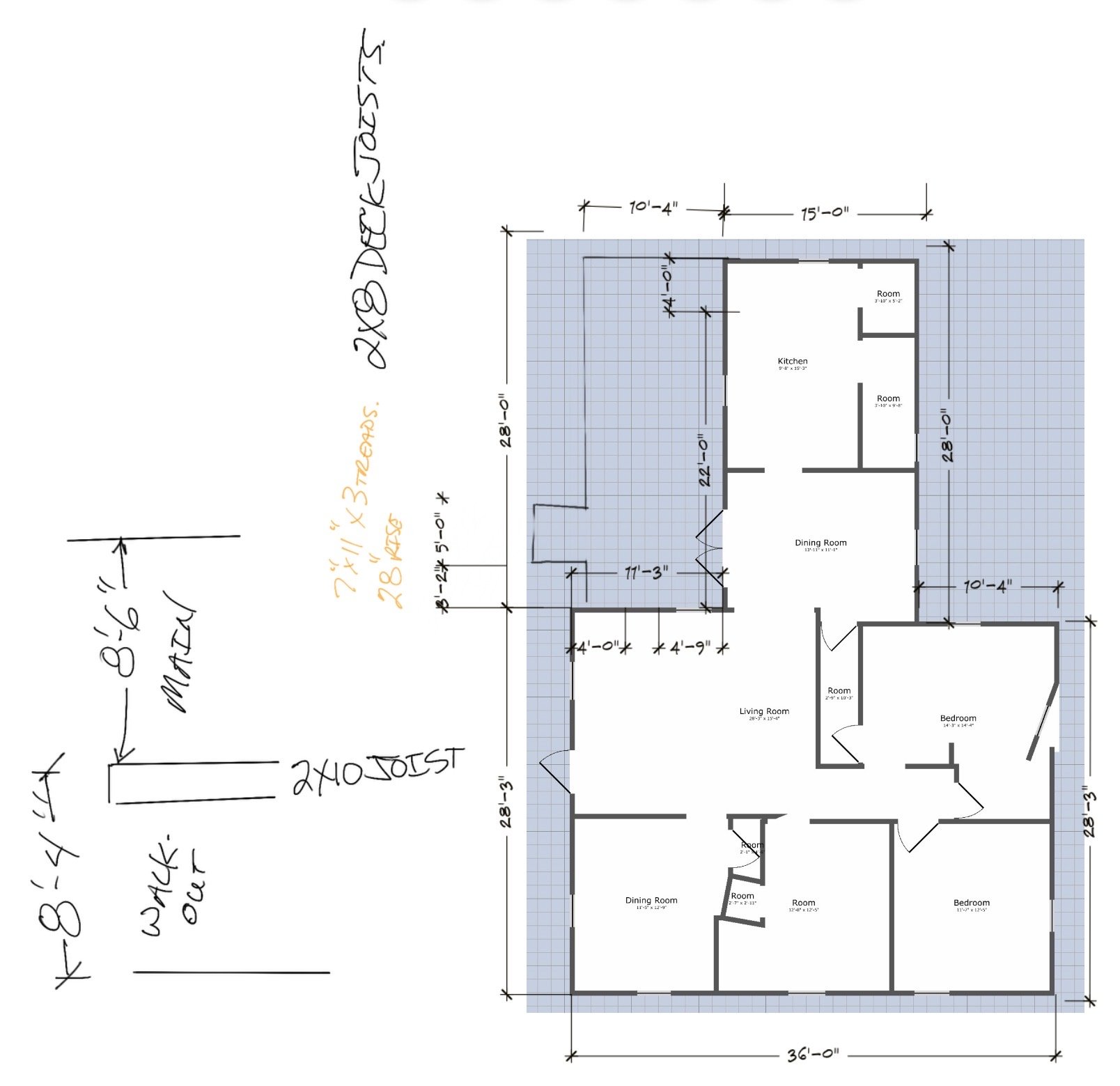

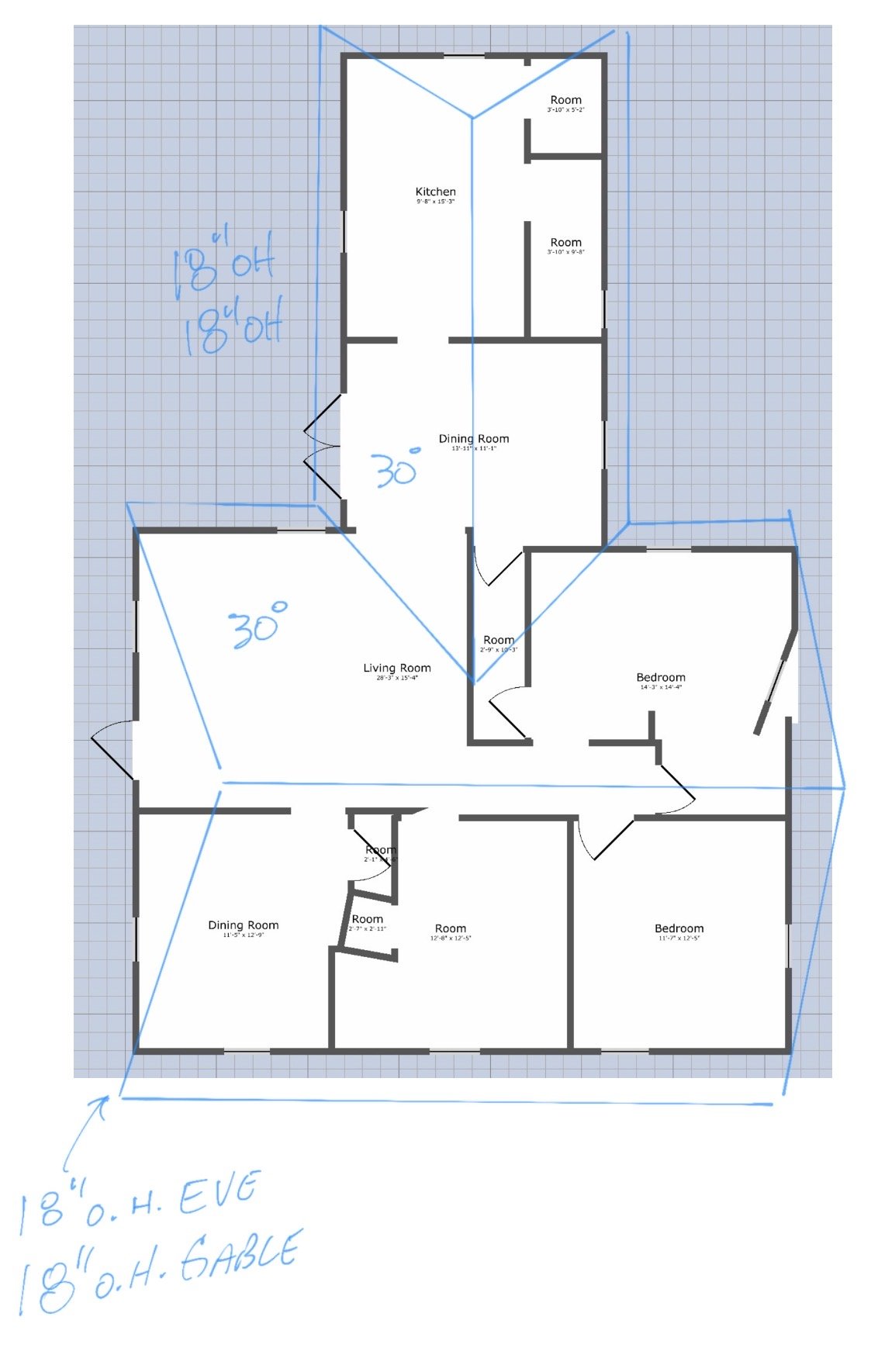

ValleyGuy Posted October 3 Share Posted October 3 On 10/1/2026 at 3:39 PM, SHCanada2 said: that what I found with the CA app, it gets all the walls/rooms layed out, its quite nice. The question then though is what to adjust when you take a couple control measurements with a laser. I tend to get lost in the constantly adjusting walls, and then not remembering which ones I adjusted. At the end of the day, I have to match a survey's exterior dimensions so as to not impact setbacks. I have stopped adjusting walls in the CA As-Built as well due to this issue, and the fact that sometimes the walls come in all wonky (especially in super stuffed closets that can't be measured properly). On 10/1/2026 at 3:39 PM, SHCanada2 said: The best improvement I have had so far, is when a house is sold, it generally has the realtor's floor plans, so I print that out and take laser measurements and write them on the paper....but still, sometimes I miss a window location. This sounds exactly like what I am doing with a CA As-Built screen shot dumped into the Morpholio Trace app. I actually like drawing from scratch in Chief (desktop) using the gathered site info rather than using CAD to walls. So the two apps tag teaming the task at hand have been working well for me. Link to comment Share on other sites More sharing options...

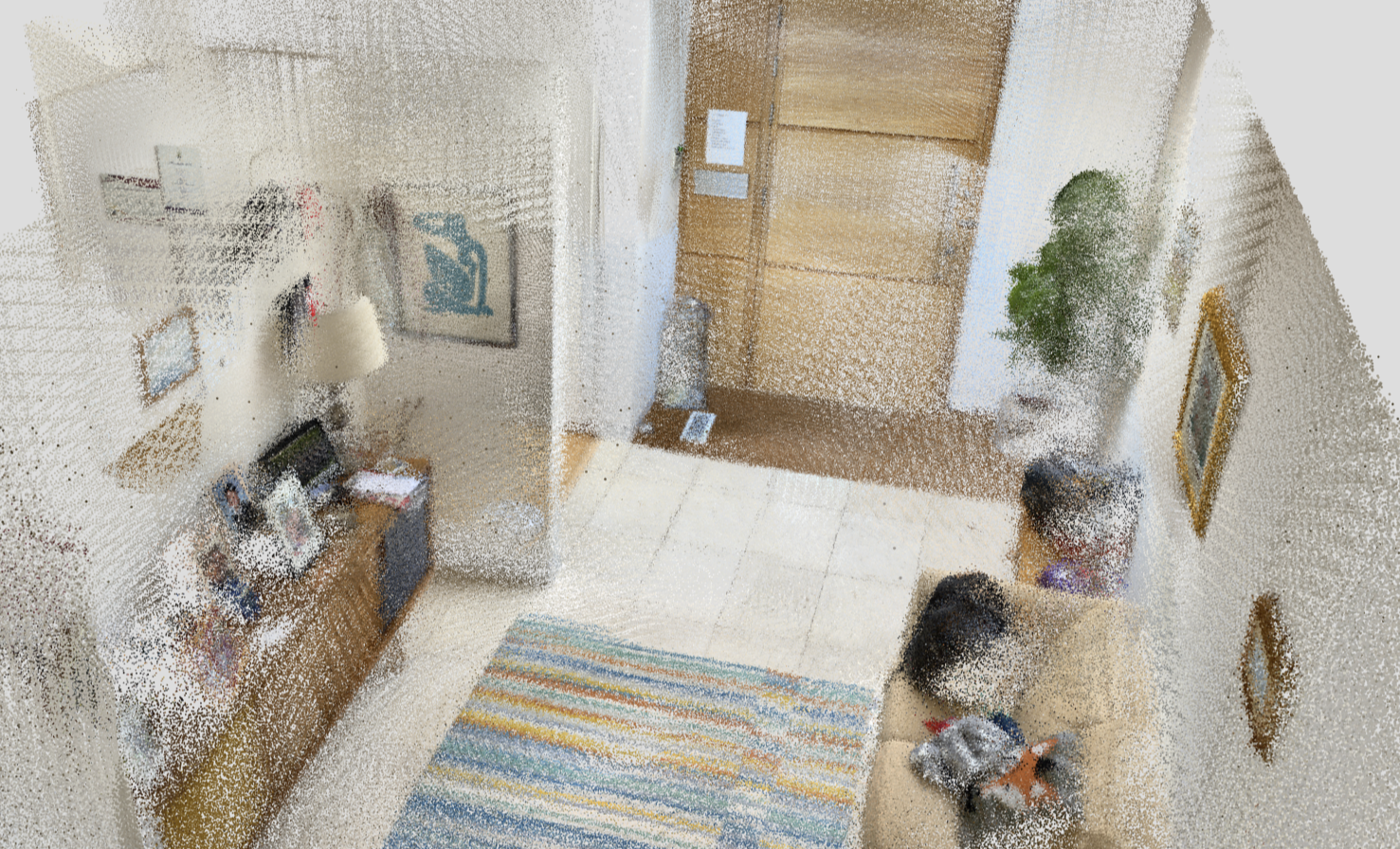

SHCanada2 Posted October 4 Share Posted October 4 5 hours ago, ValleyGuy said: As far as a back up; the logistics involved may be a solution. The Ca app allows the original lidar scan its more for picking up things I missed, and would not be on the CA app, for instance if the stairs are proud of the wall, or if I missed a dropped beam. or even to double check a CA window size. So more like something like this point clouds can be viewed in point cloud viewers and then in that software you can measure between 2 points. It looks like you are capturing the window widths and distance to wall with a laser. CA captures that in the app. Are you capturing that "just in case"? ...this is my conundrum with the app: how much do I still take by laser that it actually captures? door widths, window WXH, location of both of those, plus all the room dimensions? The realtor plans never have the windows/doors, which is why the CA app was promising. Here is perhaps a question for you. If you had the realtor plan ahead of time, would you put that onto your tablet ahead of time, and just jot down measurements on it as you go around with the laser, or would you use the CA app? Link to comment Share on other sites More sharing options...
ValleyGuy Posted October 5 Share Posted October 5 5 hours ago, SHCanada2 said: its more for picking up things I missed, and would not be on the CA app, for instance if the stairs are proud of the wall, or if I missed Ahhh, I see. You are right, that isn’t on the CA app and is needed to be handled at the site or an alternative solution found. 5 hours ago, SHCanada2 said: It looks like you are capturing the window widths and distance to wall with a laser. CA captures that in the app. Are you capturing that "just in case"? ...this is my conundrum with the app: how much do I still take by laser that it actually captures? door widths, window WXH, location of both of those, plus all the room dimensions? I am capturing for a just in case. This particular Reno involves all but three rooms, and the main part of the house is 100 + years old, so trying to centre things is sometimes difficult when some rooms have rough cut studs covered by lath and plaster plus 16” drywall plus regular sheets of drywall - and some have wood boards under the drywall, and others just have regular dimensional studs with drywall. Heck, most of the doors have the jamb and the door stop made from the same piece of wood with the door made to fit, so even some of the doors are ‘averaged’ lol. I’m kind of in a market that needs to take measurements on a house by house basis and I’m pretty sure that there isn’t a mathematical algorithm in any app that would make this hodgepodge interior match the exterior dimensions. 5 hours ago, SHCanada2 said: Here is perhaps a question for you. If you had the realtor plan ahead of time, would you put that onto your tablet ahead of time, and just jot down measurements on it as you go around with the laser, or would you use the CA app? I would probably do a combination because taking the lidar CA app only takes a few minutes. I’m also a little skeptical of using ‘other peoples’ drawings. I’ve had realtor’s plans that were created from the original house blue prints…. to which the house wasn’t built to. I would overlay both the realtor’s plan and the CA lidar scan in the Morpholio Trace app for a comparison, then take the laser measurements for the critical areas - the CA plan would be have the non-crucial area measurements. I’m pretty certain that I couldn’t just rely on ‘Not Measuring’ the critical areas, so I’m comfortable accepting the additional time it takes. Link to comment Share on other sites More sharing options...
