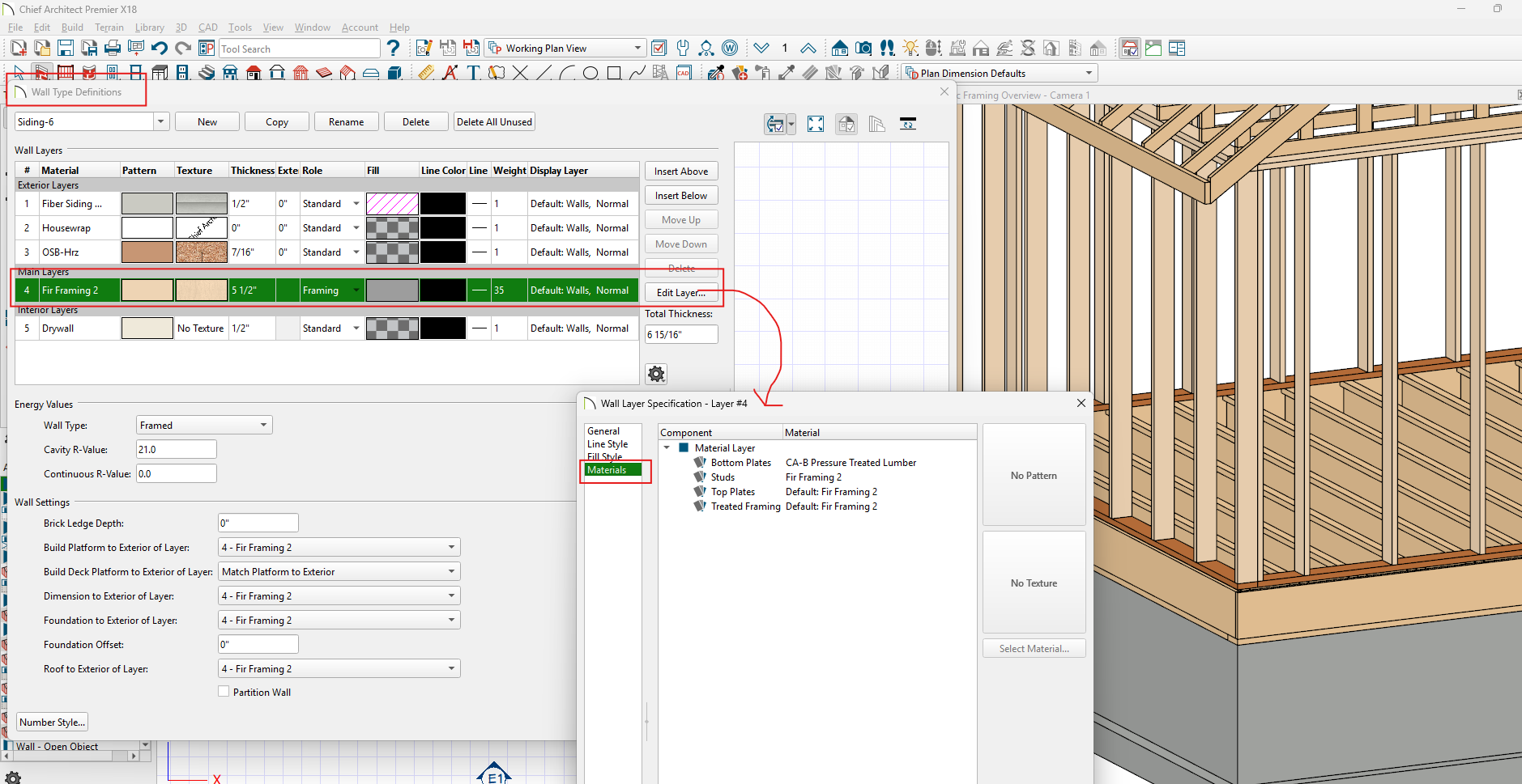

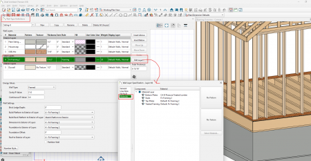

CarrieS Posted 11 hours ago Share Posted 11 hours ago In X18 we have the ability to specify the bottom plate material separately via the wall type. In X13, if you're still on that per your signature, we don't really have an easy way. 1 Link to comment Share on other sites More sharing options...
