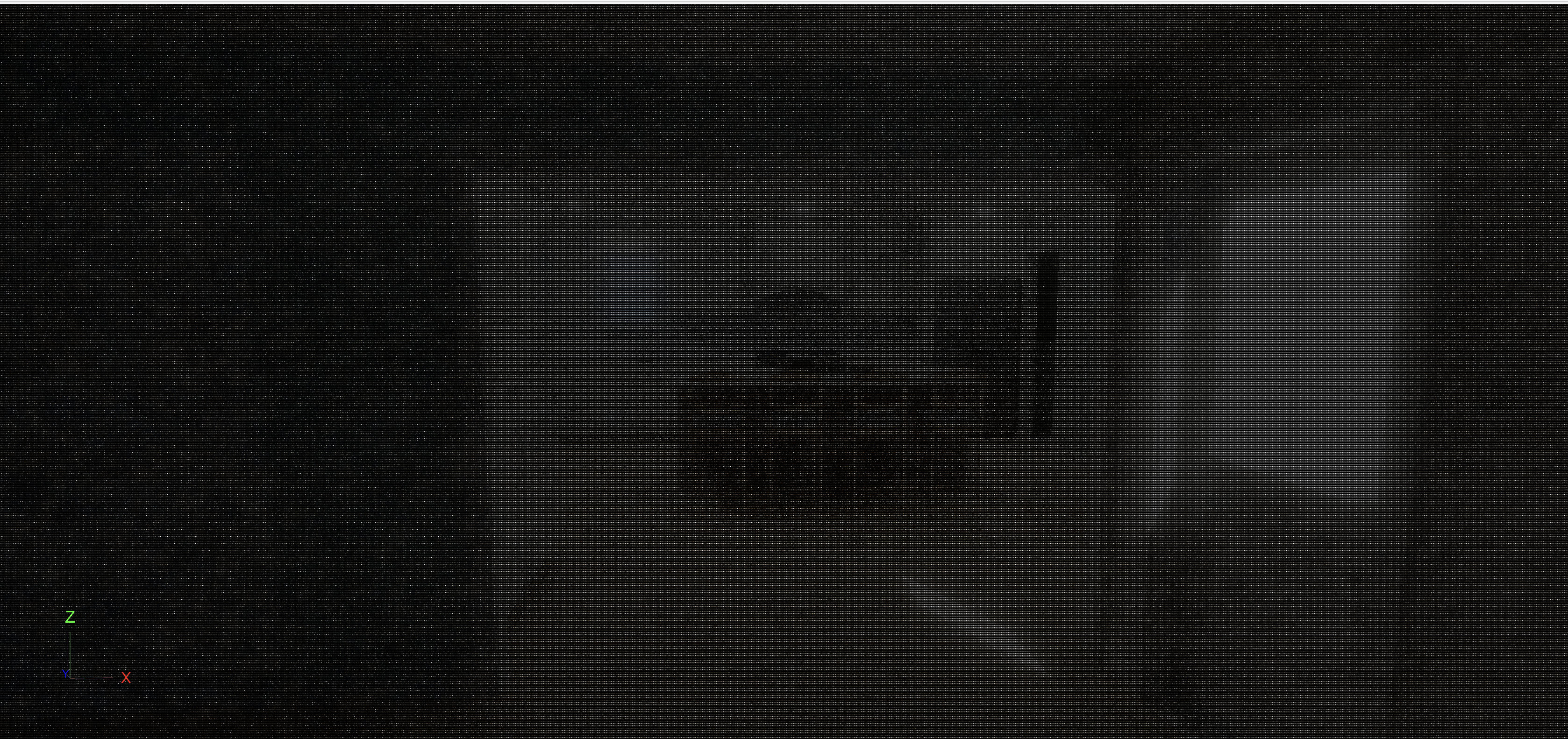

ARDSdesign Posted yesterday at 04:34 PM Share Posted yesterday at 04:34 PM Does anyone know why it wont go passed this? Link to comment Share on other sites More sharing options...

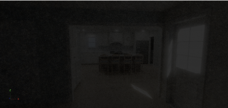

ARDSdesign Posted yesterday at 07:36 PM Author Share Posted yesterday at 07:36 PM I changed it to 300 but now it looks like this Link to comment Share on other sites More sharing options...
JonathanK Posted yesterday at 07:56 PM Share Posted yesterday at 07:56 PM I'm guessing you have something going on with your video card then. Has it always had this issue, or just started? Link to comment Share on other sites More sharing options...

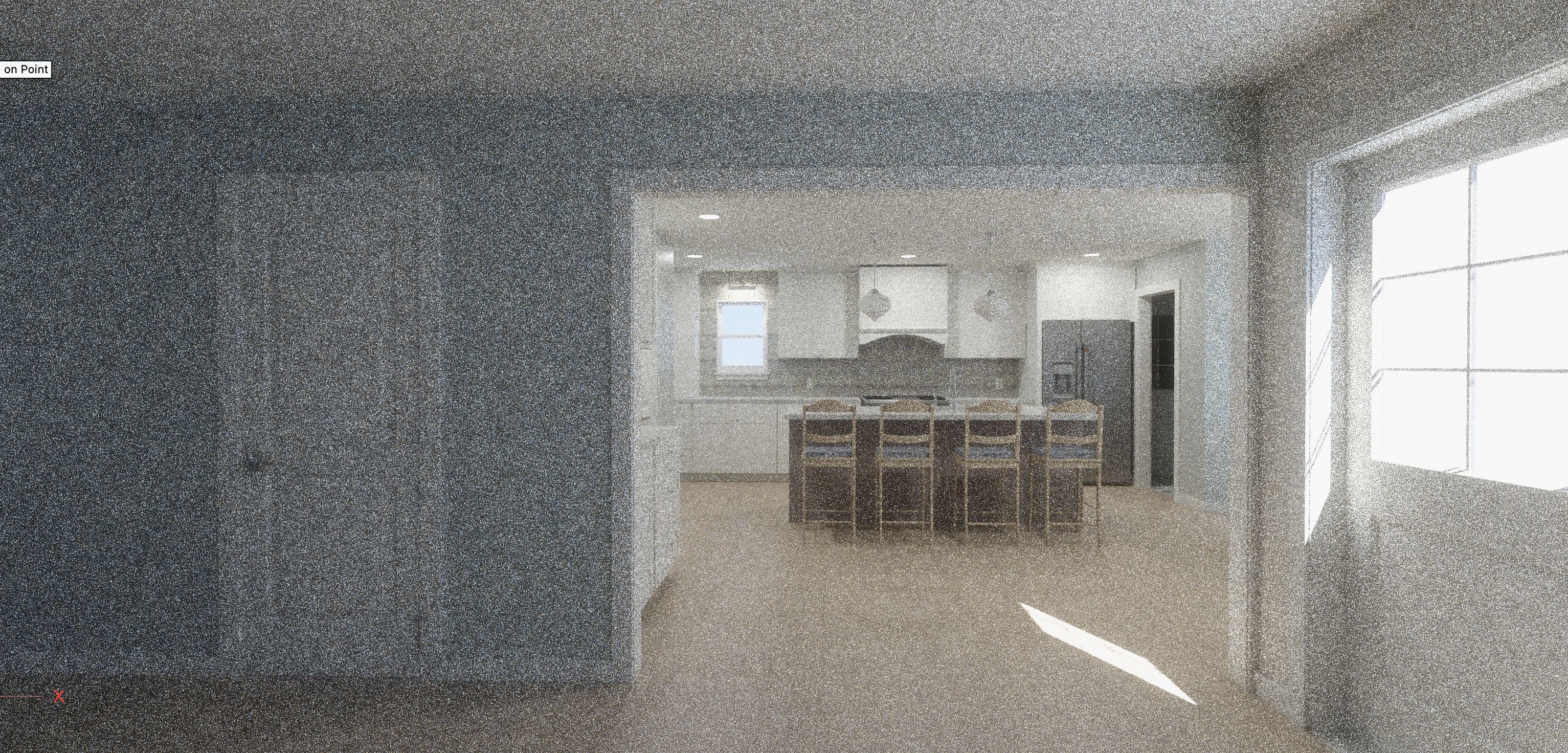

para-CAD Posted yesterday at 08:22 PM Share Posted yesterday at 08:22 PM MacBook Pros from the M4 line and newer can now do a manual denoise. I just found that out and it's pretty amazing. Link to comment Share on other sites More sharing options...
ARDSdesign Posted 23 hours ago Author Share Posted 23 hours ago what is the denoise? how can i do that? its a mac. Link to comment Share on other sites More sharing options...

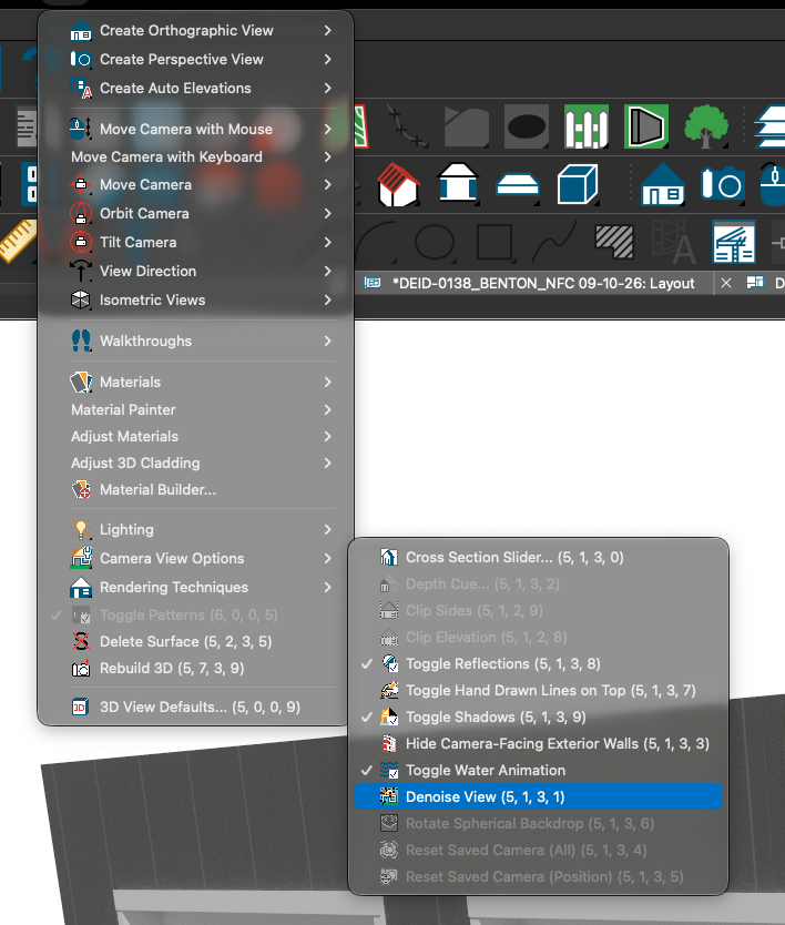

para-CAD Posted 22 hours ago Share Posted 22 hours ago (edited) It’s not automatic like the PBR that is done by the Nvidia graphics cards, so once you get your PBR focused and it ends up that pixelated view, you can go 3D \ Camera View Options and there is a function that says Denoise View . I created a shortcut key to it and then put that in my stream deck, so when I’m rendering and I get to that point, I just push one button and it clears the picture up quite nicely. Give me a few minutes to go track down that information for you. Edited 22 hours ago by para-CAD Link to comment Share on other sites More sharing options...
para-CAD Posted 22 hours ago Share Posted 22 hours ago 3D \ Camera View Options \ Denoise When you choose the PBR rendering technique, then you can have your Mac denoise the pixelated image. Link to comment Share on other sites More sharing options...
